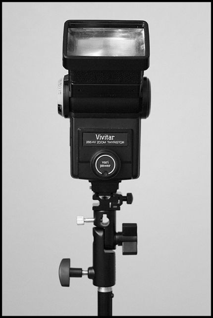

Aaron, if you don't mind using a PC cord between your camera and your flash, send me a PM with your mailing address; I'll send you a Vivitar 285HV flash, a Vivitar PC cord, the rare and hard-to-find remote cord for the Vari-Power module, and a small shoot-through umbrella (part of my NYI student kit that I don't need). All you'll need to do is supply a light stand to mount it all on.

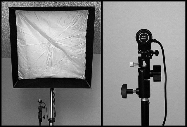

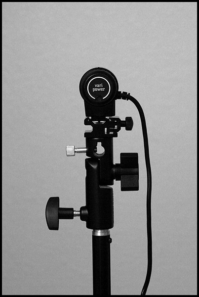

BTW, for any who don't know what it's for, the extension cord for the Vari-Power module allows one to adjust the Manual flash output, or use one of the four Automatic levels, with the flash inside a soft box or facing away from the subject for wall bounce.
It was a brilliant idea in the days before through-the-lens metering.

To Brian: That cable for the vari power adaptor, does it connect to the round removable plug on the flash body? Im looking into this plag for my 2 285HV flash bodies. Thanks!
Mar 27, 2013 at 03:02 PM
BrianO
p.1 #19 · Small umbrella as softbox?
TMGraphics wrote: ...To Brian: That cable for the vari power adaptor, does it connect to the round removable plug on the flash body?
Yes, it does. You pull out the Vari-Power module, plug in the cable, then plug the module into the other end of the cable, which has a cold foot allowing it to mount on the camera's hot shoe.
I haven't seen one of these cables for sale anyplace in a long, long time, and I don't know if they're still available.
