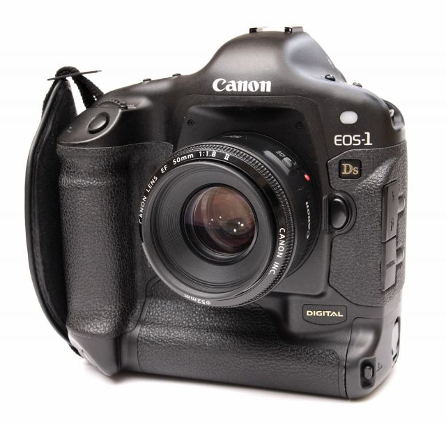

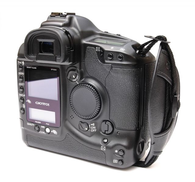

Well, you're right. Just talked with CPS. The 1Ds was put on the end-of-service-list late last year. They won't even clean the sensor. I'm surprised, amazed and perplexed. Canon has previously serviced film cameras up to 20 years old! Not sure what to do. The camera is pristine and has only 22,000 clicks. These are current pictures of my amazing 1Ds:
