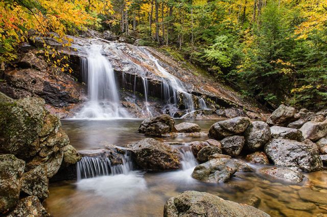

OK, I'm the guy who asked if this was the right forum for evaluating photo processing. Here is my first image for critique. Most of the adjustments were made in ACR. In PS I blended two images primarily to the main waterfall, but also to the others. The purpose of the blend was to try to eliminate the blown out areas of the waterfall. I was almost successful. There was no sharpening at all. I'm open to any and all suggestions. I want to learn.

One thing I notice right off is that this image is more vivid or saturated than the same image in PS. Not sure why

I think you have a good, standard landscape shot there that has decent composition, color, exposure, and sharpness.
About the only minor suggestion that I would have in terms of post-processing is maybe trying a subtle vignette to boost the focus on the waterfall.
As I said, I think the composition is fine here but I kind of wish I could see a little more of the colorful trees. It makes me wonder if there was a possible vertical format shot there of the falls and up into the trees.
Really though I think to get something much more wow than this would take different light or a more impressive waterfall.
Good job. Look forward to seeing more of your work here on FM.
Regarding the difference in saturation, are you using a wide-gamut monitor? If so, you will want to use a fully color-managed browser like Firefox or Safari to match the color as you see in PS. You are also posting in the ProPhoto color space so some people may say the image sort of greenish and low contrast if they're not using a color-manage browser.

One easy technique to blend two images where the water in one its blown-out but the rest is OK and another with good water but darker remainder is to stack the images with the blown image on top. Then use the eraser tool to reveal the darker water below.

OK Eyeball, glad you noticed the prophoto error. I forgot to convert to sRGB when I downsized it for the web. I'm trying to figure out how to upload a revised image, but haven't figured it out yet.
I am using a wide-gamut monitor (dell u2410) and I think I have color managed it correctly. Although there is no telling.....
I like the vignetting idea and as soon as I figure out how to do that..... I will give it a shot.
I tried some other perspectives and when I figure out how to add photos to the post, I will show some more. The left side of the fall was definitely more colorful, with some reds and whatnot, but I liked the "line" of the two falls that kind of faded into infinity towards the upper left of the image.
And I didn't want to cut the rock of the main falls off. For some reason, I felt that all of it needed to be there (same kinda logic for not cutting off arms or legs on a person...). And I could not back up any more - the next step back was about a 5 foot drop and then I would not have been able to see the plunge pool, etc. I wish I had a wider lens with me that day....
But as far as processing, it looks ok? Are you saying I could possibly increase the vibrance more? And do I need to sharpen it any? Especially if I was going to print it?

To a replace an image, click on the edit button, mark the current image to delete and select the new version to upload.
Here's a video that includes how to do arbitrary shaped vignettes:
What browser are you using?
If you're using ACR, you can use the post-crop vignetting on the effects tab. I would suggest keeping it subtle.
Processing looks OK to me. You might be able to boost vibrance/saturation a little if you want but the yellows and oranges will probably start clipping if you need to convert to sRGB. Sharpening looks OK to me for display here. For printing, you can probably sharpen quite a bit more, particularly if printing on an inkjet.

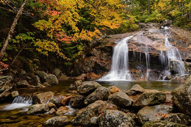

I've added a revise photo of the above in sRGB (rather than Pro Photo. I've also added another shot of the same location but from a different perspective showing more of the left side of the falls. Note that I had to cut off the large rock and the falls do not "line up" as in the first image. I like the second for the colors, but the first for the composition. Would like to hear your thoughts.

Regarding the last image you posted, I agree with you. It has nicer color but the slant of the rock shelf of the waterfall does tend to run my eye out of the frame. Still, like your first image, it is not a bad image at all.

As to the pics ... both are looking good on my end (Firefox). I'm leaning toward a preference to the second one.
Compositionally, the tonal values of the water take me from the large falls into the frame and then past the foliage colors to the smaller falls at the edge of the frame. While that might be "at risk" of taking me out of the frame ... the weighting of the (foreshortened) foreground rocks pulls me back over, and then the tonal value & weighting of the larger falls brings me back up ... thus I get to take my trip around the scene and never leave.
The first has a similar movement, but it seems to be more centralized between the two falls and the rocks so it seems a bit less dynamic. But, then if I do get to the edges with the foreshortened rocks, I get kinda "stuck" and have to "back out" and "look at" the image starting over again. I'm a big fan of foreshortening, but the two rocks at lower left corner and bottom center are neither the focal point, nor serve as leading us to the focal point very much, so the weighting that foreshortening provides isn't doing as much for me in this case.
Also, by 'coming around' on your comp, I think it presents the two falls in better scale relationship to each other. In the first one, the foreshortening effect changes that relationship just a tad by strengthening the smaller one and weakening the larger one ... if that makes any sense.
The first one has an overall brighter tonal value than the second one. Wondering if you might bring up the second one just a tad to give it a lighter feel/mood.
All in all ... they both look good on my end ... wish I was there.
BTW ... curious @ f8 vs. f2.8

And composition question. The second image. Does it bother you at all that the large ledge rock is cut off on the right? 'Cause I am trying to convince myself that I like the second one better also.

Rock cut off @ right ... what rock ... I'm too busy looking at the water, the colors and the foreground rocks.
When you're strong stuff is strong, you're little stuff is small potatoes.
When your strong stuff is weak, your little stuff looms large.
When you've got four aces in your hand, nobody cares if you've got a deuce to go with it ... it's a winning hand with either a deuce or a king tagging along. But if all you've got is a pair of jacks, having a bunch of little cards to go with them doesn't help things much.
