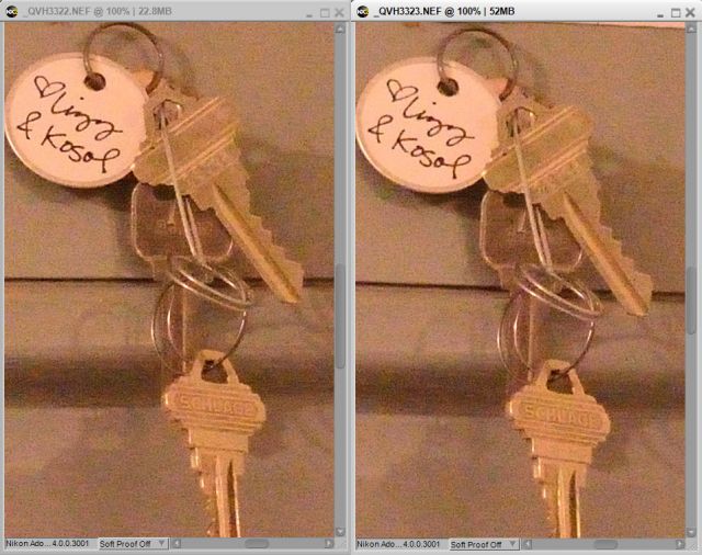

I was comparing shots from my D800e body in DX mode and FX mode. When I zoom in on both pictures the size of the object is the same at 100%. I was thinking that at 100%, a DX shot would show more of the object. Can someone explain to me why they would be the same at 100% view? Sorry maybe a stupid question...

The DX mode is simply a crop of the full size image. 100% will be the same size.

Yup, the DX crop mode simply 'cuts' the perimeter off the image. The max detail you'll see is dependent on the pixel density of the sensor. Since that doesn't change, DX crop mode will show the same detail as an FX shot but be 'missing' all the edges.

So I get a few more fps and smaller file size, but no focal length advantage... got it.

well, "focal length advantage", no. It's just cropping, so you're dealing with a smaller file, getting more fps, like you said.
That's different from comparing a 24mp DX camera and a 24mp FX camera. In that case, you get more pixel density with the DX, giving you that 1.5x advantage. Using an FX sensor in DX mode loses about ~50% of the pixels (if I remember correctly). So 24mp DX vs 24mp FX in DX mode is like comparing 24mp DX and 12mp DX (24mp FX in DX mode).

Thanks Dex. That makes a lot of sense now. DX mode (should be called Crop Mode) on my D800e equals to about 15.4mp I think.
