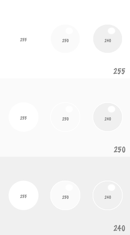

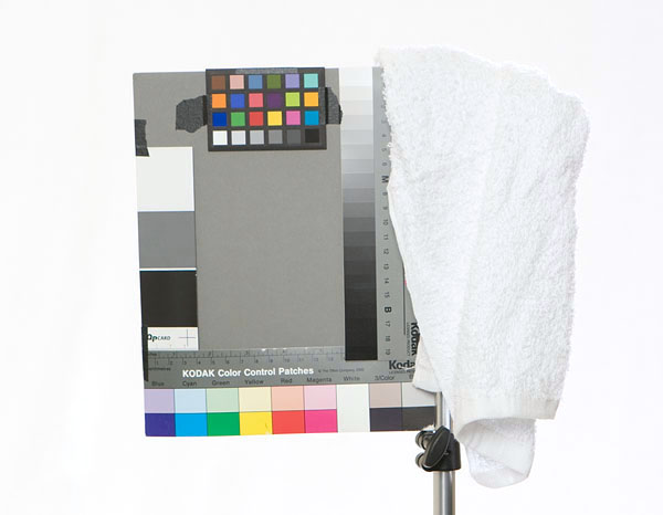

With white backgrounds there I avoid clipping them which makes anything white retaining detail seem darker by comparison. Any white dance costumes will also disappear into background and black ones contrast too much. Clients often realize this until they see the results. Grey is actually better because white and black outfits will both contrast without overpowering the faces, which should be the center of interest that contrast the most with the background. You might do some test shots of white and black outfits on white and grey to convince the client gray is better.
In the shots above I first set the foreground lighting, then raised background so rim lit parts of white towel which are 1/3 stop below clipping to retain detail contrast with the "white" background which is actually around 250, not 255. If the background is 255 in the file you will not see the shape definition the rim light creates:
With a centered key and fill strategy if you have a white background it will wind up an evenly lit tone of light gray if is is about 3-4 feet behind the subject when lights are 8ft from them (inverse - square fall off) as seen in the shot above before I turned on the background light.
