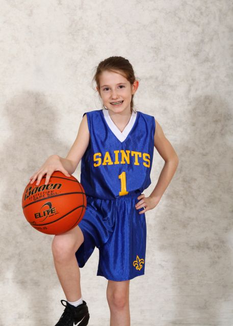

I am have problems with shadows with my set-up using 2 strobes,
Here is my set-up
2-White Lighting 1600 shot through umbrella's about 15ft from drop , lights are 7ft high on both side of drop aimed,
please help with this problem.

There are two problems that I see: crossed shadows on your subject (see her neck), and two shadows on the background.
The cure for the first is to use one key light on your subject, and a weaker fill only if needed. Remember the adage that "there is only one sun."
The cure for the second is to light the background such that the subject isn't casting a shadow on it. Generally, placing two lights out of frame but at or behind the subject line works for this, but if you only have two lights, and need one for the key light, you can place the BG light above the subject and aim it down onto the BG. (Less desireable, IMO, is to have one BG light to one side, but it can work if you don't have a boom or scaffold for the BG light.) The further the subject is from the BG the further away your light can be, allowing a shallower angle that will yield less fall-off from top to bottom or side to side on the BG.
For closeups, you can put a single BG light directly behind the subject, but that won't work for full-body shots becasue you'll be able to see the light and/or the cables, so the BG light(s) must be out of frame.
The point is, though, that you need to light the subject and the BG seperately if you aren't using a black BG.
(Not a lighting issue, but while I'm here... Is that the full image, or just a crop from it? I ask, because you have a lot of empty space above her, but her feet are chopped off. Jsut somethig to watch for.)
The ideal solution to the shadow on the background problem is to eliminate it from view. That requires having enough space for the shadow to fall down on the floor rather than behind where it completes for attention with the subject.
Echoing Brian's advice crossed key and fill isn't a good strategy for portraits because each light cancels out most of the modeling off the other. In the places the two shadows cross you'll also typically see very dark voids in the lighting pattern because little light reached them and they are under-filled. But it your case there appears to be so much uncontrolled "spill fill" bouncing off the ceiling and walls from your umbrellas that's not a problem.
Another way to hide the shadows and get more flattering modeling on the face is to keep the lights centered which will cast any shadows directly behind, mostly out of sight. Rather than cross your key and fill on opposite sides stack them vertically, putting key over the camera where it will hit the eye line at a 45 angle (to get it past the brow and not shade the eyes) and the fill also centered about chin level. See the nostrils in your shot? If you stand on a stool and get the camera higher about 6" above the eye line it will see the top of the nostrils, not the bottom (which is more flattering) and your chin level fill will be just under the lens. Here's an example of what I'm describing:

When setting the lights you first select the f/stop for the DOF you want. Then adjust fill until you see detail in the darkest clothing like the black shoes and the overlapping key until the brightest non-specular white clothing is just at or slightly below clipping in the playback warning. If you shoot RAW the highlights may look a bit underexposed, but keep in mind that when you make JPGs at the end of the RAW capture workflow you'll usually lose some highlight detail and may wind up clipping one or more channels causing a loss of detail, especially in the red channel of skin highlights.
