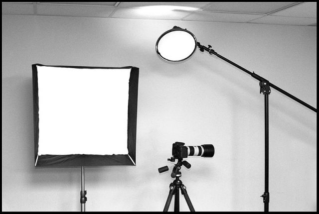

BrianO
p.1 #5 · Lighting stands and booms
shmn wrote:
...I'm curious about what that is at the end of the boom in your photo. Is it a Speedlight with some sort of modifier? Or is it a larger light?
It's a Speedlite firing into an RPS Studio BeautiDish (not beauty dish). I also have a 20-inch BeautiDish, but the one shown is a 12-inch version. It's too small to work as a true beauty dish, but I like using it as an accent light. It comes with a diffuser sock, and there is an optional grid that I bought as well.
They had them at Glazer's, but I don't know if they still do. Here's a link to a source, and another to an old thread I started when I got it.
http://www.adorama.com/RPSBDK12.html
https://www.fredmiranda.com/forum/topic/967727
