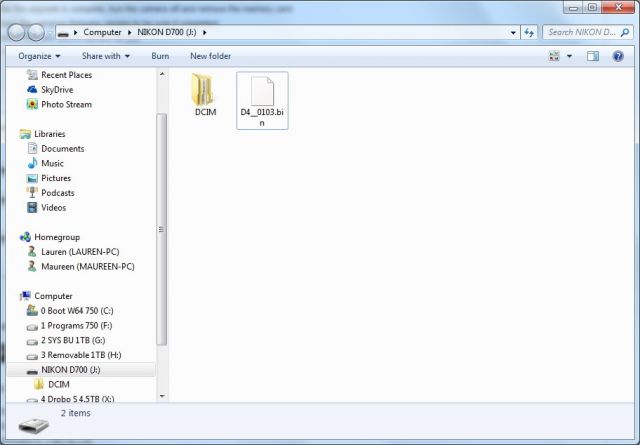

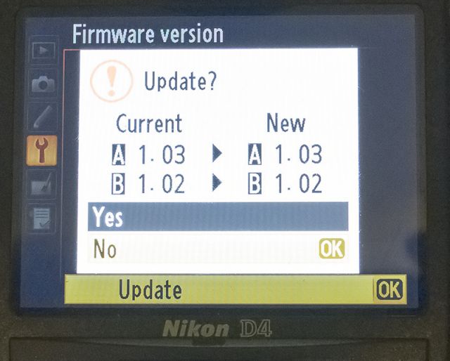

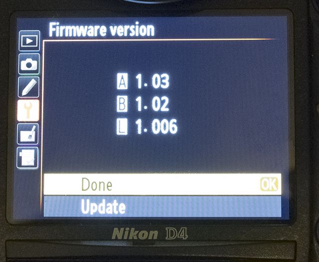

this should help from here. I forgot about the "Update" option. since yours is behind a little it may want to update both A and B. that would be a Yes of course.
image 1
shows what you have onboard and should have the term update available
image 2
will show again what's onboard and what is available on your card(if placed on properly) to update to.
L is another item that can de dealt with separately. it is a database of Nikon lens distortion corrections that can be done in camera that are occasionally updated as new products come out. not important if you don't use it. I have the option off and use an external program for lens correction.

image 1
image 2

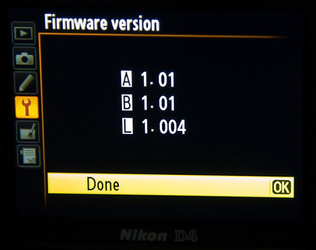

Thank you for trying to help, sjms,
I did every thing by the book but I seemed not able to get the "update" choice.
Here is all I can see, I tried all variations, both and one Memory at a time. All show this:

The download isn't available properly on your card then, or you'd see what's on Steve's menu (image 2)

sjms
p.3 #6 · Nikon D4 DSLR firmware update improves autofocus!
that means the file is either the wrong place or your camera is in the wrong mode.
see: http://support.nikonusa.com/app/answers/detail/a_id/18061/session/L2F2LzEvdGltZS8xMzU0Mzk2NTExL3NpZC9Nb0RvUUdjbA%3D%3D
The firmware cannot be upgraded when Network> Network connection in the Setup menu is set to ON. Be sure to set Network connection to OFF before attempting to upgrade the firmware
if the above issue does not exist then this is how your card can look.
it can be in the card but not in the DCIM folder. it can look like this and will work
Edited on Dec 01, 2012 at 04:22 PM · View previous versions

I saw it .. The downloaded file for sure is is the card. The camera just didn't see it. wonder why!
that is the question.

read the above link about having your camera in network mode the connection must be off.

Done! the third time was the charm. Wonder why, didn't do any thing different nor extra. Any way it is AOK now.
Thanks for all the help.
