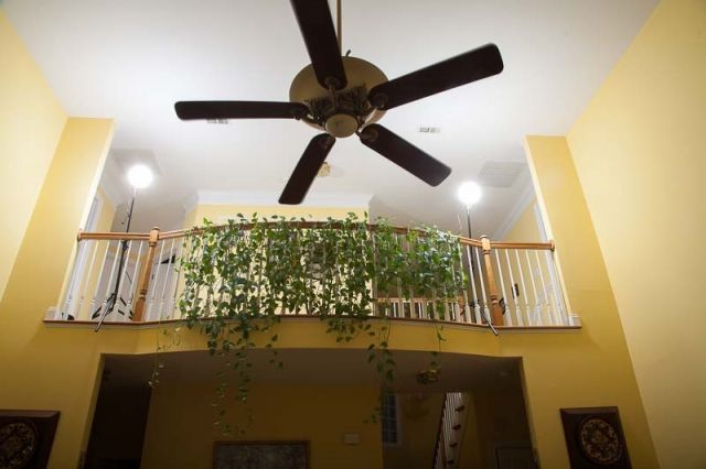

After reading strobist link on DIY profoto globe modifier, here is my try and found very useful and I was able to get f/8 when I mounted the globe on Einstein and placed on my 2ed floor and get even light across.

DIY globe mounted on Einstein and kept on 2ed floor

The globes look like they do their job very well, but why would you use them in a situation like this? There seems to be some decrease in illumination from the bottom of the frame to the top. Wouldn't it have been better to drop the strobes down on the stands, use a flagged plain or narrow angle reflector to avoid light bounce from coloured walls etc, and aim them at the ceiling between the strobes and the subject?

I could not find any other modifier that will give even lighting across 20X20 area other than this globe modifier.
