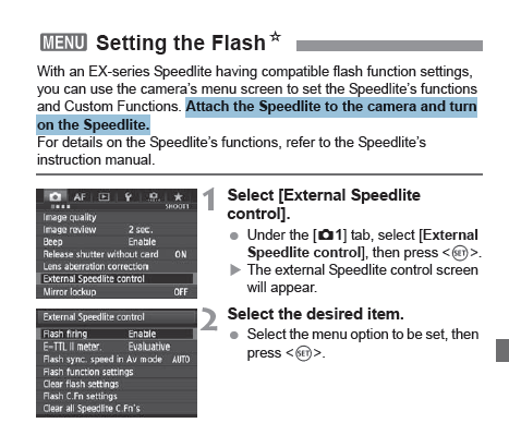

Noticed one thing when the transmitter is in master and my 600 is in slave while in ETTL. If you do an FEC adjustment on the transmitter (or via Q button on camera LCD) it shows the change on the transmitter LCD output level bar. It does not show it on the flash. It works as I tested it from -3 to +3. Put the flash on C and tried the FEC for C in the ratios and it did not show either, but it did work correctly.
When in other modes like M or Gr, any change you make from the transmitter/camera does show on the flash LCD.
I was a little concerned at first but appears to be working correctly. I guess Canon decided it was not necessary to show this info in ETTL. In case anyone notices this as well.
From page 27 - FEC adjustments. I guess this is their explanation.
