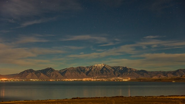

There was a full moon this morning so I drove to the west side of Utah Lake and took a few images illuminated only by moonlight. I stayed for the sunrise so I could work on sunbursts.

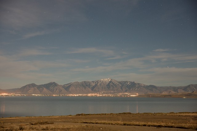

First is east with moon at my back.

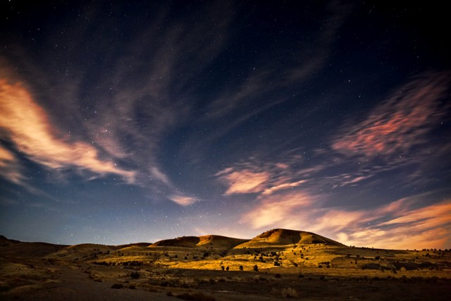

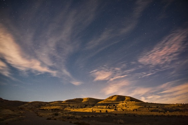

After it set behind a local hill, I saw it was still illuminating a western slope so I grabbed this one.

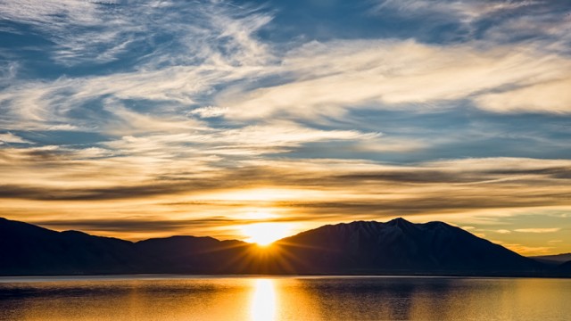

I waited for the sun and got the last sunburst. There was some pretty color prior to this but I think the burst trumps the color.
Very nice Kent. I especially like the darker sky. The cloud color add drama, but seem incongruent with stars. I know, so does a blue sky and light hills.
It was bright though, my tripod cast a shadow.
Question for you, I know Karen speaks of gamma a lot, probably when using the exposure layer. I typically darken with a layer set to multiply and use a gradient mask or brush. This looks like you worked on the sky and clouds separately. I need to learn such things.
+1 @ some seeming incongruity, but I wanted to see if I could accentuate the stars some. It might need some editing of the stars in the brighter / cloud areas, to improve on "plausible realism".
Multiply and overlay, exposure, levels with gradient mask & blend were my "weapons of choice" ... for this one.

For the sunburst I have brackets and have blended them and can even get some detail on the mountain, but it looks better in sillohette. Leaving the mountain dark accentuates the star.
I don't have many (perhaps any) flare free sunbursts, so this is a first for me. I guess my Mesa Arch had one, but it was tiny.
Kent, your processing has made an artistic image, sort of like the wheatfield. I have more that might be interesting for such a project.

Here is one taken at 14mm and processed in Kents direction. I found that by selecting the sky, including the clouds and stars, that I could darken it considerably without losing the stars. I also found that I could desat and darken blue in the hue saturation box so some extent.
This has a lot of color noise in the foreground but its basically an attempt at processing.
Diggin' it ... plausible (twilightish) in my book, and more natural looking than mine. Now to see it with a Milky Way ... extrapolating concept to application.

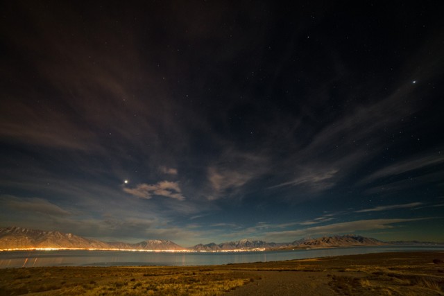

Thanks for the inspiration. Here is another I did. This is over the lake and with the 14 again. The lens must be pointed up for sky shots and the distortion is horrible. The lake shore grew a mustache.
I have a better lens coming and next time I will get down to the edge of the lake.
Interesting shots there Ben ... I especially like the sunburst shot, which has your characteristic warmness.
Although I think that there are better sections of the Wasatch mountains to shoot than that section shown in the first image, and I would crop out the foreground land.
Here's an example that I've shown before that I think makes a better composition (although I am not fond of the overly blue processing). If I ever get back to Utah I'm going to try for a night-time shot of Utah Lake from that angle.
