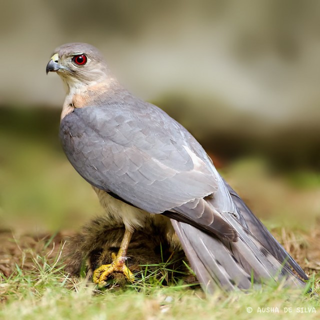

Back to the original image:
Excellent capture. Great detail, excellent eye contact. Saturation/sharpness of the eye are working well. BG is busy but doesnt bother me That much. I would clone out the blades of grass crossing into the lighter, tan tones behind as a minor cleanup. If you chose to simplify the BG I agree lens blurring selectively is a good way to go. In terms of degree of blurring, I would opt for an effect somewhere between Ben's first effort and the original. I think the position in the frame is just fine and Kent's crop is a bit too tight on the left for my eyes.

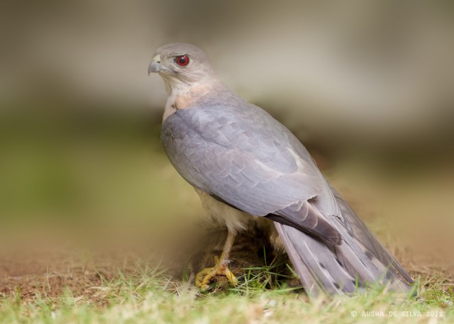

This one has Karens suggestion of using lens blur plus Sadjas of darkening the background. I also use a gradient mask for blur transition and erased some parts for a smoother transition. I also applied Topaz pop to the bird.
This is a nice image, I would love to have one like it. I can imagine what could be done with a raw file.
lens blur darken background
Oct 24, 2012 at 07:51 PM

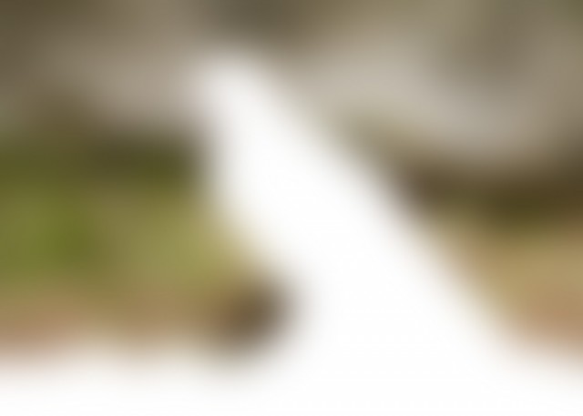

I used lens blur. I tried a more complex mask job today using your tips. I find I have to have two masks, one of the sharp subject and an inverse. I think I saw you do some sort of selection on the birds head but was not sure what.
I may post my subject with the results if you think it would be worth it. I was able to avoid halos but only by keeping a sharp subject mask for the end and by being very careful on the inverse layer around the transition. I blurred in several stages as I moved away from the subject.
Even so, I have a small white band around the subject. Maybe 2 pixels. I used 0.9 rad for refine edge.
Oct 25, 2012 at 01:55 PM
AuntiPode
p.2 #8 · Shikra with prey - help please
If you used lens blur and still had a halo problem, that's a selection issue. One of the purposes of the video was to show a way to get a clean edge selection in the area of the bird's head, leaving a sharp border without a halo, whilst using a blurred and feathered edge in the junction where the blur added meets existing blur to avoid an obvious line. If watch the refine edge panel in the video, it should show the radius for the head selection as 0.0 pixels, although I suspect the video recording and playback probably blurs it too much to read. The head and neck were selected with zero radius so there would not be a halo. The selection mask was built in parts so the background edge would be soft and feathered and the edge around the bird's head would be sharp and edge effects, especially if more sharpening was added, for example when converting to print large, would sharpen well.
Oct 25, 2012 at 02:48 PM
ben egbert
p.2 #9 · Shikra with prey - help please
AuntiPode wrote:
If you watch the refine edge panel in the video, it should show the radius for the head selection as 0.0 pixels, although I suspect the video recording and playback probably blurs it too much to read. The head and neck were selected with zero radius so there would not be a halo. The selection mask was built in parts so the background edge would be soft and feathered and the edge around the bird's head would be sharp and edge effects, especially if more sharpening was added, for example when converting to print large, would sharpen well.
Yep, I can get the bird head halo free. The halo is on the blurred layer, when it blurs it carrys part of the bird colors and detail around the bird. If you erase this the erase shows even with a low amount and feathered.
If I first make an inverse mask it works better because there is no bird info to get blurred (hope that makes sense). But it probably attempts to include some of the white area where the bird is missing.
Next time I will use 0 during refine edge.
Oct 25, 2012 at 02:55 PM

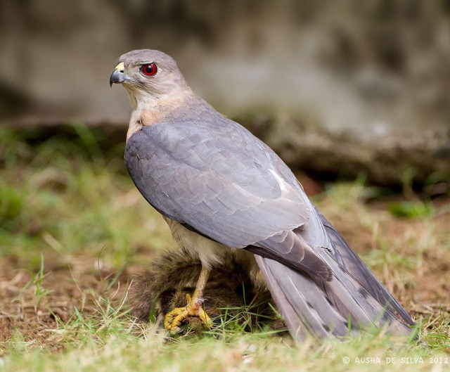

AuntiPode, that version looks great!
i really need to step my PS game up past cropping and resizing
