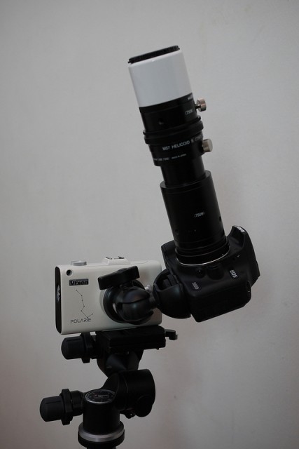

I have the need for a quality, light weight ballhead to stick on my Vixen Polarie star tracker.
The weight limit on the Vixen is 4-5 pounds.
This past weekend I was using a chinese knockoff which had worked well before, but early in the morning this past weekend when cold and substantial dew set in, I seemed to have some small but significant sag even after routine tightening. The ballhead base was at a 45 degree angle as well. This caused multiple extra adjustments to find my target and eventually my polar tracking went out.
What I am looking for -
weight: ~ 1 pound or less
load: canon 5dII and at most a 70-200 mm f4 capacity, usually 14mm samyang. The ballhead may stick out level to ground, straight up, basically any angle.
height: ~ 3.5 inches or greater (camera body can bump up against vixen polarie at extreme angles)
No sag or drift at weird angles.
Initial thoughts -
I have an AS monoball B1, but it is too heavy for the Vixen.
I then wanted the BH40, but it seems short and I worried about the ballhead locking lever torquing the vixen.
Excited about the Markins Q10 for the height, but then people complained about the pan knob and sagging.
Don't mind the price, need something that locks and sticks.

RRS BH-30 or Induro BHL-2? If price is no concern, go with the RRS. Neither of these are really very tall though.
Kirk makes some nice ball heads as well, their BH-2 is tall but weighs more than the above 2.
Oct 15, 2012 at 09:30 AM
dcains
p.1 #3 · Ballhead advice
The Markins heads are all top-notch, and smooth as silk. Absolutely no sagging or slipping, ever, unless the movement is happening someplace else in the system. The panning lock is a weakness, but only with long heavy lenses, and would not likely occur with your 70-200/4.
As for the RRS BH-40, the locking lever can be pulled out (it's spring loaded), and the knob can be set to any one of 6 positions very easily. The RRS heads need a bit of break-in to be as smooth as the Markins, but will also never slip, and the pan lock is very solid.
Based on your need for a taller profile, it sounds like a Markins is the way to go.

the lower the ballhead the less torque overall. you will note that even on the vixen website they use low profile heads

I have a little manfrotto style head, just a bit weak.
they don't show in the photo when the camera body bumps up against it at certain angles.
Guess I could try the BH40 and put it through the angles inside my home to see. It is much harder in the dark!

How much force is required for the BH40 ballhead lever?
If I have to push it around a lot, then I may go out of polar alignment.
think the turn knob is probably less prone to errors.

not much at all. i use it with a D4 and 70-200/2.8. it reqs the least amount of force of all of them to lock it up. i also own an older Q10 markins. in "pushing" it around you may move more then you think like the whole tripod assy depending on what you have. there's lots of mechanical linkage going on in a tripod assy.

Agreed - the RRS takes a very small amount of effort to lock the ball, and has a separate drag adjustment which is very precise.

Looking at the vixen tiny heads at <=3" height, I think I can use the BH30 as previously mentioned. I can still use it for everything else when out in the daytime too.
I'll have to fiddle with the angles and be sure to have an L bracket for my other camera (astro rebel) for those hard to reach angles where I might hit up against the polarie.

I received my BH30. Chose this since it was about same height as the BH40. I worked through some angles and it should work fine. For some extreme east or west objects I needed to slide the 5D off center on the L bracket but seems sturdy. Vertical orientation on L bracket is on option but with a pro body and heavy lens, it may be too heavy a lever arm. I can point below south and clear this as well. I plan to take my AS B1 as well which is quite heavy, but gives me height and I suspect could be used with reasonable gear weight.
