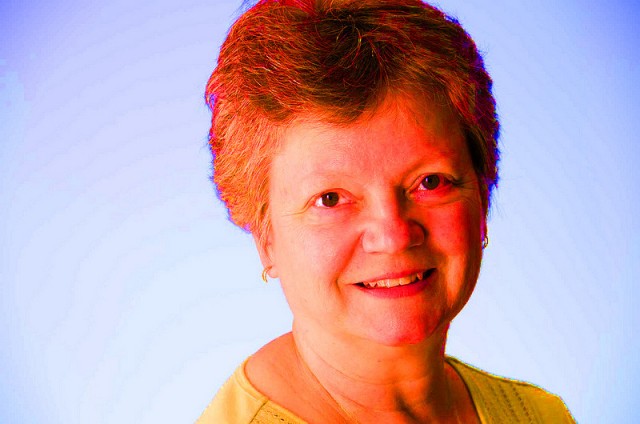

Also, no one has explained to me the issues that are apparent from doing the saturation tests that several have done on my photos. I'd like to know what that shows other that shadow on the face. There are some red tints here and there, but that's what this face looks like IRL. So, I'm still trying to understand why it is important to change something based on turning the sat up to 100% to be able to see it. If you can't see it with the human eye, why is it important? I'm not doubting, just questioning to understand better. Thanks! B

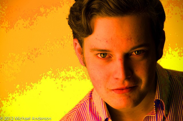

The +100 saturation is just used to help find the cast and the temp's that are in play that need correcting for to get to neutral. Correct in PP and go on your merry way. That should be the end of the story.
However, when we have a situation that is problematic to correct, then I start asking why is it being so difficult to correct, ... i.e. what gives, something isn't right here, why do I still see a cast (at normal saturation levels) even after I've made some corrections, what did I miss (and why)?
Sure, you can dial down the saturation for the offending cast and that has its place. B&W is the extreme example of how saturation reduction can mitigate color (although a cast can still show up there in tonal value impact) ... but for me, that isn't correcting, that is throwing away some of the good stuff unnecessarily.

I cranked the saturation to 100% (not posting it) and while the BG wasn't a pure white, it was WAY, WAY better than the previous things we were seeing. It was a touch cyan/blue (likely the subtle diff @ 6250 vs. 6500) in some areas. Which takes us to your point at detectability. Now, the ability to detect casts or gaps isn't jumping out at us screaming "unprofessional" the way the others were ... AND ... they are much more easily corrected for. While the 82 CRI isn't "the best money can buy", the move to 6500 seems to be working significantly better.
