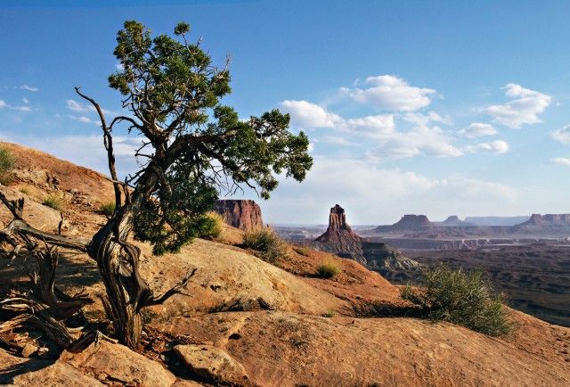

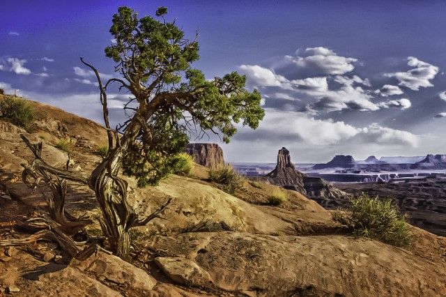

I found a set of three images from a Canyonlands National Park trip (a tree on the trail heading back from False Kiva), and decide to try my hand at merging the exposures.
I'm looking for an image that has good exposure of the background and foreground, but also has a little 'pop' to stand out. I'm going to show the original image at 0 EV, then a tweaked version of that image to lighten some shadow, then the HDR version of the three images (at -1, 0, and +1 EV).
I should point out that I am HDR n00b, and I'm using the trial version of Nik Software HDR Efex Pro 2. I've never had success with Photomatix or the HDR tool in Photoshop CS6 (with both tools I get excessive noise in lighter areas).
The purpose here is to see if I can process a single exposure well enough, or if HDR may be a better option.
Here's the original image, straight-out-of-camera at 0 EV:
I don't think any image is a keeper, since the composition is wrong IMHO. I should have moved so that the buttes in the background are to the right rather than in the centre. But I was walking up the hill and stopped to rest, and that is when I noticed the tree and fired off three quick shots before catching up to the family who were way ahead of me.
Personally I like the processed non-HDR image, if not the execution. By removing the shadows on the tree I have lightened the sky too much. I prefer the contrast between the rock and darker sky in the HDR image.
But the HDR image is lacking as well. It looks over-saturated, and there are halos around the top of the tree.
However, this is my first serious attempt at HDR, so maybe I'm doing it wrong and there are some tweaks that can be performed. Or maybe there are tweaks to processing the original image that can produce a better result.

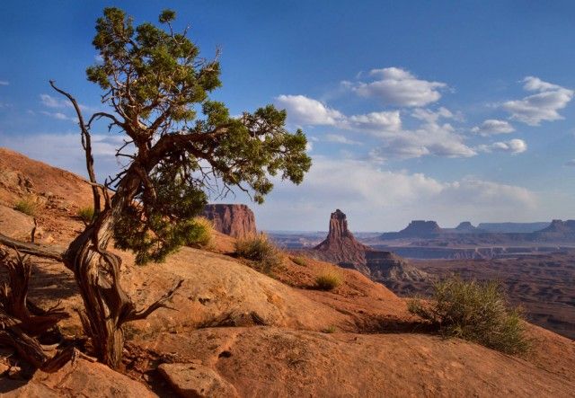

p.1 #5 · To HDR or not HDR this Canyonlands image?
Here is my processing, exactly as I describe on my page. I opened in ACR6 and used +35 exp, 10 contrast, 61 blacks, 20-20-20 on sat clarity and vibrance.
I used the points marked for black and white point and added a gentle S curve.
Edit, the marks do not carry. I used a cloud for white and a dark section in the tree root for Black. Using the black set at 5,5,5 and white at 250,250,250.
I would probably jazz it up withTopaz Pop. I can do that if you want to see the result. But this certainly does not need HDR.

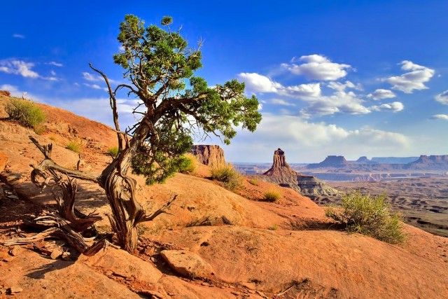

p.1 #10 · To HDR or not HDR this Canyonlands image?

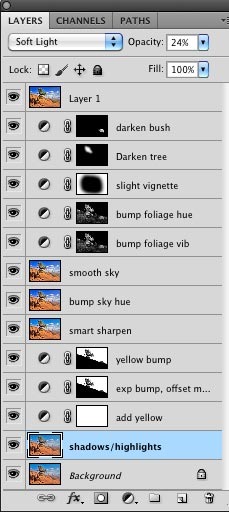

Newhaven, I'm just starting to get into Luminosity masks, could you go into more detail on how you used it ?
I'm still working on trying to get the selections into my images, sometimes I wind up just adjusting the whole image, even though I have already chosen a selection, and copied and pasted it into a new layer. Could you show a screenshot of what it looks like in the layer area ?
I like the luminosity one the best so far. I also think you could do a very mild HDR, and then adjust your levels afterwards, to get the punch back. Good thread !
p.1 #11 · To HDR or not HDR this Canyonlands image?
Sure. The background copy is the original, and the ev +1 layer with the mask is a brighter version adjusted for the shadows. I also attached a curves adjustment layer to fine tune the brightness of layer ev +1. The mask, according to Tony Kuper's naming convention, is Shadow Darks. The basic luminosity mask is created with a ctrl-click on the RGB channel. This will load the selection. Then go to Layer> Layer Mask> Reveal Selection to create a mask from the marching ants. The Darks mask is just the inverse of the basic luminosity mask. You probably will want to visit www.tonykuyper.com to find out how to create the other masks. Hope this helps. I also blurred the mask with gaussian blur. http://img.photobucket.com/albums/v732/glenngaryglenross/redrocklayers_web1.jpg

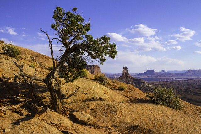

p.1 #13 · To HDR or not HDR this Canyonlands image?
HDR? NO!!
PLEASE don't inflict HDR on your poor image!
Given the somewhat flat lightning, I'm not sure that extensive PP is ever going to make this image 'pop.' The HDR attempts look IMO! awful.
A slight crop to eliminate that distracting rock and branch, light curve tweaking and a blue-sky boost gave me this. Maybe more rock massage would help, I quite like Rusty's rocks.
