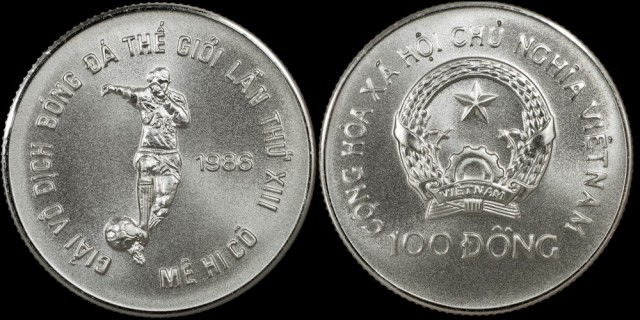

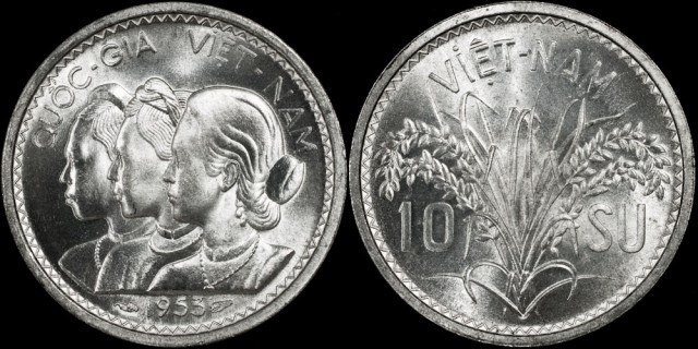

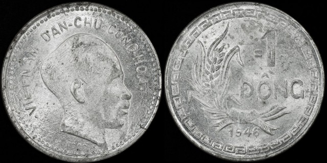

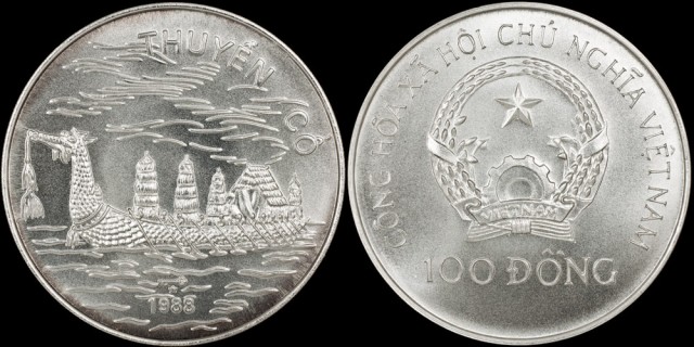

Aside from photography, one of my hobbies is collecting coins and bank notes from Vietnam (along with Laos, Cambodia & French Indochina). I would like to start meshing these two hobbies! I would like to get a setup and procedure for getting good high quality photos for cataloging my collection.
For a few reasons, many will be getting slabbed and I would like to get the pictures before they are forever encased in a plastic holder, to help assist me in estimating coin grades of raw coins after seeing what they graded as (many of the older coins are very crudely/primitively struck and can grade higher than what people would expect who are used to US coinage for ex.), and to possibly use for a future website focused on Vietnam coinage information, varieties and high quality photos.
All photo’s below are shot in the same manor with the same setup. A 5DII with a 150mm f/2.8 Sigma Macro, (2) diffused 430 EXII flashes from the top and with a 4 sided white poster board box around the coin that is sitting on a matt black plastic background.
I think this works for some and not for others. The biggest problem coins will be the many newer proof coins that I have in my collection, coins with mirror like fields. This method just turns the backgrounds black and I’m thinking that these coins might need to be shot on angles and/or with the lighting at an angle?
After using the flashing, I’m thinking that maybe a source of continuous lighting will be better? Perhaps there are some ‘table top’ setups that would work better for this kind of photography?
I’m wondering what you think of the quick pictures that I did take already and idea’s on what I could/should do? I would like to also come up with a setup and method that is easy to repeat and keep consistent, which I don’t think I really have right now. Of course I will have to practice and play around some, this was just a quick first try. I’m now out of town working for several weeks so I’m going over the pictures and thinking about it.
Each coin was photographed twice, front & back, then combined in photoshop.

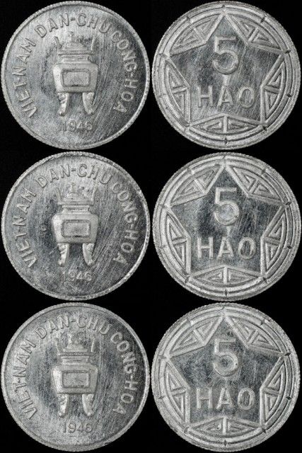

(3) Vietnam 1946 5 hao KM2.2 Coins - (6) Shots Combined

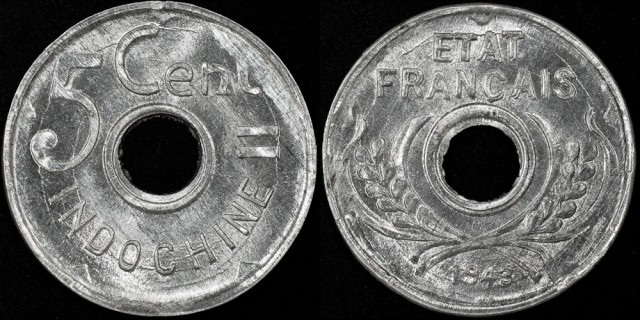

1943 5 Cent French Indochina Rotated Die
Vietnam 1946 1 Dong Aluminum

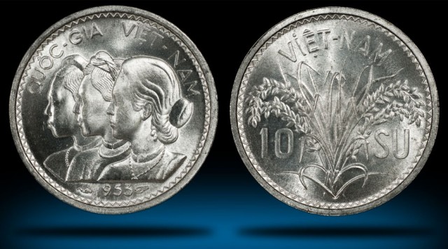

Vietnam 1953 10 Su

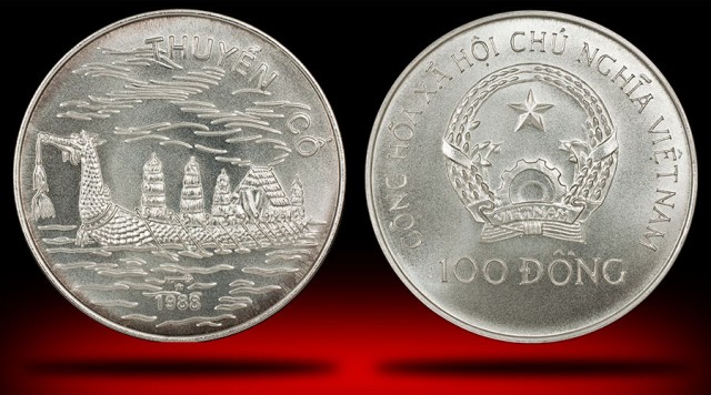

Vietnam 1988 Silver 100 Dong Dragon Ship
Vietnam 1986 Silver 100 Dong Soccer

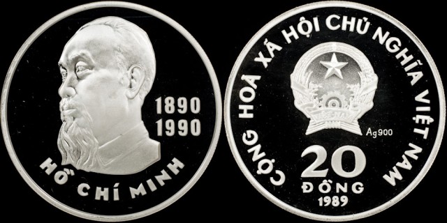

Vietnam 1989 Silver 20 Dong PROOF mirror finish fields

Can't help with the setup but suspect there are a few guides on the net.
Can only say the shots look very good to me but perhaps with too many highlights though. Guessing lower flash angles would help with that.
Brian v.
Sep 17, 2012 at 01:45 AM
SteveF
p.1 #4 · Coin Photography – C&C, setup, options, ideas?
These look good.
I agree that softer light with less highlights might help.
Sep 18, 2012 at 09:50 AM
Brian v.
Have you tried cutting holes in the sides of the box to allow the flash to bounce from a lower angle? That said, I think these look pretty darn good, but I think Brian's point about lower angles is pretty a pretty good one. One the tricks in shooting paintings is to fire the flashes from the sides to allow the texture in the paint to create natural shows, which in turn, crates depth. Just a thought....
As far the coins go, what a marvelous collection!
Greg
Sep 21, 2012 at 10:54 AM
Bernie
p.1 #9 · Coin Photography – C&C, setup, options, ideas?
Not a coin collecter, but I shot a collection before selling it for a family member. I used a copy stand that had lights on either side that allowed a lower angle (45 degrees or closer to the table top). As Greg said, lower the angle of your light source. You shouldn't have to use a polarizer, but you always could if necessary.
I also took a large translucent Glad food container and cut a hole in the bottom of it and shot through it. The container acted as a diffuser, along with some white sheets of paper. I also used a gray cardboard to place the coin and slide it under the setup. The cardboard also was used for WB.

Sharks: Thank you! Even though I'm not shooting "Moist, soft bodied creatures", I think it may very well apply lol...and I'm going to read it now.
Greg: I agree, Brian's comments are useful and certainly something I will give a try. I'm also going to try continuous lighting, I have a feeling it may work out well and a setup that is more easily repeatable and constant. Part of my goal is to have a setup that is more consistent that what I used on this 'test' shoot. In the end, I want to be able to take pictures of new additions to my collection in a year from now that look like they were taken at the same exact time with the same equipment, not have it look like a mix and match of random shots.
As far as the collection, thanks! These are just the tip of the iceberg though! I'm amassing quite the collection. compared to any US coins (that are obviously much more popular) these tend to be much more rare with mint runs as low as 110 and 500 but many many with only 1k-10k. As a comparison, the very famous 1909 S VBD Cent, that can be worth thousands, had nearly 500k minted! It's a hobby that I enjoy as much as photography and it's time to mix them! I just want to do it as best as possible, I've got the equipment, now I just need the knowledge and experience to go along with it. I'm planning to put together a website strictly related to the coinage (and notes/bills as I have several hundred of them also) of Vietnam mainly but also including Cambodia and Laos. Kind of a reference on these obscure and relatively rare coins with data and high quality photos.
Bernie, thanks for the input. I will certainly be testing out different ways to angle and diffuse the light. After the thought of using a polarizer popped into my head, I think I'm going to HAVE to play around with it even if not needed, I'm just too curious now lol.

I had a thought of trying to make a background that will make my pictures standout a little more and be recognizable. I thought about trying to make them appear a little more 3 dimensional and as if the coin is floating in the air even thought they are photographed laying down flat. I am by no means a Photoshop expert or artist and felt like I was fumbling around a bit to make these but would like to know what you think about these?
I realize that this is not a Photoshop forum and you are most likely not graphic artists lol but I'm not sure where to even get input on this aspect of it? Perhaps I should join a Photoshop forum and get suggestions? Anyway, what do you think about these and do you have any input/suggestions? I think I like the red better and it would probably go better with 'Vietnam' since that is basically 'their' color...
1953 Vietnam 10 Su
1988 Vietnam 100 Dong Dragon Ship
