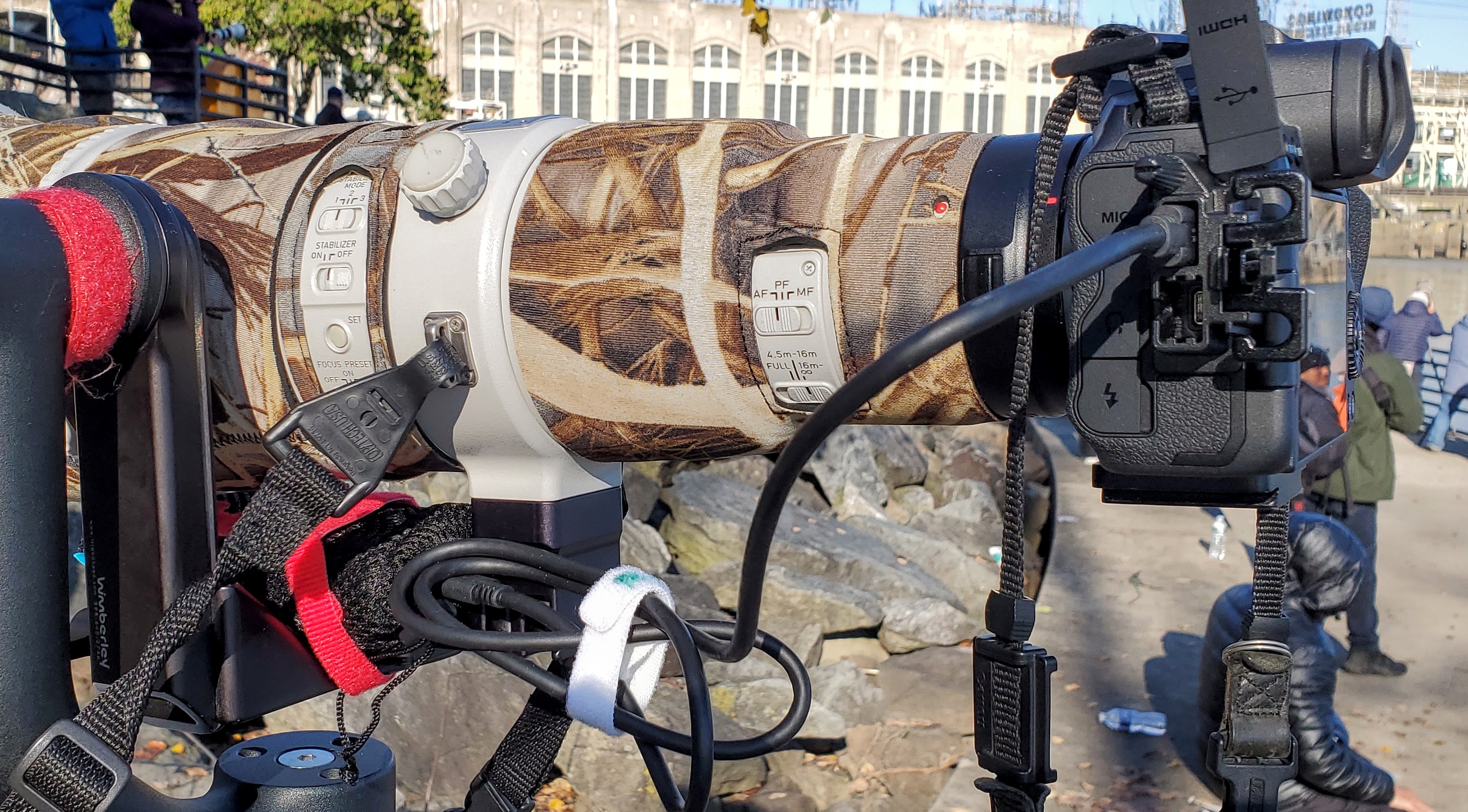

This can be done in two different ways, charging a 2nd battery off camera using a charger powered by a big battery or charging one battery inside the R5 using a big battery that has Power Delivery (PD) protocol. I chose the latter, to charge the battery right inside my camera while shooting. It works but has issues. See pic below for how I configured my camera, tripod, and battery.
Parts:
- Anker 20000 Essential PD w/supplied USB C-C cord $50 (a 10000 model will work well and is cheaper)
- Strain support thingy supplied with your R5
- Long Velcro straps
I left the battery plugged in the whole day while shooting. No issues at all. The camera will not use the external battery for operation via the USB C port, only for charging... it is either operation or charging, not both. The camera will charge from two different states:
1 - Power switch off - turn the camera switch to OFF, and green lamp lights and the battery charges
2 - Auto Power Off - with your camera switch to ON, when the camera auto powers off, the green lamp lights and the battery charges. It will not charge with just your Display and or View Finder timing out.
This can work well depending on how ready your camera needs to be... with some dead time, this work very well. If your camera needs to be at the ready all the time, this will not work.
Charge vs Discharge timing: It appears ... not real sure... that the battery discharges at a bout the same rate as charging... maybe. I ran some tests and using the Anker battery, I charged it undisturbed in camera for 1/2 hour and it charged: 69% to 89% in 1/2 hour.
How much was drained from my Anker 20000 PD battery after being plugged into the R5 for about 7 hours? Like nothing... seriously, the thing still showed full power. So.. the 20000 model is overkill; they make a cheaper 10000 PD unit that I am sure is fine.
What does Canon say about Power Delivery compliance? I don't know. Canon would not say when I contacted Canon Support Services. The Canon USB Power Adapter part number is PD-E1... so it appears... appears.. to be a PD compliant interface. If so, and I believe it is, any PD battery can be plugged into this port.

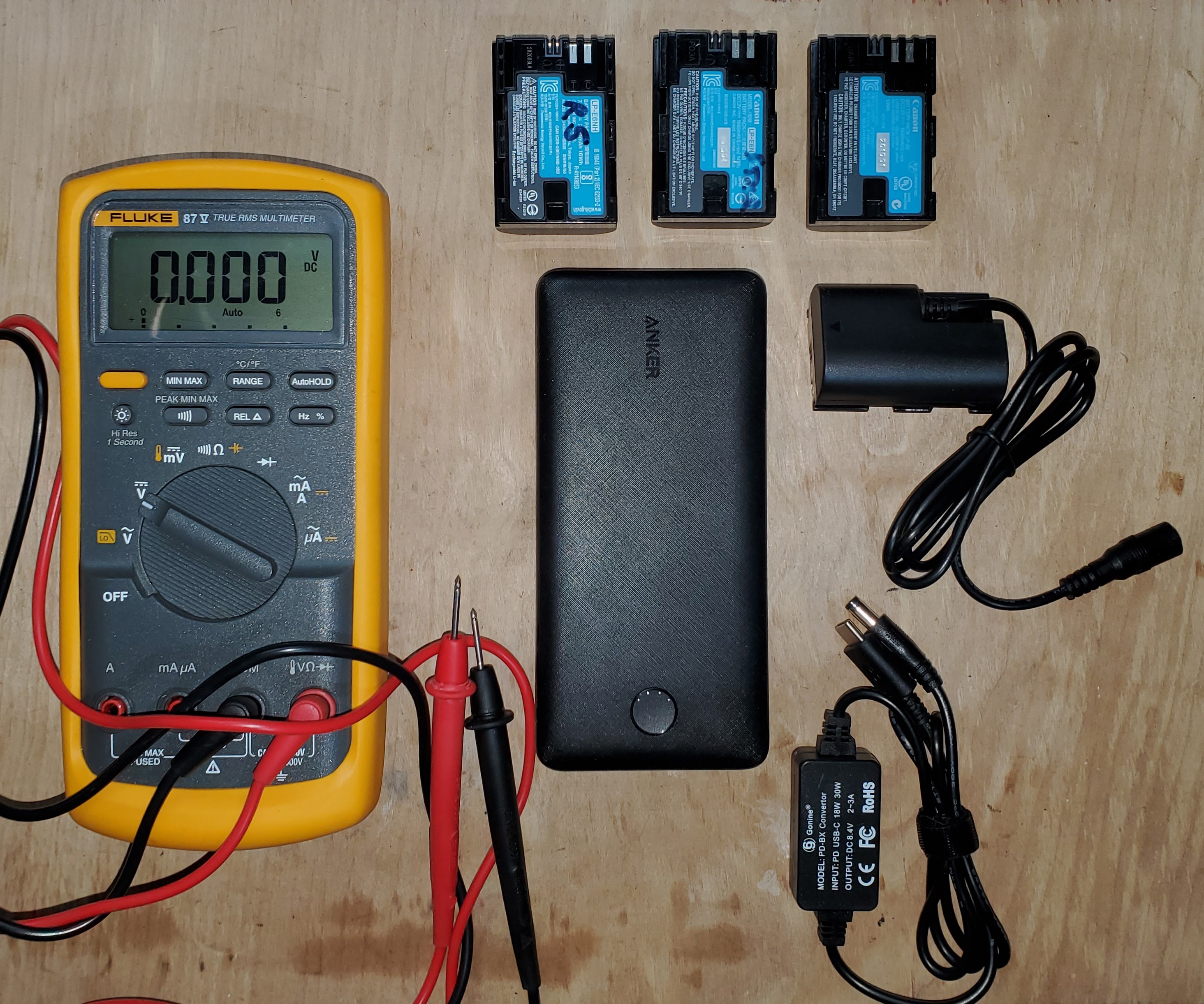

Using a DC, Dummy Battery Coupler
Now in the field, using a DC Coupler will require it to be attached to a battery. I purchased, for testing, a Gonine ACK-E6 coupler from Amazon for $29. This consists of two items, a dummy battery for the insertion into the R5, and a coupler. The side of the coupler that attaches to a battery via USB C-C is Power Delivery compliant. So it is a perfect marriage to my Anker battery. The other side outputs 8.4 volts. I measured its output and it was spot on to what it specified. I measured the output of my fresh, fully-charged LP-E6NH and it output 8.3 volts (it is spec'd for 7.2v) so I am comfortable using this Gonine unit given it is only .1 volt off from a Canon product.
Not shown in the picture below, I used the Gonine setup out in the field. It powers the camera totally fine, but does not allow for GREEN H+. When I checked the battery information in the menu, it showed the battery to be a LP-E6.
Summary, this particular setup is not acceptable to me as I want the fast shutter. Maybe the Canon coupler will work?

Some additional information for the curious... I tested the output those three batteries with fresh, full charges. They are spec'd for 7.2 volts but all output way more.
- LP-E6 8.18v Approx 8 years old
- LP-E6N 8.05v Approx 4 years old
- LP- E6NH 8.3v new
- LP- E6NH 7.67v w/59% charge

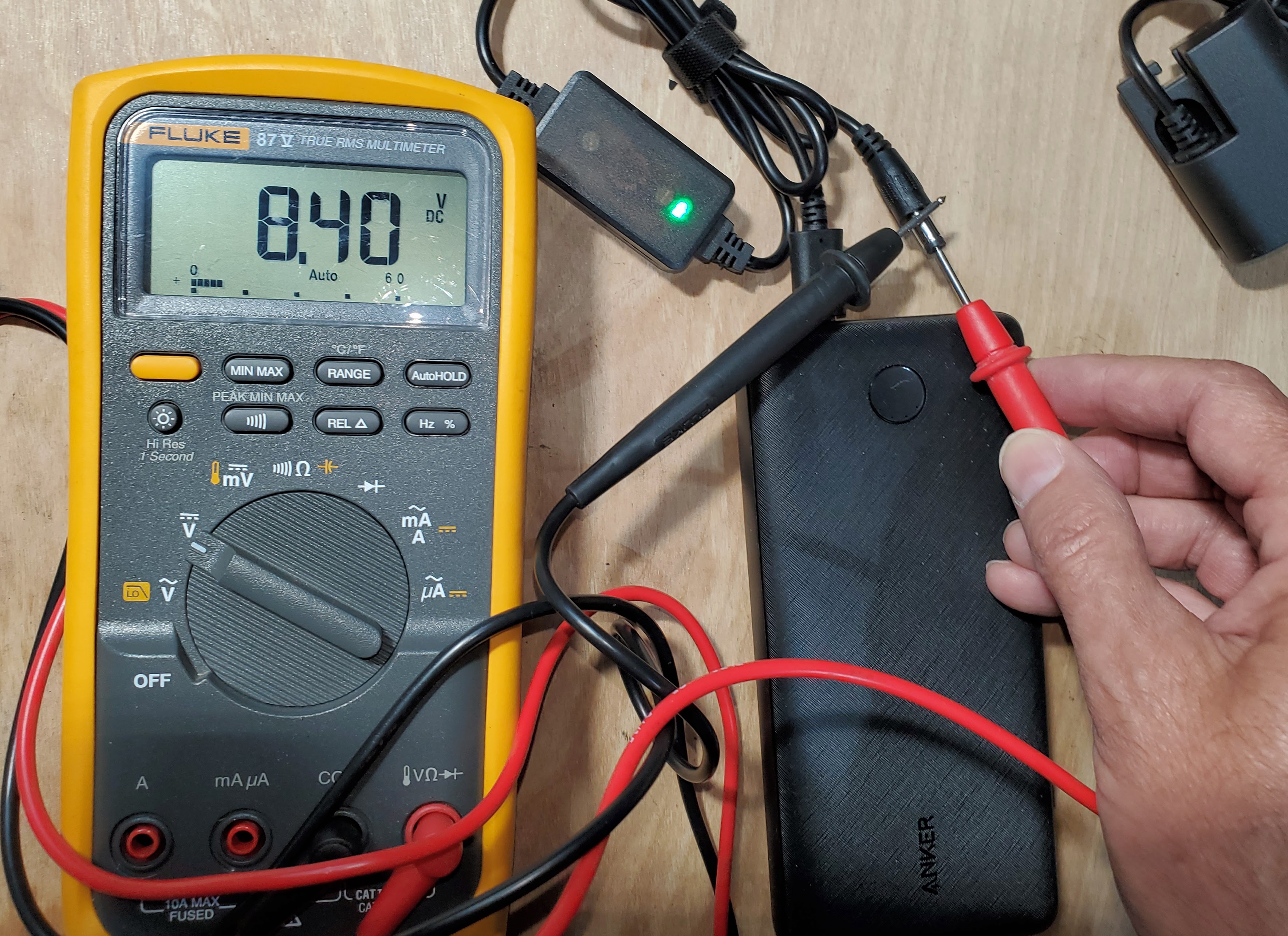

Charging straight from a PD battery to the R5.. the lower output Anker battery works as a charger only and only with switch OFF or when camera auto-powers off. With the higher output RavPower battery, the camera works straight off of the external battery and does not touch the internal battery... and will run forever! Anker and RavPower are the leaders in these batteries and both make high powered units.
Anker PD battery and Gonine coupler.. will work fine for normal shooting but won't give H+ shutter.
Gonine coupler outputs 8.4 volts exactly as spec'd by Gonine, I tested my fully charged LP-E6NH R5 Battery and it output 8.3 volts.
Parts:
- LP- E6NH 8.3v new
Parts:
- LP- E6NH 8.3v new
- LP- E6NH 8.3v new
- LP- E6NH 8.3v new
- LP- E6NH 8.3v new
- LP- E6NH 8.3v new
- LP- E6NH 8.3v new
Oh, and this new Power Delivery standard is appearing to grow so you most likely will be buying a PD AC-to-battery charger in your future. To charge the Anker the fasted and safest way is to use a PD charger. I purchased an Amazon Basics 5-port PD charger for $27.

Charging straight from a PD battery to the R5.. works only with switch OFF or when camera auto-powers off

Parts:
