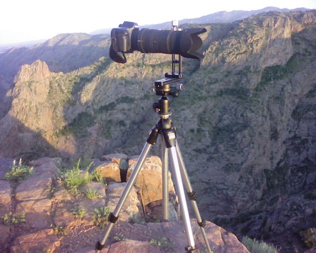

Lol, this will be the second time I've posted this picture today, but the Q3 is super strong! I would have no problems trying a very large lens on it.
5D, Bigma, RRS full pano setup on the Q3. Solid as a rock!

"but the Q3 is super strong!"
And the OP's stated requirements are.....
"I am looking for a ballhead for a lightweight tripod to be used for hiking. The camera is a 400D with 10-22 or 17-55 lenses."
That tripod don't exactly look hiker friendly.
"...I agree the Q3 is the hands down winner..."
BH-25Pro 6.5oz (186g)
Q3 13.44oz (385g)
Hmmmmmmmm!
Please forgive me.
