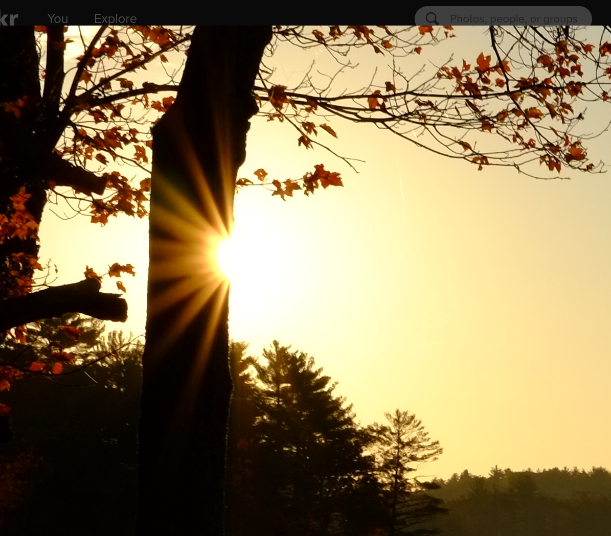

robbrown99
p.1 #10 · Switching from Cosina to Leica glass - advise needed for 'into the light shooters'
Then the closes ups on X-Pro1 with Zeiss Distagon 12mm and Planar 32mm lenses
It looks a lot more 'natural' or maybe 'organic' is the better term. No multiple spurs in parallel.
Oct 29, 2026 at 06:28 PM
