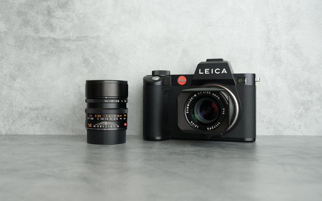

I've had a lot of fun with this very capable and IMO comfortable SL2+M kit. IBIS + that renown SL EVF and everything else Leica does to make sure Leica M lenses perform optimally on their full frame mirrorless system, e.g., a Leica-thin sensor stack and specialized micro-lenses on the sensor. I use the Leica M-L adapter for full operational compatibility as well. Some good deals on this otherwise pricey adapter on the used market too.
Just for fun, a photo of the SL2 with Leica M-L adapter + 35 Lux/FLE. Added the 50 Lux ASPH for scale/size comparison:

That is exactly the combo I would be starting off with
