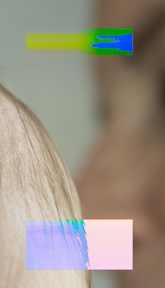

This is a screen shot of part of a recent photo from my A7R5. I've been using this camera for several years and have never seen this color artifact before. Can anyone identify what it is and what might be the cause? Thanks, Len.

It's either media card corruption or a sensor issue. The issue way to distinguish between the two is to analyze the embedded jpgs of the image (which is present for both raw and jpg images) and see if those embedded copies have the same issue - if they don't then it's media card corruption - if all copies have the same issue then it's likely the sensor.
If you PM me the original out-of-camera file I can check this on your behalf.

Len provided me the raw file and I was able to extract the the two embedded JPGs (full size and preview), neither of which had the artifacts present in the raw file. This indicates media card corruption in the raw data portion of the file. This is the common manifestation of media card corruption, since statistically the probability of corruption in the raw area is higher than the jpg area due to the size differential.

The camera playback uses the embedded jpg, and considering how we've established the embedded jpg is fine in this image, this explains why the image appeared normal during playback in the camera.
