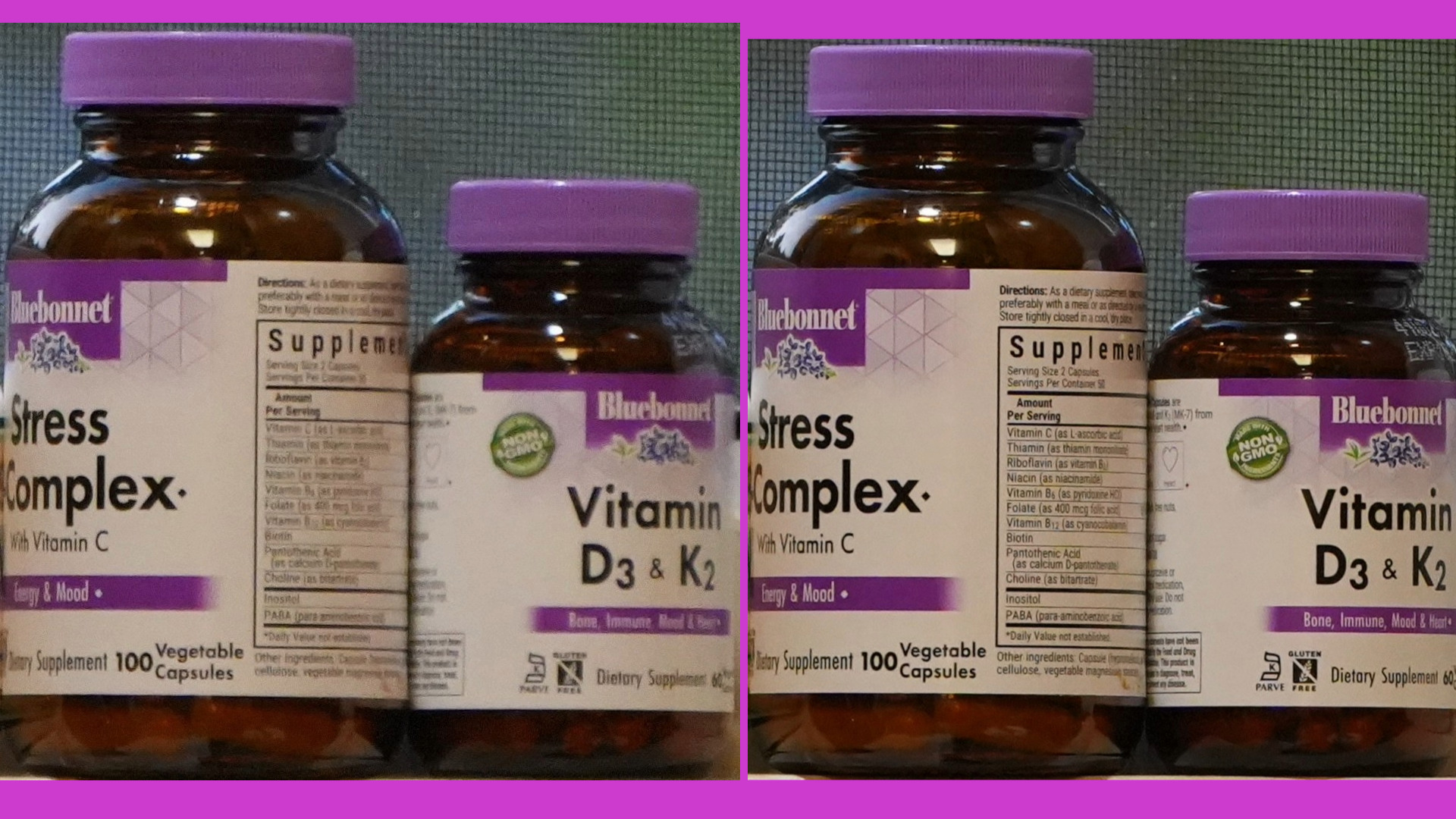

Just purchased Sony 100-400 4.5-5.6, to see if the extra price, heft and losing 50mm are worth it. Despite sonyalphablog equating them, there is anecdotal evidence that Sony is a little better, plus tc option.
Tamron on the left, Sony on the right. Same exact camera settings - 500 shutter speed, 400mm. These are at about 100%, i.e. not getting too deep into pixels.
I tried with 200mm and 100mm. Same differences, very noticeable. Perhaps my Tamron copy is no good, or it is what it is.
Posting as a references for others who might be deciding between the two lenses.
VILTROX TC-2.0X is supposed to come tomorrow, will see what I am getting with it and the new lens.
I have tried Sony 400-800 for extra reach, but found I rarely need the 800 and it's a beast to handle, thus the TC route.

p.1 #2Ha? Did not expect this. Tamron 50-400 vs Sony 100-400 original
It looks like the focus point was not the same between the 2.

p.1 #3Ha? Did not expect this. Tamron 50-400 vs Sony 100-400 original
Why do you think so? All things were equal to the best of my ability other than the lenses. I aimed the focus bracket at the larger of the bottles.

p.1 #8Ha? Did not expect this. Tamron 50-400 vs Sony 100-400 original
A couple things… I hear there’s sample variation in the Tamron, IDK, but mine is surprisingly sharp. But I don’t have a Sony to compare it to either, so maybe. However… Whenever doing tests like this, it’s always a good idea to put a ruler on an angle in the frame with a dot in the middle to focus on. This way you can absolutely confirm both were identically focused.

p.1 #9Ha? Did not expect this. Tamron 50-400 vs Sony 100-400 original
Is this a crop from the center of the image? Or from the edge/corner?
And how far was the lens away from the bottles? Was it shot near the minimum focus distance?

p.1 #10Ha? Did not expect this. Tamron 50-400 vs Sony 100-400 original
Something not right here. Tamron image looks heavily cropped or low rez. Clear artifacts in the background mesh and visible noise. Looks like the Tamron was shot at 50mm and uprezed, not 400mm!

p.1 #12Ha? Did not expect this. Tamron 50-400 vs Sony 100-400 original
Using a focus bracket to test lens sharpness puts way too many variables into play to make it a useful comparison.

p.1 #13Ha? Did not expect this. Tamron 50-400 vs Sony 100-400 original
Center. Far - across my kitchen and the dining room. I cropped both shots to about the same size to the same subject of focus.

p.1 #14Ha? Did not expect this. Tamron 50-400 vs Sony 100-400 original
Why not and what variables would be introduced if I kept camera settings, my position, frame position, bracket location all the same between the shots? Genuinely curious to know what I may have missed if anything.

p.1 #15Ha? Did not expect this. Tamron 50-400 vs Sony 100-400 original
Cheers
Leigh
I know what you mean and that’s the unexpected part. No upsizing, same exact everything for both shots. Slight increase in noise is due to 1/2 stop difference in max aperture between the two lenses.
I would share the original raw images with metadata except that it’s my kitchen and not sharing that. I am thinking of printing out a calibration sheet and trying the same outside.

p.1 #16Ha? Did not expect this. Tamron 50-400 vs Sony 100-400 original
You are testing the integrated result of native sharpness of the lens + the focus position. It's good to do that as it is after all what you'll get when using the lenses, though it's only one test of AF on a still subject. I would be inclined to test the sharpness alone using manual focus and magnify first, then, if say they appear to be equal, you'll know that poorer performance when adding AF is just AF of the lens. And of course if theTamron is still worse with MF only no need to go further.

p.1 #17Ha? Did not expect this. Tamron 50-400 vs Sony 100-400 original
Interesting.
I performed the same test several years ago and my results showed nearly equal performance in the center. As a note, my Sony 100-400mm was the best of three lenses I tested. I was surprised at the level of lens copy variation with the Sony lens. It is probably the same for the Tamron lens, but I lucked-out and got a good one.
The Sonyalpha.blog tests mirrored my results, almost precisely.
You might have a subpar copy of the Tamron lens.
In the past couple years, I have experienced outstanding levels of sharpness with the Tamron lens, although I mostly shoot the GM 300mm f2.8 with converters when I need a telephoto.

p.1 #18Ha? Did not expect this. Tamron 50-400 vs Sony 100-400 original
Are you using a tripod or handheld?
If tripod, are you manually racking out of focus each frame and letting it focus?
Are you using a remote trigger?
Is vibration reduction on or off?

p.1 #19Ha? Did not expect this. Tamron 50-400 vs Sony 100-400 original
3D objects are no good for testing unless you're trying to compare DoF or front/back focusing. Use a flat 2D object to test. Brick walls are boring but they are very flat.

p.1 #20Ha? Did not expect this. Tamron 50-400 vs Sony 100-400 original
In the old dslr days, I was the guy in our group with a 60' long basement and was nice enough to af fine tune lenses to bodies for my friends. What a hassle. I used the lens align which was great. 8' away for every 100mm. I was able to tune to about 700mm. From the thousands of test images I ran, I can plainly and emphatically state that any lens testing not done on a tripod, VR/OSS off, wired or remote release and cocking out of focus and back (and waiting a few seconds after cocking) in AFS, re-cocking between every shot WILL NOT give accurate results. Back in the day I was shooting Nikon and my 300 2.8 was -18 on one d850 and +2 on another. Same lens, different bodies.
I agree that (now that we are focusing on the sensor) a brick wall on a bright overcast day is the best means of testing for overall sharpness (not performance). I make certain I am squared up to a large brick wall ( I use a grade school gymnasium wall on weekends) and put an "X" of duct tape on the wall. That is my focus point for all focal lengths. I attach a 4' level to my tripod legs to measure my squareness to the wall. I bring a 50' tape.
If a person is using afc for static testing, it can throw off results. No cable release. forgetaboutit! Leaving vr/oss on, results will be impacted. Handholding? No way. Just for kicks, put your longest lens on your tripod, clamp it down and watch the lcd as you depress the shutter. Even the best tripod will show movement from your hand depressing the shutter.
I discount many reviews of lenses when I see the methods in which people test lenses. I love the diagonal lens testing over ocean water in sunlight! Heat distortion, anyone?
Besides, as previously stated by others, most new lenses are engineered to be sharpest in the center of the frame, zoom or prime. I think we pay the big bucks for fast lenses and corner performance. If someone is only interested in the bulls-eye center, most lenses will do just fine.
