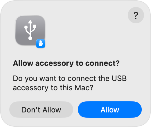

Sidebar question. How do you guys update Viltrox FW on a Mac? My Mac doesn’t see the lens if I plug it in.

p.1 #13 · Viltrox 14mm and Sony A7RVI autofocus issues
You're using the 'Viltrox Lens' application, right?
Did you get the Mac OS alert asking if you want to allow it to connect?

p.1 #14 · Viltrox 14mm and Sony A7RVI autofocus issues
Yes, but I don’t get that window. I will reinstall the app and try again.

p.1 #16 · Viltrox 14mm and Sony A7RVI autofocus issues
So I reinstalled the app and it now works. I was able to update both my 26 EVO and 50/2 AIR. Both of those lenses AF just fine in either single or continuous AF on my A7R6 for whatever that's worth at time. To be more clear, the AF on the 26 is still relatively slow, but it's accurate; the AF on the 50 AIR is almost instant by comparison and possibly faster than it was before.
