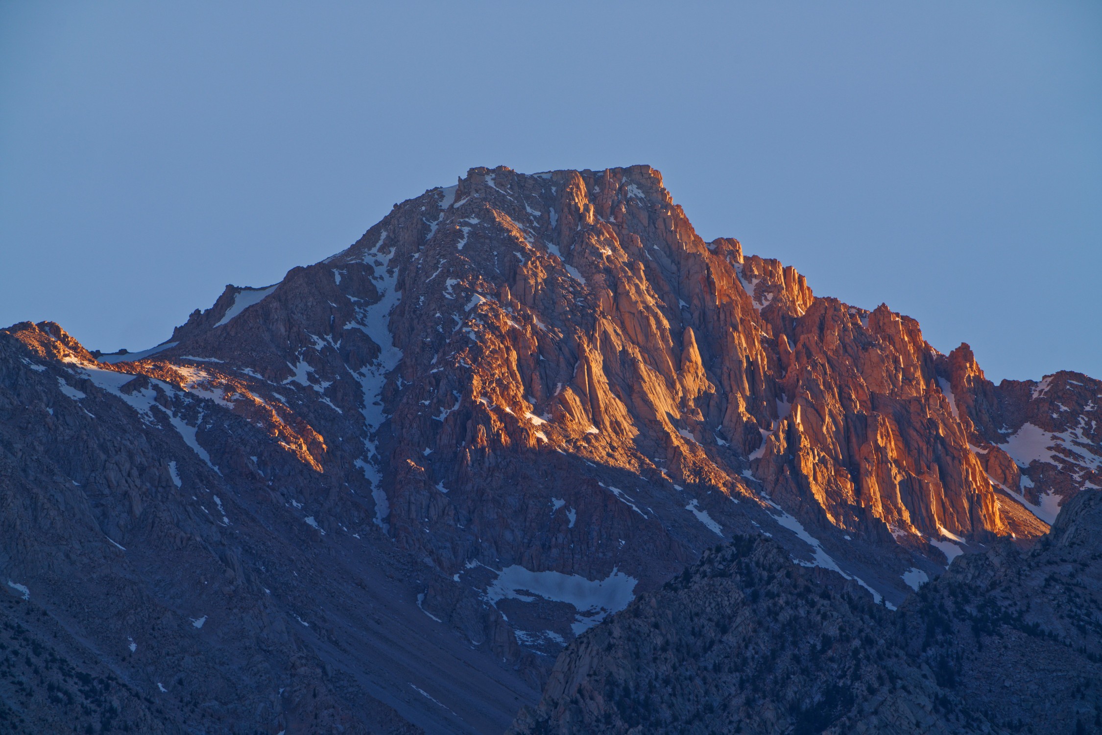

I mainly shoot landscape and would like those who have used both these lenses for the same purpose to give me their feedback. I currently have the 70-200 GM ii and the tc and while I get decent images out of the combo I feel like the 100-400 might edge it out in terms of iq. I had the old 100-400 GM and was never impressed with the IQ and I had the 200-600 but wasn't happy with it either. I haven't tried the new 100-400 but I know I can afford it if I sell of both the tc and 70-200 GM ii. For those with insight please feel free to share. I would get the 300 GM but that's out of my budget currently until next year when I would be able to save up enough to afford it. Or should I hold off for the year and but the 300 GM just a question to throw out there.
I also included a shot with an example of the 70-200 GM with 2x tc zoomed all the way out at 200.

I have both and I have a good 2X TC. If it's only landscape shots like the above I wouldn't bother getting the 100-400.

I have shot all the lenses you mentioned, with the exception of the new 100-400mm. I virtually never paired my x2 converter ( best IQ out of three copies) with any of those zooms and had results that I was completely happy with. I would save your money for the GM 300mm f2.8. It is smaller/lighter (travels well and less fatiguing) than the big zooms and has IQ that is outstanding with the x2 and stunning with the x1,4 (or bare).

I took the 70-200 GM II with the 2XTC to Patagonia in case of wildlife opportunities and it worked well for landscape as well....one at 400mm and one at 394mm....
  ILCE-7RM5    FE 70-200mm F2.8 GM OSS II + 2X Teleconverter lens    400mm    f/11.0    1/200s    100 ISO    0.0 EV
  ILCE-1M2    FE 70-200mm F2.8 GM OSS II + 2X Teleconverter lens    394mm    f/5.6    1/2500s    250 ISO    0.0 EV

I feel like a 70-200 f2.8 and 100-400mm f4.5 are fairly different lenses. On one hand, how much do you value the ability to go from 70-100mm, and how much do you value f2.8 from 70-200mm or even f4 from 100-280mm with a TC 1.4. On the other hand, how much do you value 280-400mm at f4.5 vs f5.6 or the ability to get to 560 f6.3 or 800mm f9. If you do any action photography, a 70-200 is about a 3x zoom, and the 100-400mm is a 4x zoom. If size and wight is important to you, the 100-400mm f4.5 is bigger and about twice the weight of the 70-200mm f2.8. If you use filters, the 100-400mm f4.5 uses drop in filters or 95mm filters, which are usually quite a bit more expensive than 77mm filters.
From a pure IQ perspective, wide open, the 100-400mm f4.5 probably has an edge (I have not seen any comparisons yet), but I doubt the IQ difference will be enough to outweigh the above considerations.
