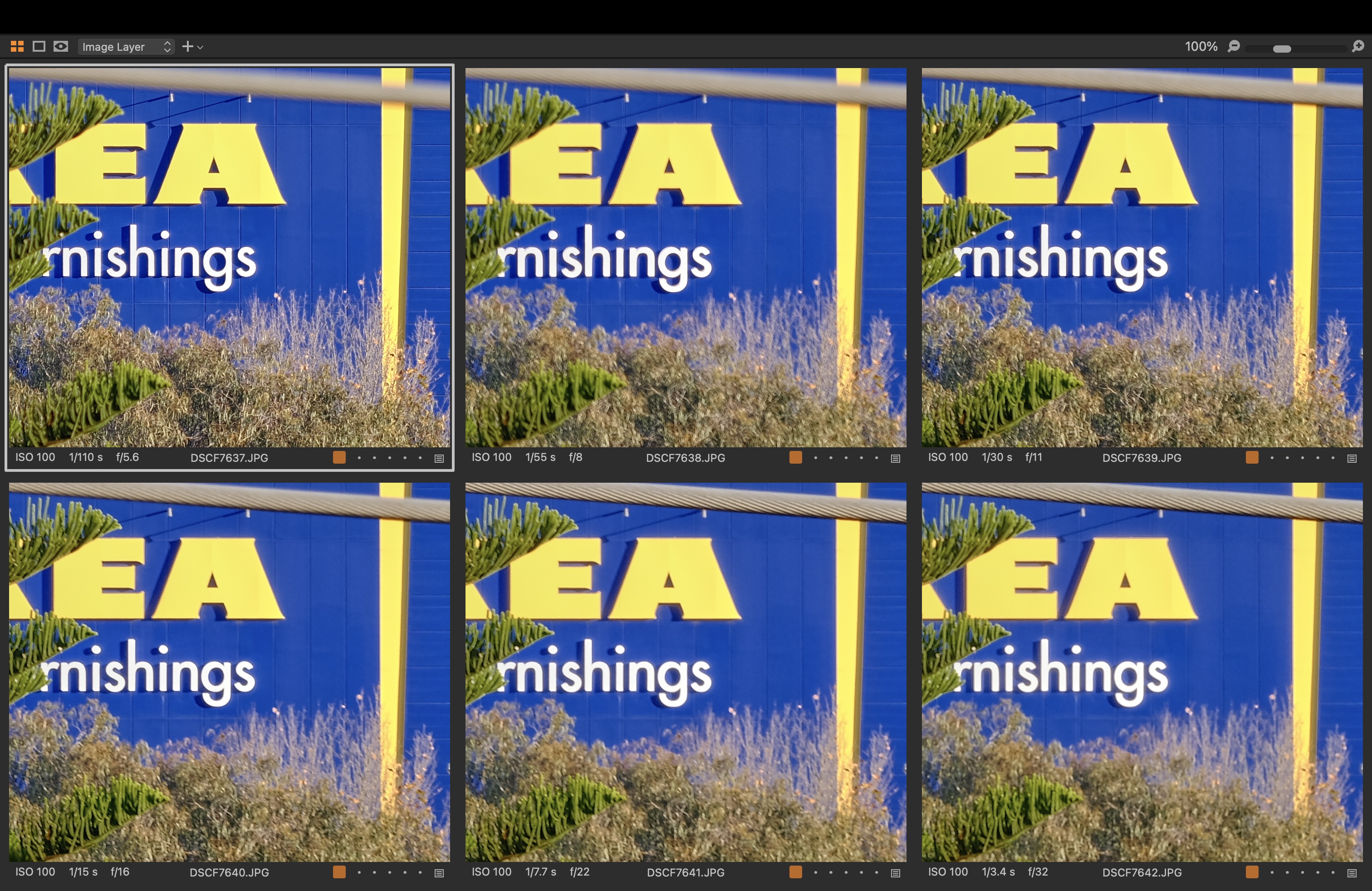

I'd heard this was one of the least sharp native lenses for GF (which is a very high bar!) but I wanted to try it out anyway so bought it used from another user here on FM. It is reasonably small and light, and feels well made. The lens collar is really nice and easy to remove, though I do wish they'd cut the foot for Arca Swiss.
But this copy of the lens is performing very strangely.... it is reasonably sharp wide open at f/5.6, but it is very blurry stopped down to f/8! f/11 is slightly better than f/8 but it is never gets as sharp as it is at f/5.6.
I'll attach some test shots below. All taken on a sturdy tripod using the lens foot on a windless day with a 10s timer and stabilization turned off. I tried both autofocus and manual focus, and I updated the firmware for both the lens and the camera body (GFX100S). I took multiple shots over several days to make sure they were not user error and they all look like this.
I've never heard of a lens being sharper wide open than it is with the aperture closed down by one stop, so could any other GF100-200 owners please chime in?
Here is a link to the full 100MP resolution album: https://ibb.co/album/tzdZD6
GF100-200 @ 100mm and ISO 100

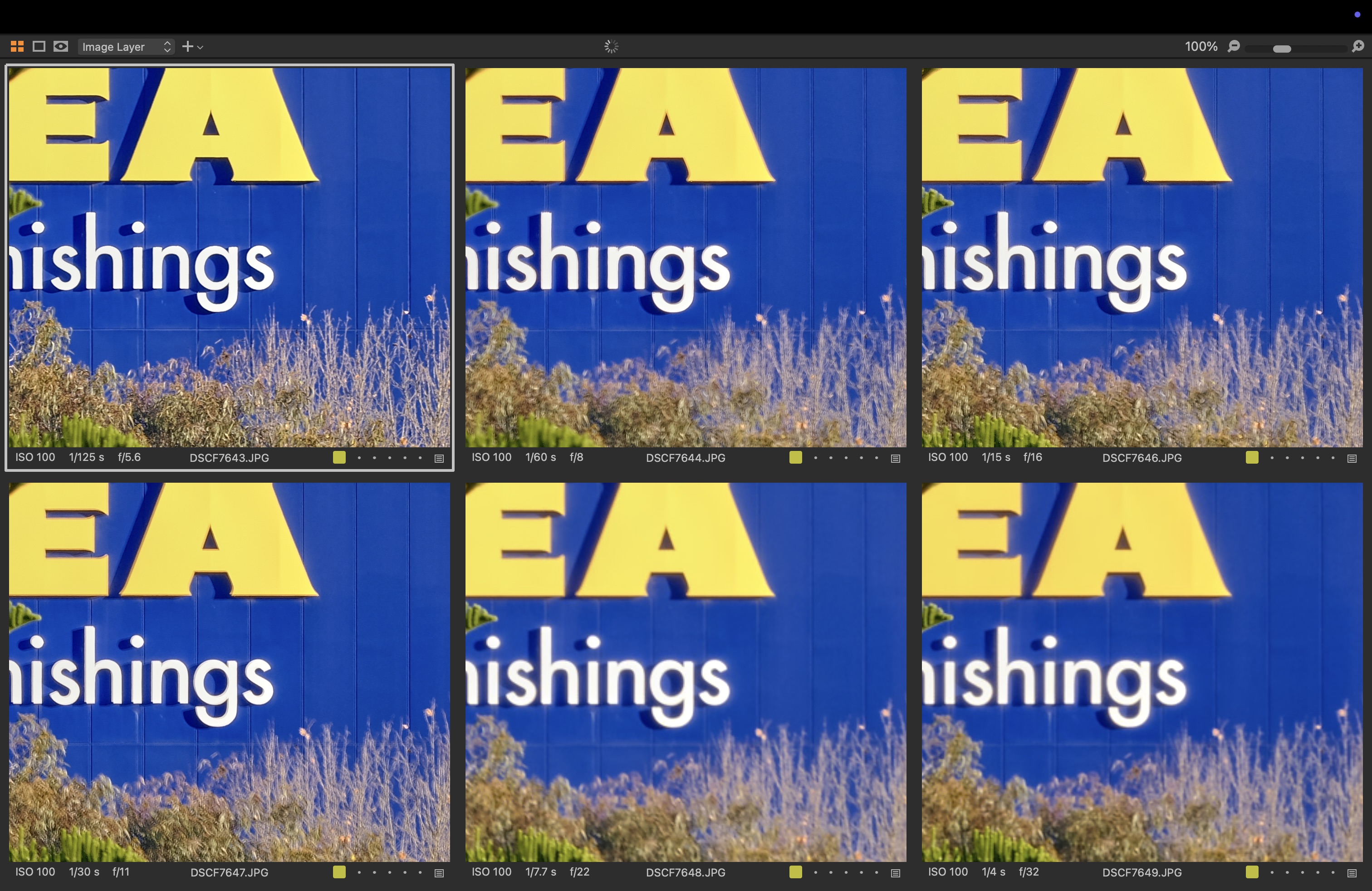

GF100-200 @ 153mm and ISO 100. Note that the positions of f/11 and f/16 are switched in this set, sorry!

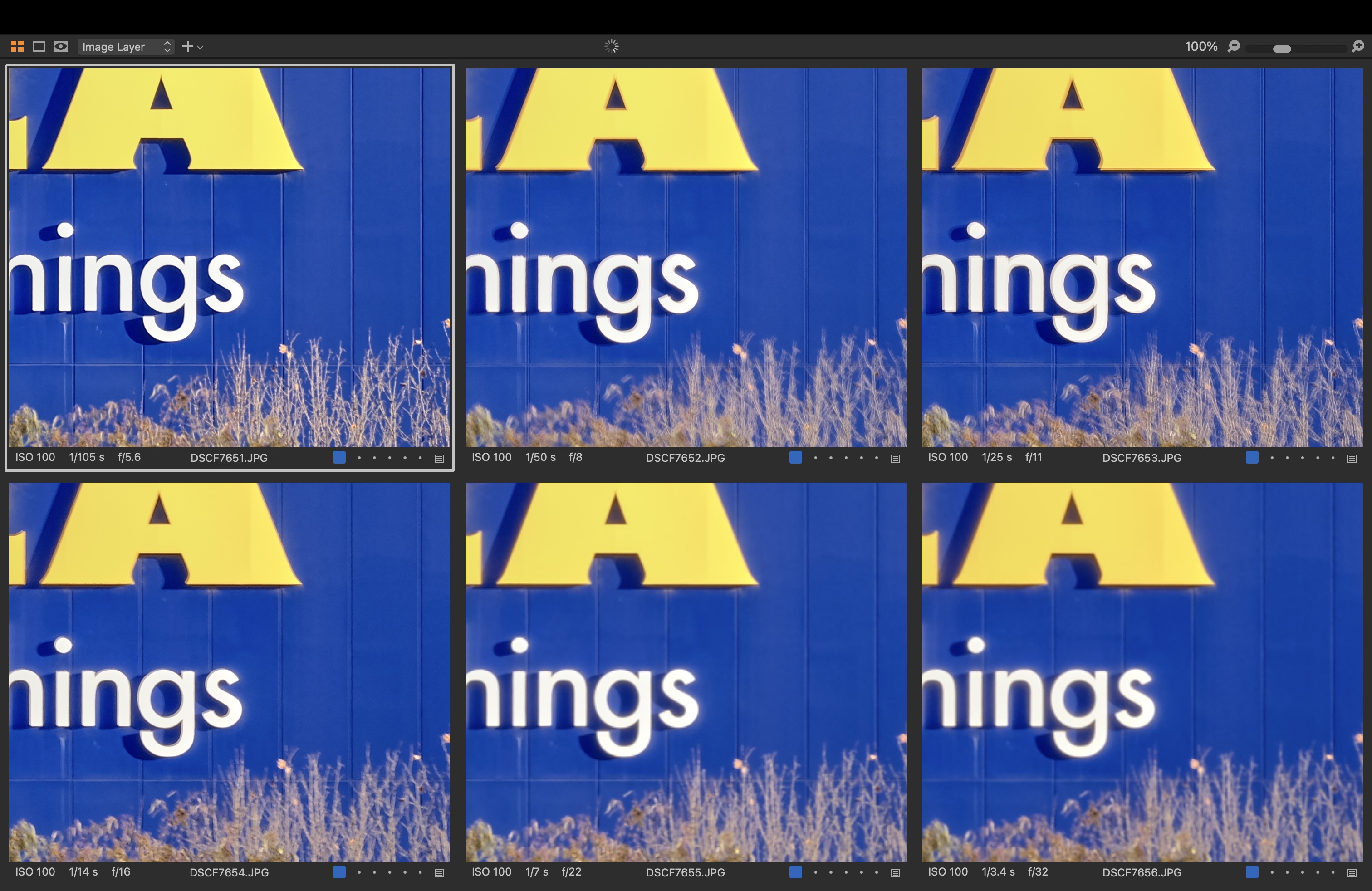

GF100-200 @ 200mm and ISO 100

Two possible reasons:
#1: Shutter shock. Can't magnify the images so I have no idea of what shutter speeds you used.
#2: Focus shift. Some lenses move focus slightly when stopping down, because of spherical aberration.
Edit: It's also possible that such a slow lens actually is sharpest wide open, at least partly because of diffraction softening when stopping down. But then it should be worse at f/11.

I found out the hard way to never use this lens with mechanical shutter. Once I switched away from mechanical shutter and used electronic shutter, sharpness issues disappeared.

Thanks everyone. The issue was in fact shutter shock and I can't believe that hadn't occurred to me. With some pixel peeping I noticed the same issue with the 32-64 if I punch in more, so it just really does not like 1/80 to 1/200 shutter speed or so! Turning on IBIS/OIS does seem to help a bit when using mechanical shutter but still not as sharp as electronic shutter. A little annoying that I'll have to remember to switch from ME to ES when using those shutter speeds...
Oddly the 100-200 is still sharper at f/11 than it is at f/5.6, but it is much closer now and both are usable. Phew!

There's been such bank-and-forth about this lens over the years that I've retested my 2019 copy on several occasions and at several subject distances. After reviewing a couple of hundred images, here goes.
Around 200mm, I could never find a case where central definition was higher at f/11 than f/8; almost always there was the usual slight softening at f/11, and the couple of cases where f/8 and f/11 were similar centrally had questionable focus. Centrally between f/5.6 and f/8 there is little difference. On a high-quality shorter lens we should see visible difference, so there's that against this zoom.
The corners definitely benefit from f/8, and in some cases, f/11. The corners with most lenses benefit from stopping down two stops, so I regard this result normal.
All the above was on a substantial tripod with ES. Handheld or on a monopod one should use EFCS and stabilization. The effect of EF on bokeh depends both on aperture and on the distance of the exit pupil from the sensor. It can indeed be seen with a short lens at a very wide aperture, but with a long, slowish f/5.6 lens it's an utter red herring.
With a light tripod and mechanical shutter the risk of movement would be reduced by mounting the camera directly on the tripod rather than using the lens collar. And with sub-one-second exposures stabilization would likely help, defying blanket strictures about stabilization on tripods.
