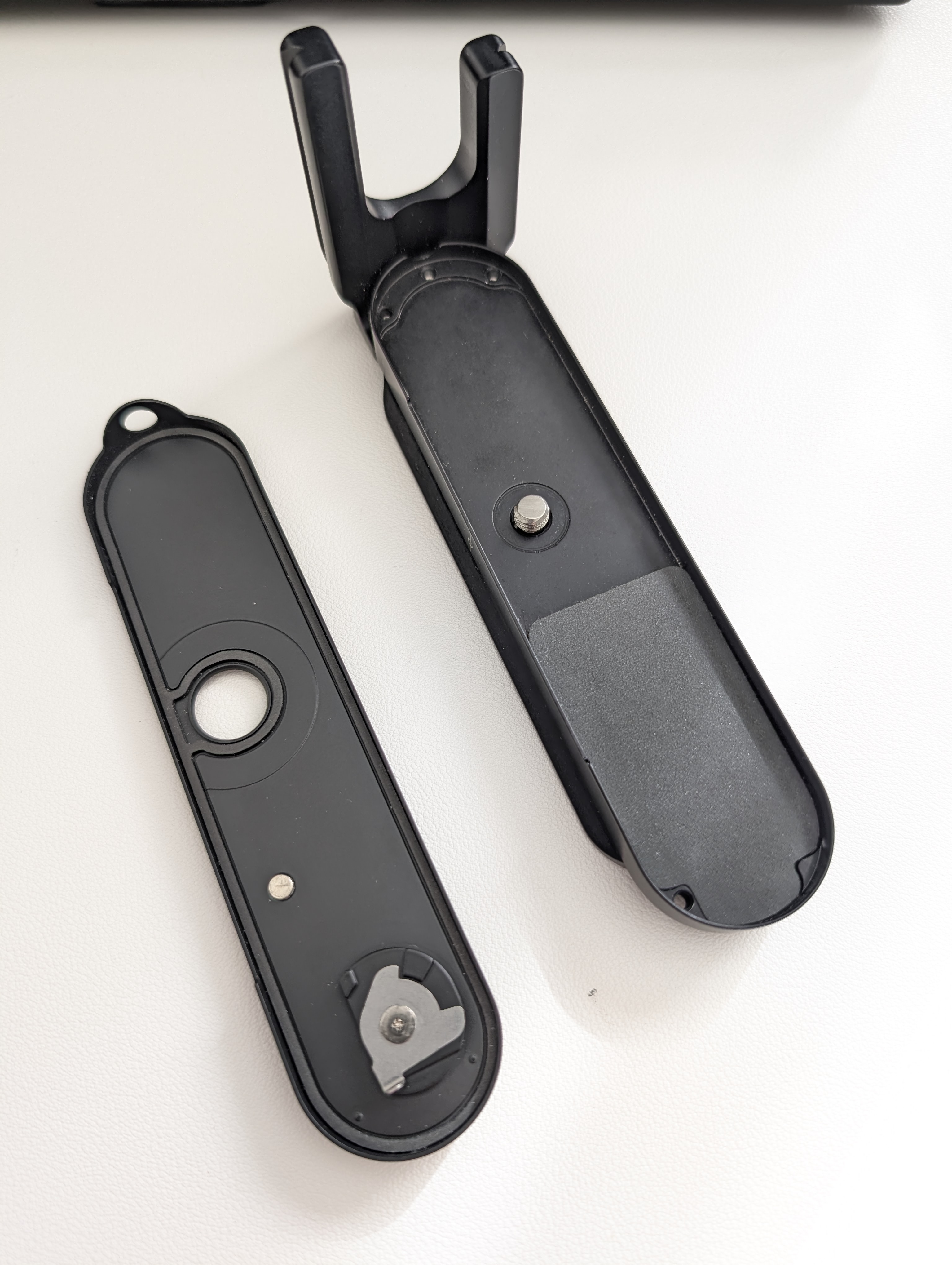

I am getting a fairly persistent SD error on boot with my Leica M10-R and RRS baseplate (it is an arca-swiss L-plate with grip.
My hunch is that the RRS plate is pulling in places it shouldn't. When I unscrew it, but keep it attached with my hand I get no error when I restart it. Also when I use the OEM baseplate there is no such error.
The design of the two plates is quite different. Leica OEM plate uses a very fine rotating mechanism on the battery side that swivels into a latch, and on the other end (viewfinder end) there is a hole for fitting over a small nub on the camera body.
The RRS plate uses a thumbscrew instead, which attaches into the tripod socket. My guess is that some sensor in the body isn't getting triggered properly.
Does anyone else have / had a similar issue?
The only reason for me using the RRS plate is to use it to attach quickly to a monopod or tripod (horizontally or vertically). I could probably do without the vertical option, but it is very nice to have a baseplate with an arca swiss mount built in so that I don't have to unmount an arca plate, then unmount the baseplate to get to the battery or SD card.
Perhaps there is an arca option that the same mount as the OEM baseplate?

https://www.l-camera-forum.com/topic/320246-purpose-of-the-magnet-in-the-m-10-base-plate/
The RRS plate probably had some misaligned magnet or something? The fact that it works when you hand holding the RRS plate suggest the design was ok...
Jun 16, 2026 at 09:43 AM
Admin
p.1 #4 · [in diagnosis] SD error Leica M10-R with RRS baseplate
From my experience making a 3D-printed version, the magnet must be positioned with absolute precision. Even a slight misalignment can prevent it from working properly and trigger the SD card error.

First I did check for the presence of the magnet - it is indeed there in the plate. It is under the pad.
I found this article: https://www.l-camera-forum.com/topic/308798-rrs-base-plate-issue-with-m10-monochrom/
1. The OEM baseplate has a gap between the plate and the leatherette.
2. The RRS plate pushes against the leatherette. Possibly causing the SD card issue.
3. If I add a shim, I don't currently get the SD card error. However I need to verify this.
More analysis required.
In short: I think this could be down to a design issue of the plate.
These photos describe it well...
https://www.flickr.com/gp/brownphotographic/iV0d15s861
