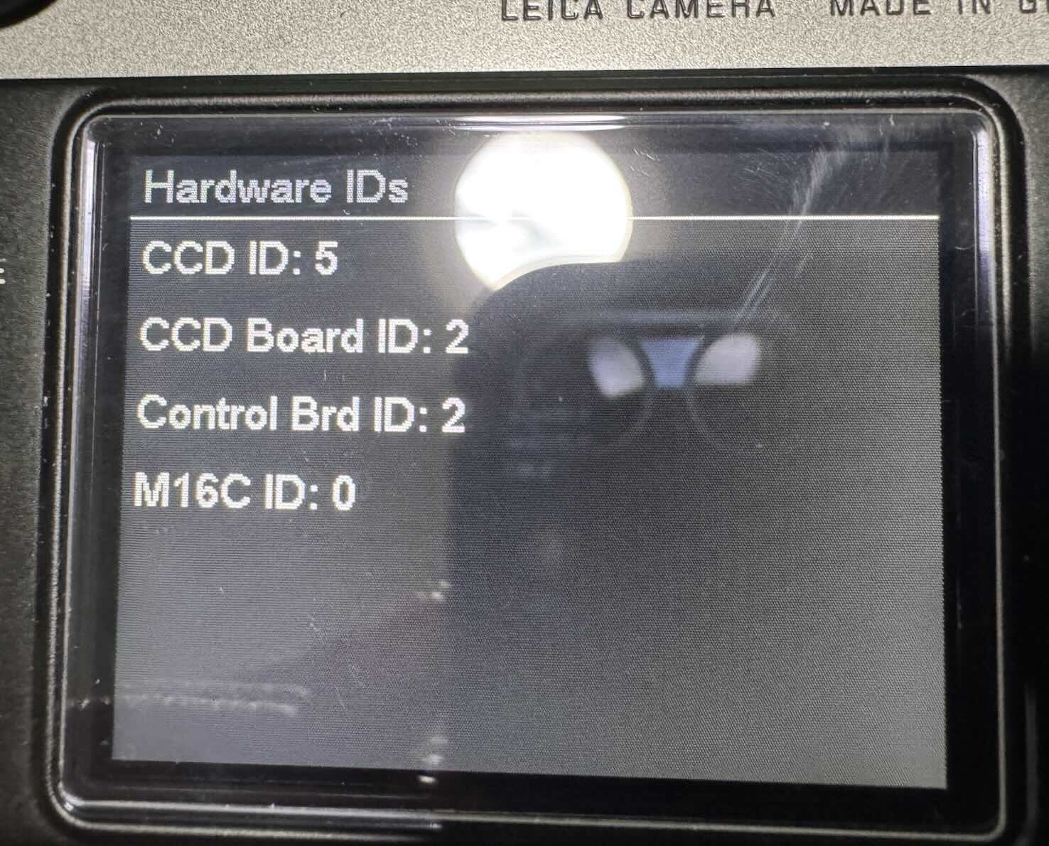

I recently purchased an M9 from a seller who described the sensor as replaced. Upon receiving the camera I checked the sensor info in the debug menu and was shown this info. I'm guessing the sensor has not in fact been replaced most likely?

CCID 15 and 16 are the "safe" versions where you don't have to worry about corrosion.
Anything under will need proof that the sensor glass was replaced to prevent the corrosion from occurring.
Check out Kolari's sensor replacement / sensor glass replacement service page for more details.

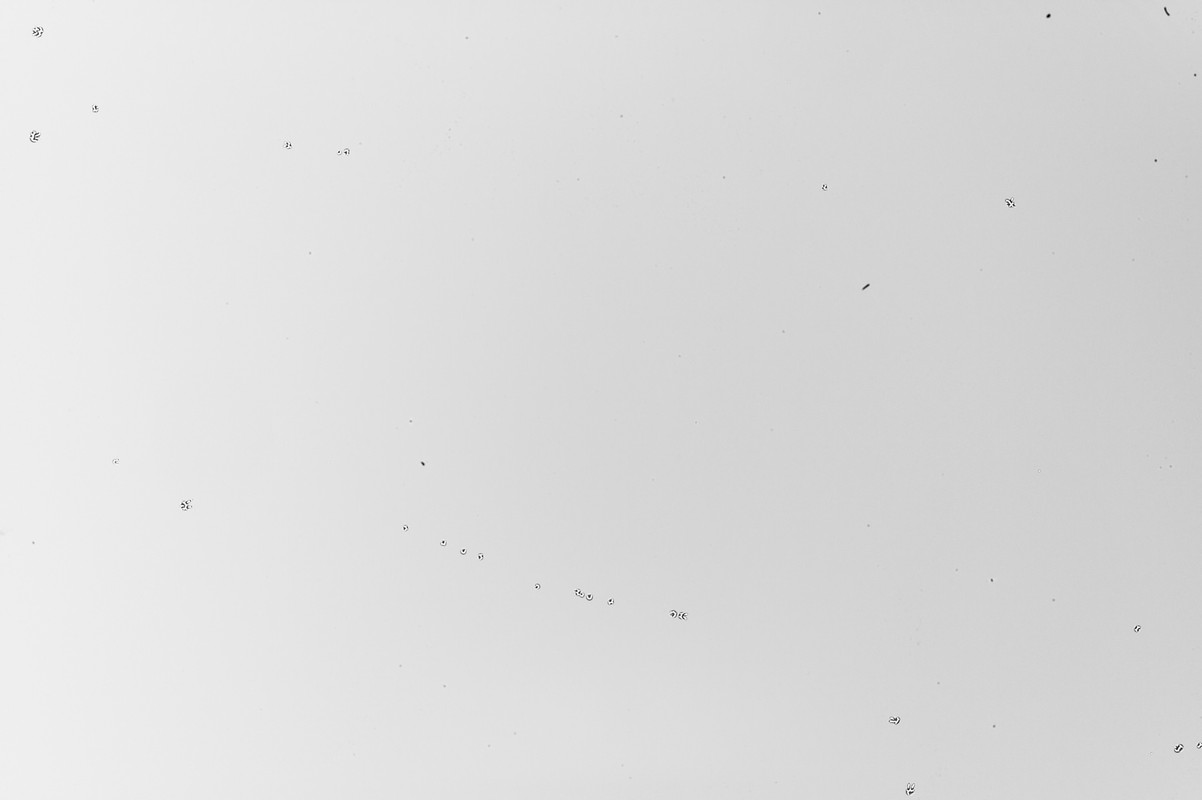

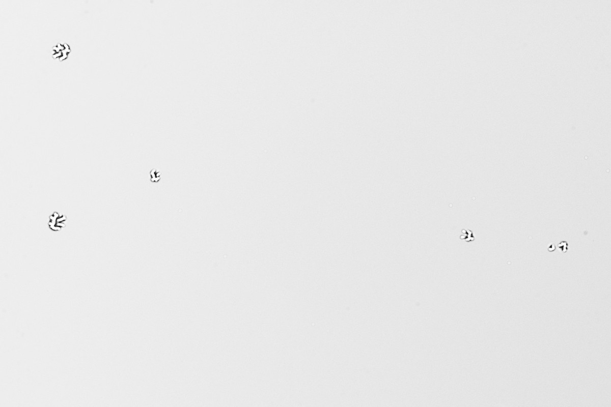

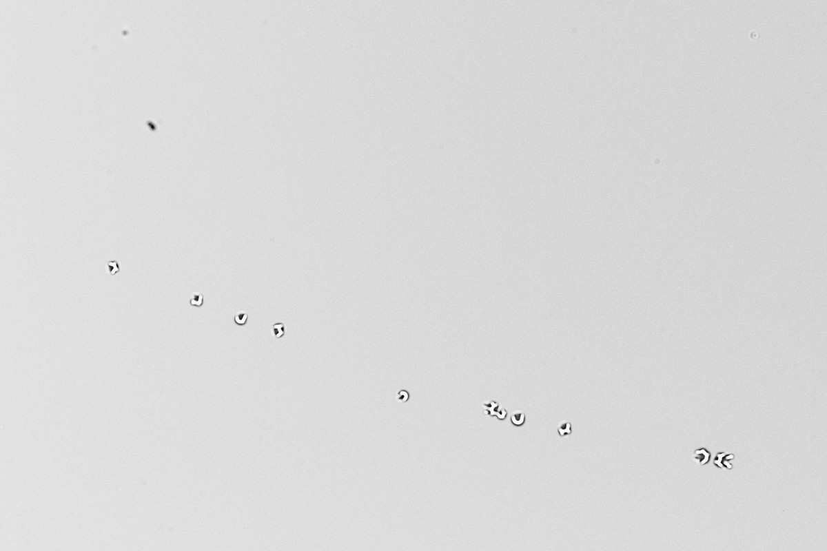

Here's what my M9 looked like before it was sent in just before the free replacement service was ended by Leica. The second and third are crops of the first, which I believe was the full sensor area:
In the last image (crop) you can see regular dust that is just black and fuzzy-edged compared to the line of 'donuts' that is cover glass corrosion.
