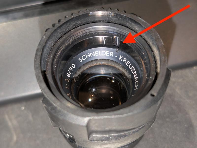

I have recently acquired some interesting lens, one of which is this Schneider-Kreuznach Tele-Xenar 90mm f/3.8.
It came with this industrial focus/aperture collar over the front.
i.postimg.cc/K4MTD8Sv/PXL-20260604-225828362.jpg
i.postimg.cc/w3mNQj8v/PXL-20260604-231829576.jpg
i.postimg.cc/DmXGPwk0/PXL-20260604-231901544.jpg
i.postimg.cc/vDVntZFb/PXL-20260605-000333841.jpg
The plastic sleeve spins completely freely 360 degrees, but it feels vertically locked/mechanically captured and refuses to slide off the top when pulled. There are no grub screws anywhere on the casing, and applying heat with a hairdryer didn't expand it enough to budge.
I've seen a few pictures of this lens without the sleeve.
i.etsystatic.com/9656050/r/il/923f8c/678377088/il_fullxfull.678377088_8na7.jpg (Not my image)
Does anyone recognise this setup and is there a trick to get it off, or should I bring out the saw?
Thanks!

Never dealt with anything like that. Be careful, though. I've purchased a couple of enlarging lenses of the bay that had weird mounts I assumed the lenses were just screwed into, but it turned out the entire body was modified and the mounts built-in, with no typical M39 mount at all. If the sleeve is somehow integrated in the build in a way that's not obvious, a saw may only expose a larger problem.

Have you tried unthreading the ring that appears to be mounted on top of the face of the lens?

Thank you both, twisting the inside ring has worked.
I've ordered the parts to adapt this lens to my MFT camera now.
