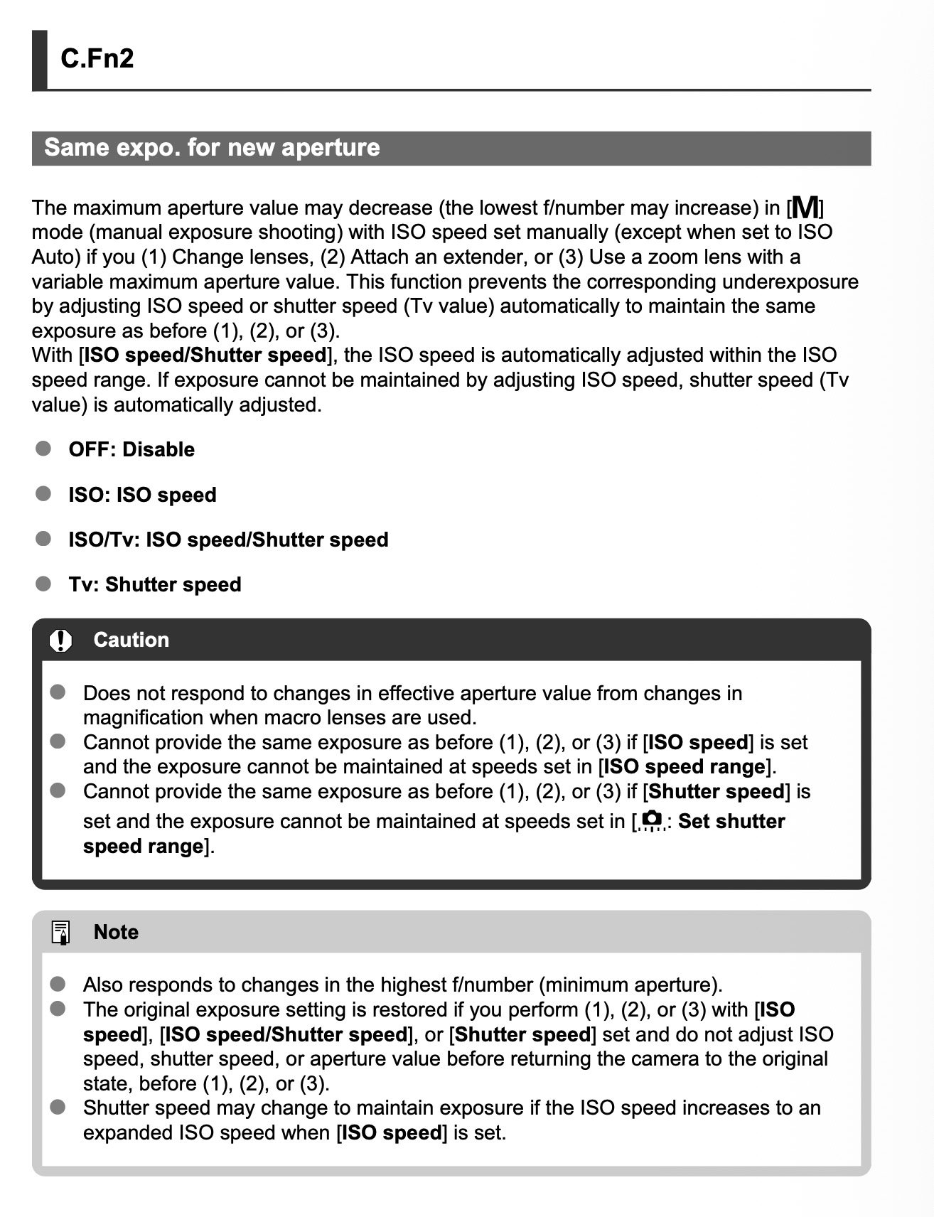

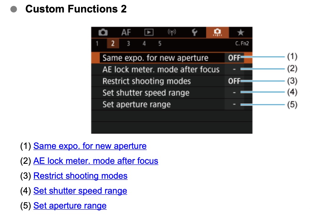

You don't even need to use Auto ISO on Canon cameras to solve this issue.
Canon has a setting that will adjust either the ISO or the SS when the aperture changes. Either when zooming a variable aperture lens or when swapping on/off TCs.
This is a great feature for full manual shooters like myself (and you). As you don't have to use Auto-ISO.
I always set it to ISO as I want my SS to stay where I set it. 4.5 to 7.1 is 1 1/3 stop so I'm okay dealing with that change in ISO.
One alternative option is to zoom the lens to 100mm and set your aperture to f/7.1. Then it will stay at f/7.1 at every focal length. This is probably not what you want as you may want to take advantage of the brighter f-stops when you do zoom out.
The setting on the R5II is "Same exposure for new aperture"....set to ON and choose ISO.
As far as what ISO and what SS you are comfortable with you will have to experiment with SS you can handhold and get a reasonable keeper rate and process some higher ISO files to see what you are comfortable with.
