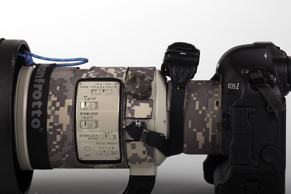

When shooting field sports with three cameras, one with a 500/4L IS on a monopod, and one hanging from each shoulder, I would 'clip in' from a short loop attached to the top of the 500 (above the monopod attachment point), to a sling that's diagonally across my body. You can see the short loop in the attached photo; it's the bit of blue cord held in place by a piece of sling (in this case, from a Manfrotto gizmo).
So, when I want to "let go" of the big lens, I lower the monopod so that the top of the lens is at about waist level, at which height, its weight is almost supported by the carabiner that attaches the lens-loop to the body-sling. IOW, it won't tip away from my body. The only downside is when the monopod gets between your legs, as you try to walk. That happens about once. If you hitch it off to one side, then you can sort of drag it along beside you, but it's best used when standing still.
I prefer to use this approach with my one-handed-action Manfrotto Neo-Tec monopod (squeeze the grip and it goes up or down), but it also works with my rotary-lock Feisol monopod, which just requires two hands, for a moment.

Blue cord loop on 500/4 (at left, by reversed hood), clips into diagonal body-sling for no-hands support
