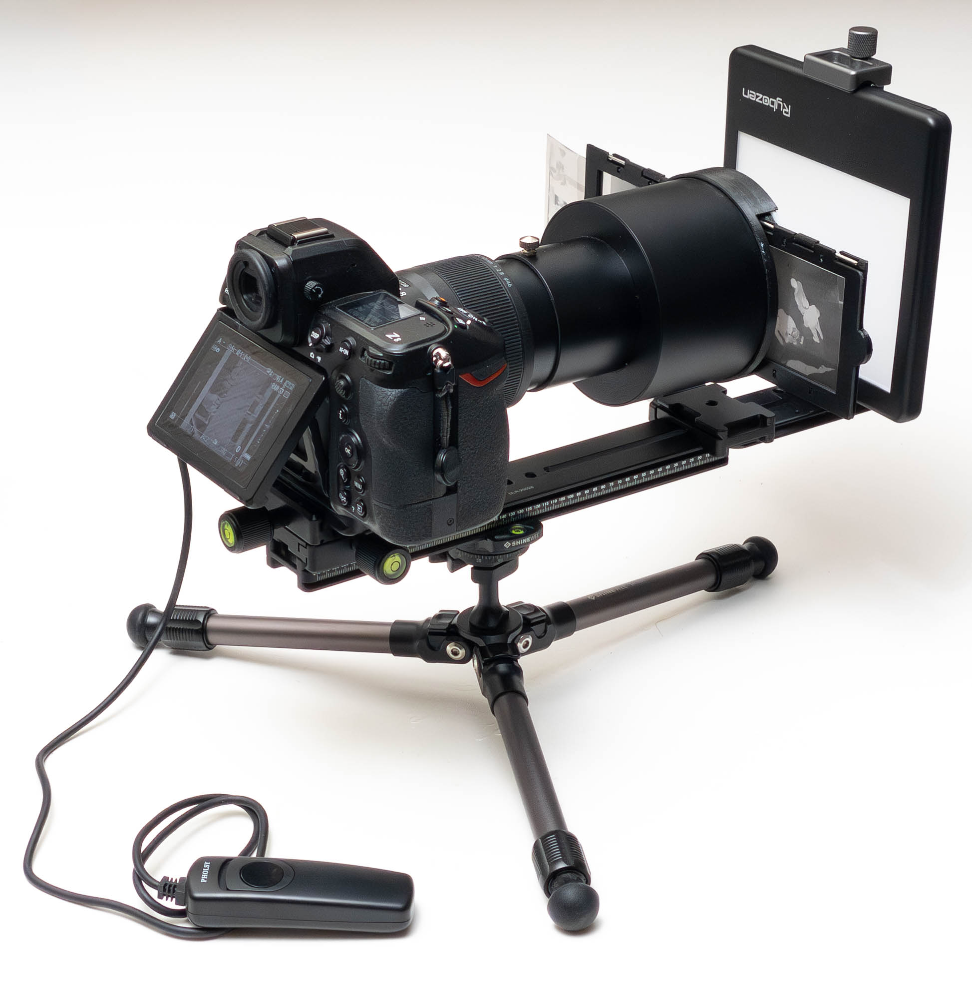

I use the Z 50mm MC for my slide scanning rig, having recently switched from the Sony 50mm. So far, I'm very happy with it. I especially like that the portion of the lens that extends when focusing is actually inside the slide holder. With the Sony rig the holder had to be screwed to the moving part, which made it a lot more fragile/less stable.
Here's my rig with the medium-format holder and a recent sample from an old chrome (nothing special).

Mike, I really like your setup. Would you be so kind as to list your gear? I use the Z8 and 50 macro and have a lot of old slides to process. This looks very efficient. Thank you!

I'll give it a go...
I use two different film holder gizmos:
• the one in the photo is for 120-format film is a Camflix 120M. I bought it from a Chinese seller on Amazon, but they don't have them any more. Here's an eBay listing for it - https://www.ebay.com/itm/283670441829
• Also use a Nikon ES-2 holder for 35mm slides and film; its design is quite similar to the above, just smaller. https://www.bhphotovideo.com/c/product/1357884-REG/nikon_27192_es_2_film_digitalizing_adapet.html
The light source is a little light box I found on Amazon, also no longer sold. But this Kodak model looks to be identical - https://www.amazon.com/KODAK-Negatives-Illuminated-Stenciling-Glare-Free/dp/B09TQSVDGW/ref=sr_1_14
I've cobbled together various arca-rails/clamps and a mini-tripod from my junk drawer to hold it all in place.
When shooting, I either tether to my computer to capture directly, or us a cheap remote trigger to take the shot without having to touch the camera. https://www.amazon.com/dp/B01N12LX4T?ref_=ppx_hzsearch_conn_dt_b_fed_asin_title_5&th=1
Finally, if you're scanning negatives, I highly recommend investing in the Negative Lab Pro software. It does a great job of properly converting negative images. Info here - https://www.negativelabpro.com

Mike, thank you so much. I use CaptureOne and tether to a laptop. The latest release has implemented negative film scanning and conversion. Really appreciate the info!
