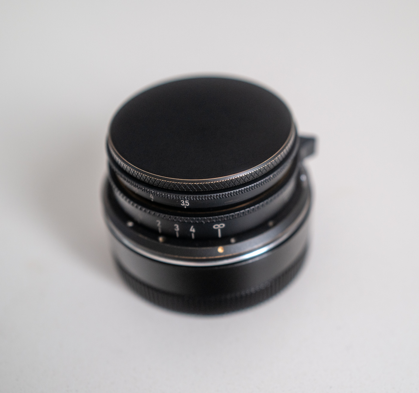

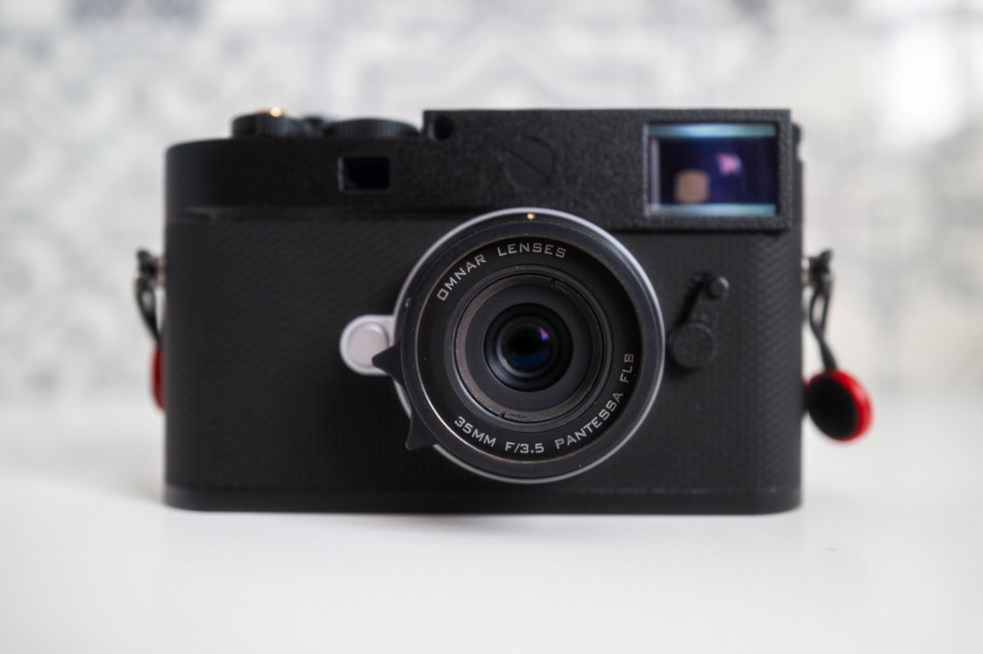

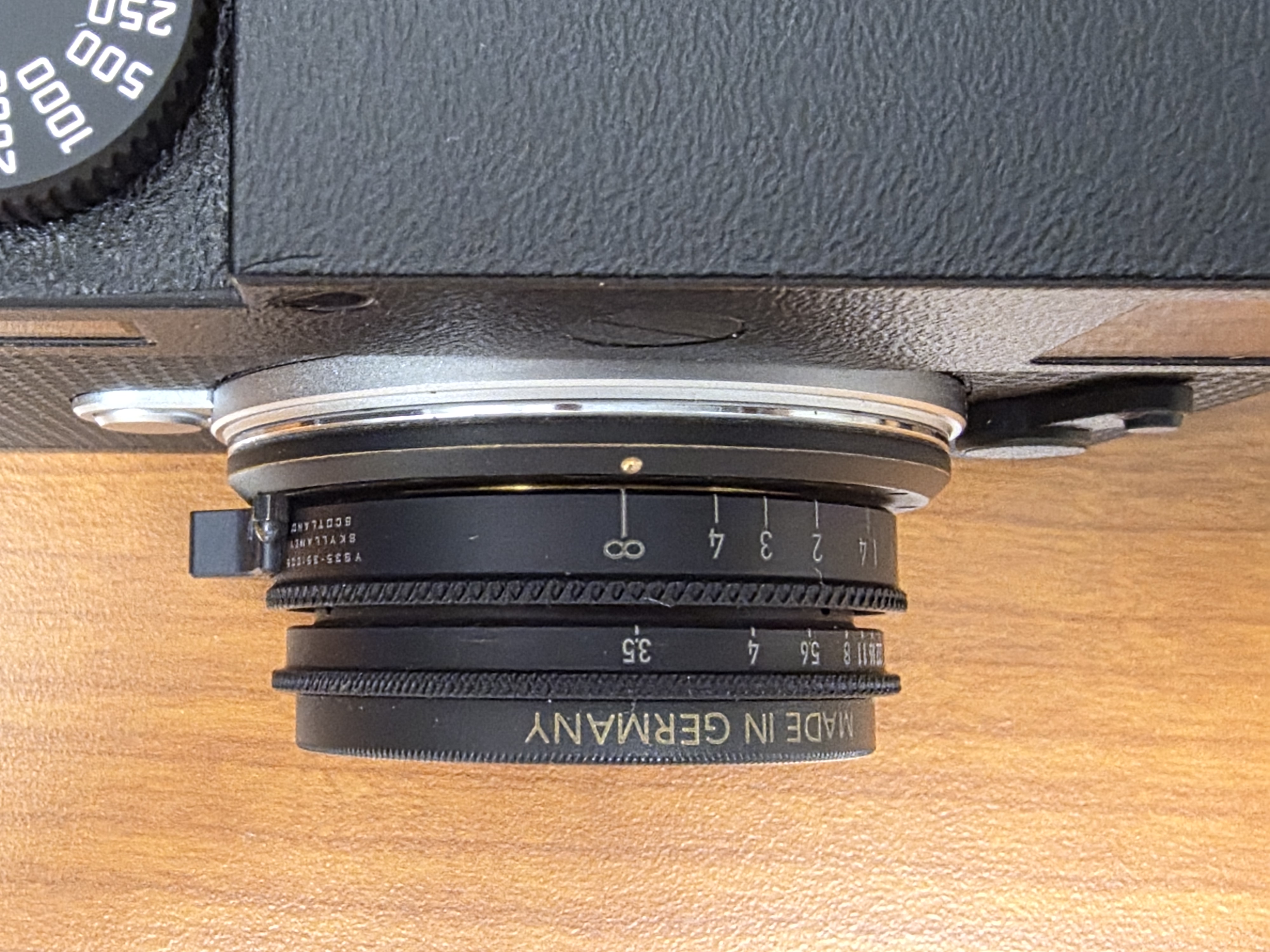

I was able to acquire one of these very unique classic remakes from Omnar this weekend. Thought I do a progressive review. With only 20 made and MSRP of $2500, this probably is going to be a fun read for most rather than a purchase decision.
The Omnar 35mm f/3.5 Pantessa was originally used as a Tessar 3.5/35 lens by Carl Zeiss in the Yashica T, T3, T4 and T5 Super cameras. Some consider the T4 and T5 some of the best point and shoot film cameras ever made.

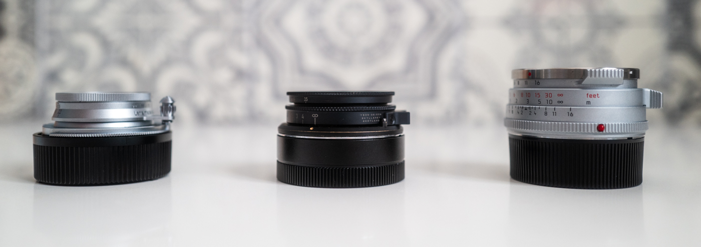

One of the unique traits of this lens is that it focuses down to 0.35mm making it a very versatile travel camera. When compared to the tiny Color Skopar 35mm f3.5 from Voigtlander, it's on a hair taller.
They also modified the optical formula to address focus shift and focus breathing using what they call Floating Lens Block (FLB).Tthe position of the optical block moves minimally within the lens housing when the aperture is adjusted. The result is the Pantessa remain accurate over the entire distance range from 0.65 meters to infinity. I can confirm that on M11.
The construction of this lens is exquisite. Every part of the barrel, even the front and back caps, is made of brass. The front cap is a screw-in type, so it's a bit annoy to remove. Since it takes E39 filter, I would just put a UV filter on and never mess with the cap.
One quirk with this lens is the aperture ring. To adjust f-stop clicks, you have to put focus at infinity. There is one single golden marking at the base of the lens which is used both for focusing and aperture adjustment.

Anyone interested in this lens? It has same specs as the wonderfully small CV Color Skopar 35 f3.5. However, the Pantessa can focus to 0.35m vs typical 0.7m for the CS. The price is outrageous given how great the CS already is. It certainly is a very intriguing lens for those of us who appreciate a lens cap 35mm.
https://omnarlenses.com/product/omnar-35mm-f-3-5-pantessa-flb-ys35-35flb/
Perhaps it didn't quite take off? It mentions "We anticipate all lenses will be ready to ship by the end of February 2025", which makes me wonder what happened there.
As you mentioned, the Voigtander 35/3.5 seems to be the better corrected lens (I consider it APO) despite being smaller and lighter. Still, I can see how someone might be after that Tessar-style rendering and be willing to pay for it. It does seem like a very limited production, if it even made it out at all.

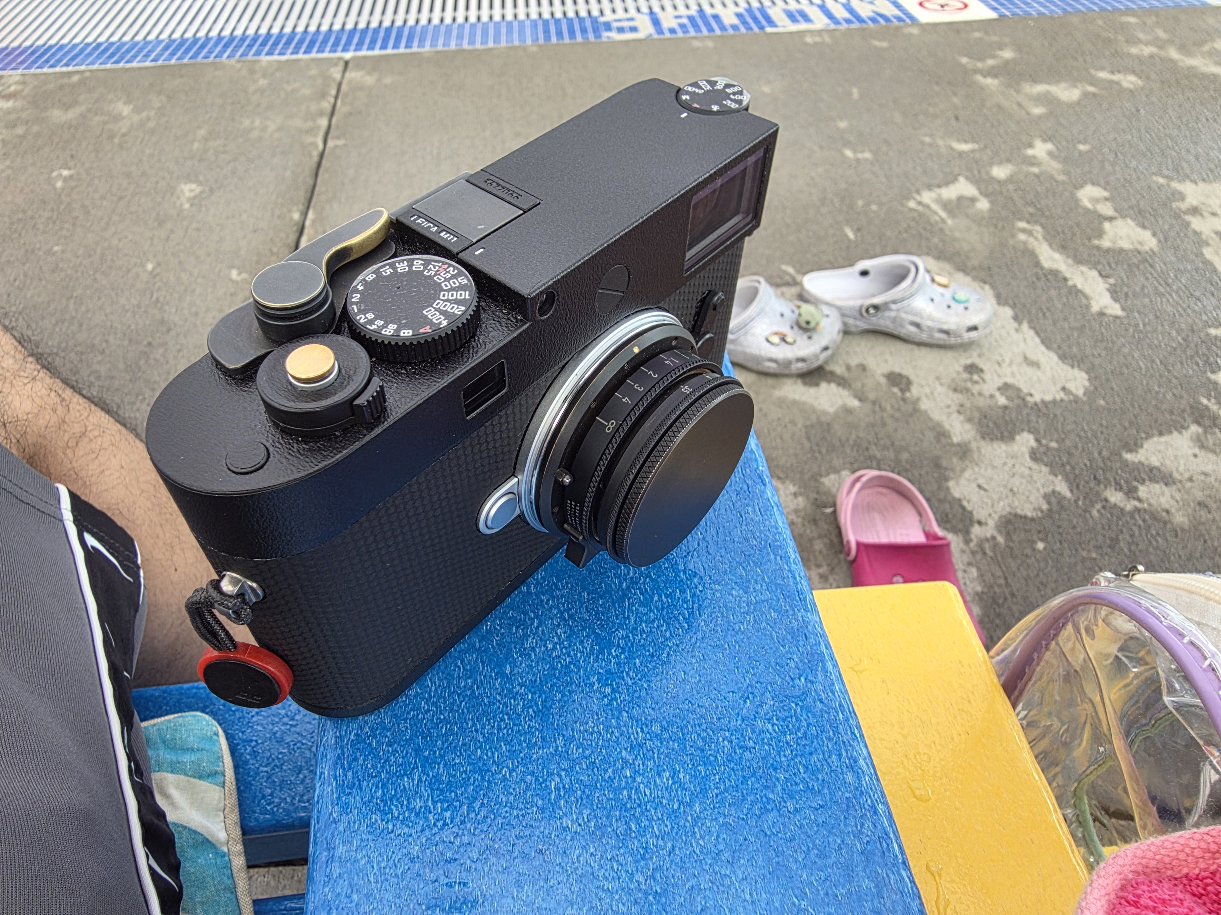

I haven't had time to really do a lot of shooting, but we are going to Vancouver this weekend, and I'll try to put it through its paces. I'm going to replace Color Skopar 35/3.5 with the Pantessa given it's more versatile. A famous ramen chain called Marufuku opened next to my work. If you are sitting down to get a food shot, you don't need to stand up to with its close focus capability.
There is some vignetting wide open. It is very sharp across the frame even wide open.

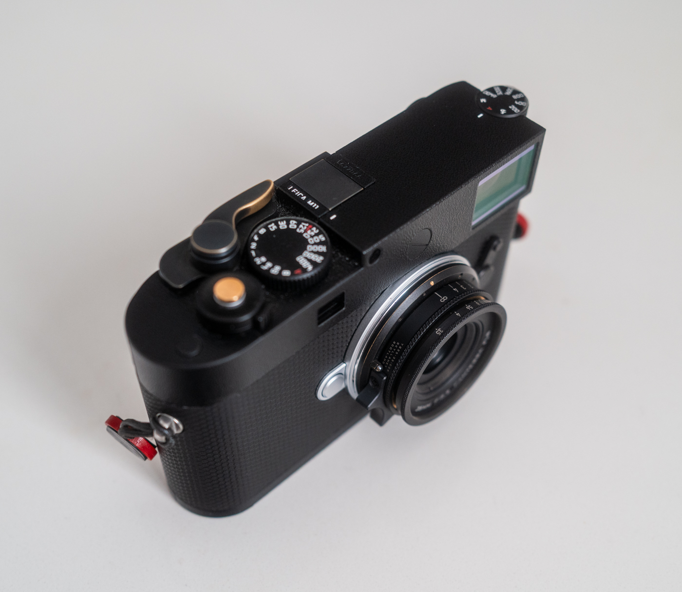

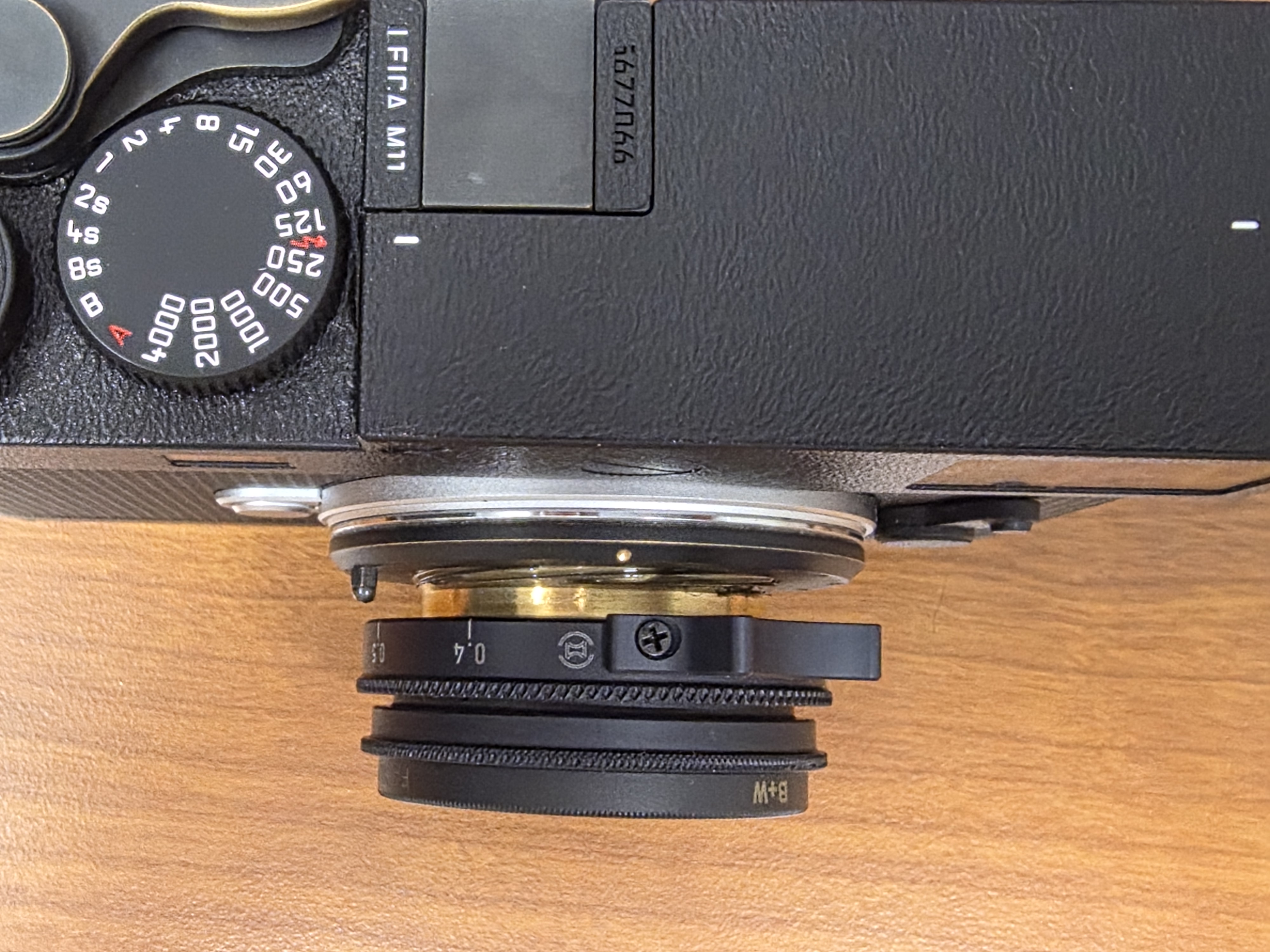

Some additional points on the build, the lens is all metal, matte black. It pairs with a black M perfectly. You get a real focus tab with is an upgrade over CS 35/3.5. The focus is smooth but stiffer than all my other 35s. The focus throw is about 100 degrees from infinity to 65mm RF coupled, but goes to like 200 degrees to the extreme close focus. It also extends quite a bid at close focus revealing the inner brass construct.
I'm pretty thrilled with it as my new EDC. It blends in really well for street shooting.

A very interestingly designed lens! If I understand you correctly, each time you want to change the aperture, you first have to turn the focusing ring to infinity, then change the aperture, and then focus?

It's an interesting look for sure. I'm not sure if it's going to trap dust. I won't be taking this to the beach.
The infinity marker serves as the aperture marker, so you just need to align the aperture with the infinity marker. You don't need to actually focus to infinity every time. When you move the aperture ring, the focus ring moves a little too, so I have to set aperture first.

Thanks, now I understand fully. Not only interestingly designed but as mentioned, has an interesting look too!
