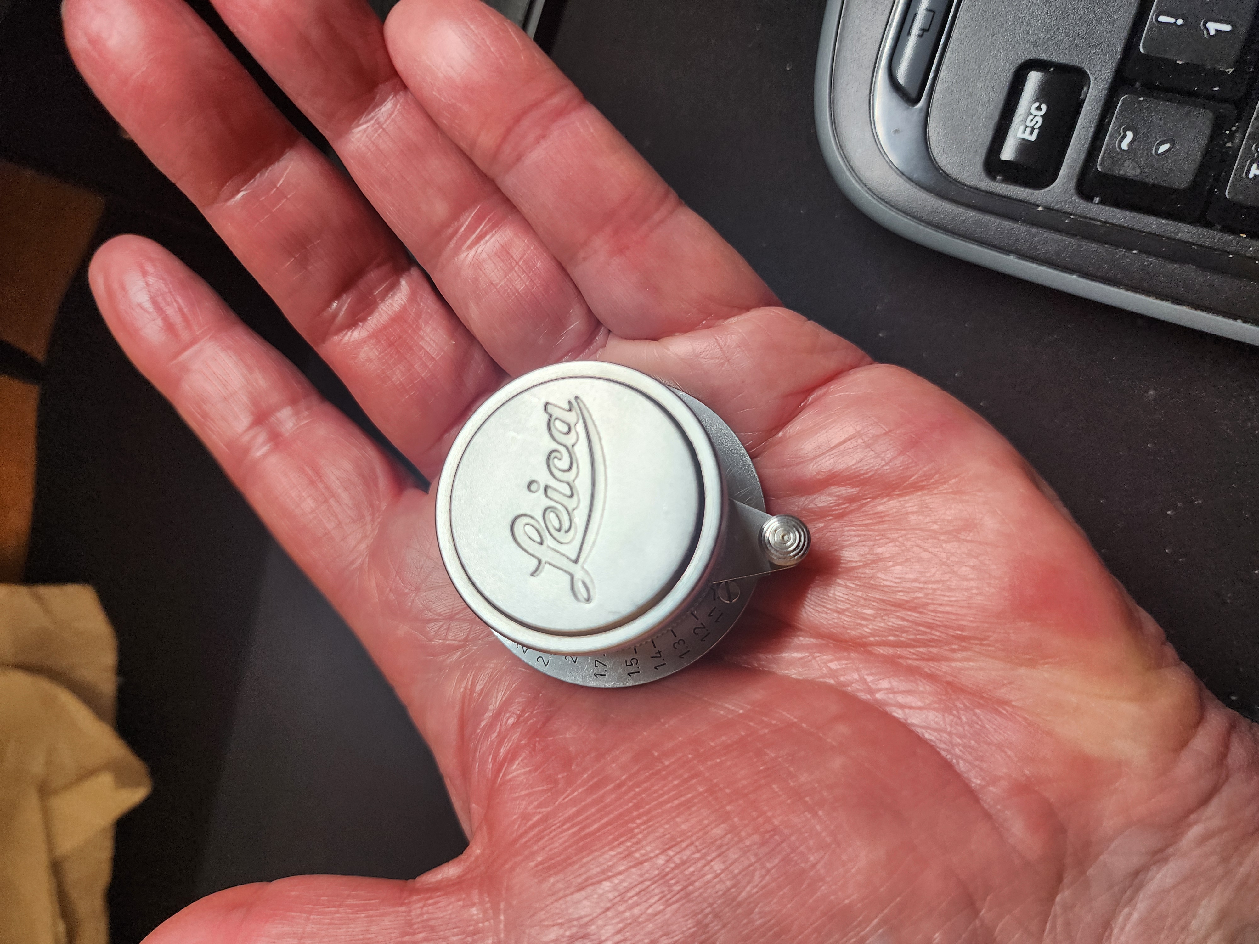

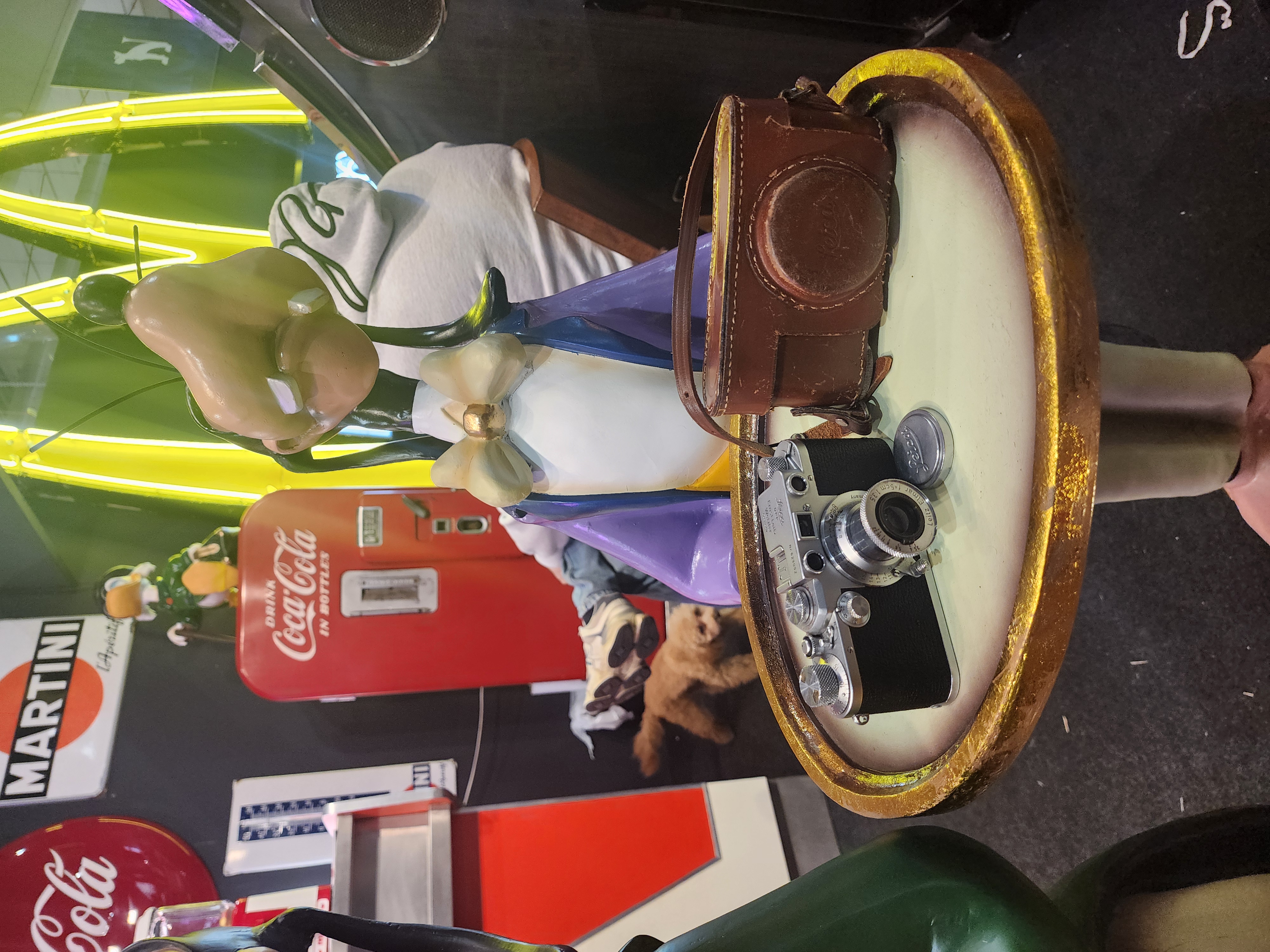

Yes it is true. I finaly succumbed and bought an antique Leica film camera today. I kept swearing that would never happen.
Parma happens to be the home of one of Italy's largest antique shows. I went this afternoon just to have a look around. At one booth I saw this Leica IIIf in amazingly good condition. It had a beautiful Leitz 5cm f/3.5 Elmr collapsible lens with original metal "Leica" cap, an a beautiful original brown leather "Leica" case. Although it was priced much higher and this guy clearly wasn't a camera dealer, I took a chance and made a low ball offer of $250 for the whole set. After some discussion it was accepted. So now I have it.
So, lots to learn about shooting film and old analog Leicas. I promisepd myself this would never happen. But it did....

You jumped in with both feet, rather than an easier M.... have fun and enjoy

Beautiful set, congrats! I hope you get a chance to try it out. I think you will be pleasantly surprised by how good this lens is.

Yes, rubberized cloth shutter. I inspected it closely and find no holes or tears. There is slight crazing in the rubber, but I am not anticipating trouble from that at this time?
