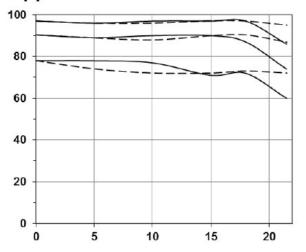

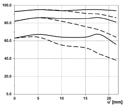

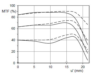

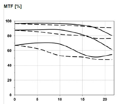

Zeiss went through this 'bigger is better' phase in the mid-teens decade, a misguided move in a newly mirrorless world. It saw the Otus 55mm weigh in at 970g; the Milvus 50mm f1.4 loaded the scales at 875g. Belatedly they retured to their senses, and we see the new Otus ML 50mm diet down to a not entirely svelte 720g (in Z) but they were heading in the right direction, at least.
Another thing that changed was design complexity: the Otus 55mm was a super-specified in glass choice 12/10; the Milvus 50mm is 10/8; the new Otus ML 50mm is a Sigma-esque 14/11. So if you like the images it produces, you get a very modern high end fast fifty at a nearly reasonable weight.
The Otuses on-axis MTF wide open are very close to parity, as it is at f4 (not shown) where both lenses deliver 83% of 40lpmm. So the two Otuses are very much out-and-out performance lenses. The Milvus seems to me to have been their pro portrait lens, for studio usage. See how flat its lines are, while being at very low values. That's an extremely well-corrected lens out to the wide edge. From f1.4 to f4 the 40 lpmm figure pretty much doubles from 40% to a very acceptable 75% and with the same ultra-flat MTF line pairs.
Bottom Line: Zeiss never wanted to build high resolution (lens contrast) into their fast portrait-capable lenses, with rare exception. The Otus 100mm is a contender for best 100mm lens in 35mm format ever made, I do agree it stands above all other Otus lenses. Images from the 100mm are exquisite, despite the very high MTF at f1.4. See below for 100mm Sonnar near-perfection in MTF form. One of these at 500 grams would be great.
Otus 55mm 10-20-40 lpmm at f1.4
Otus 50mm ML 10-20-40 lpmm at f1.4
Milvus 50mm 10-20-40 lpmm at f1.4
Otus 100mm 10-20-40 lpmm at f1.4
Mar 10, 2026 at 11:14 PM
