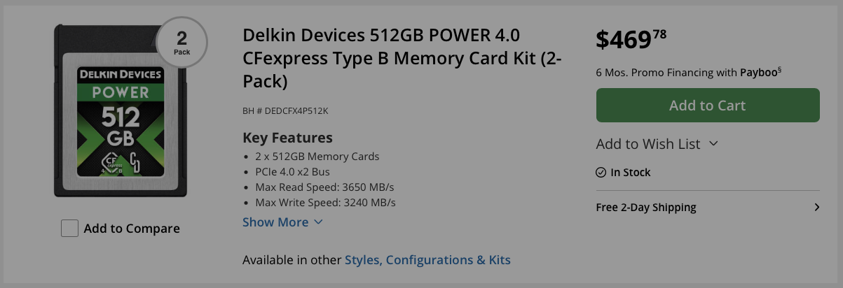

Here's what I would buy if you could find them for a similar price:

Why the Greens and not the Blacks?

It looks like he’s on a tight budget and I was already blowing it out with the greens.
