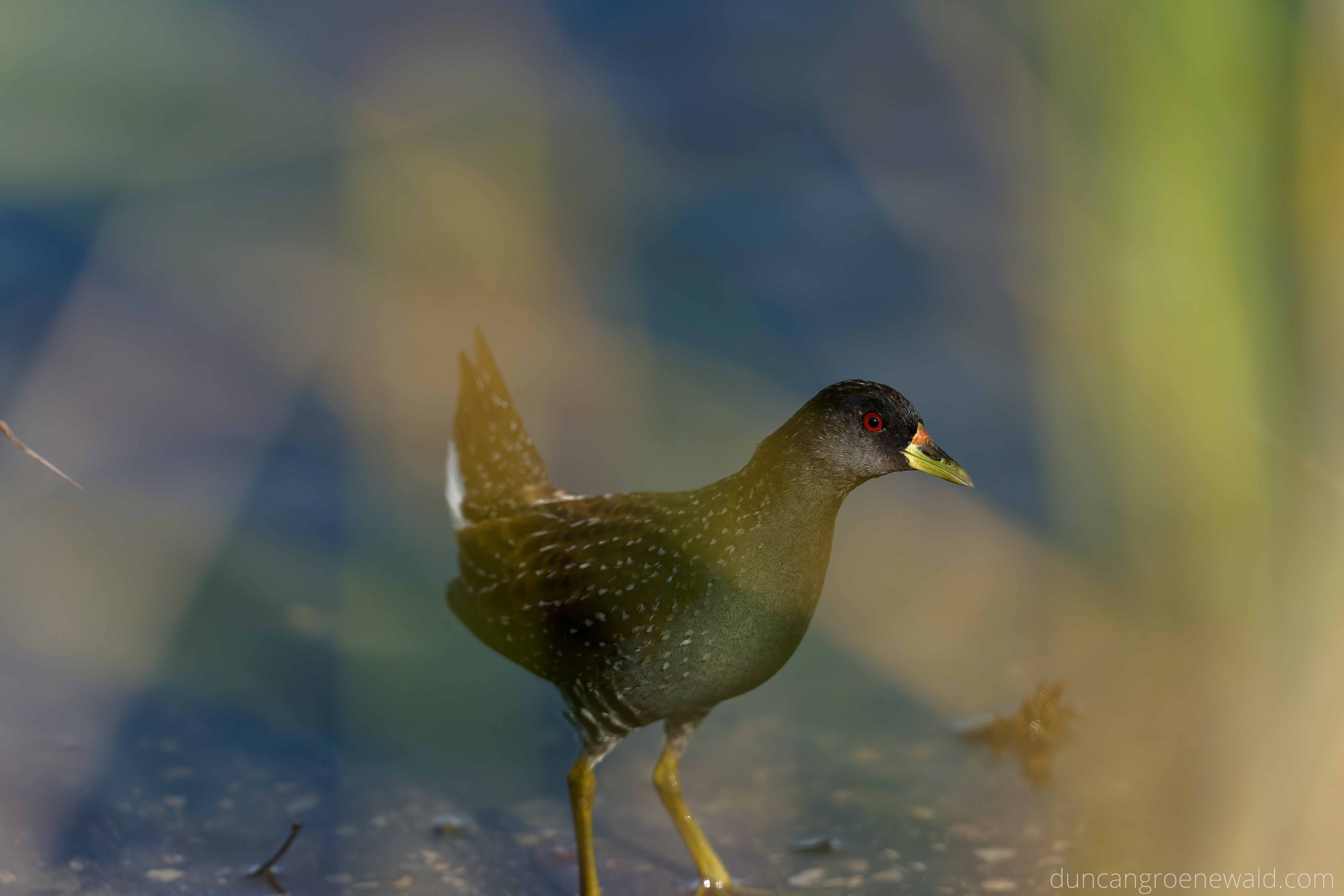

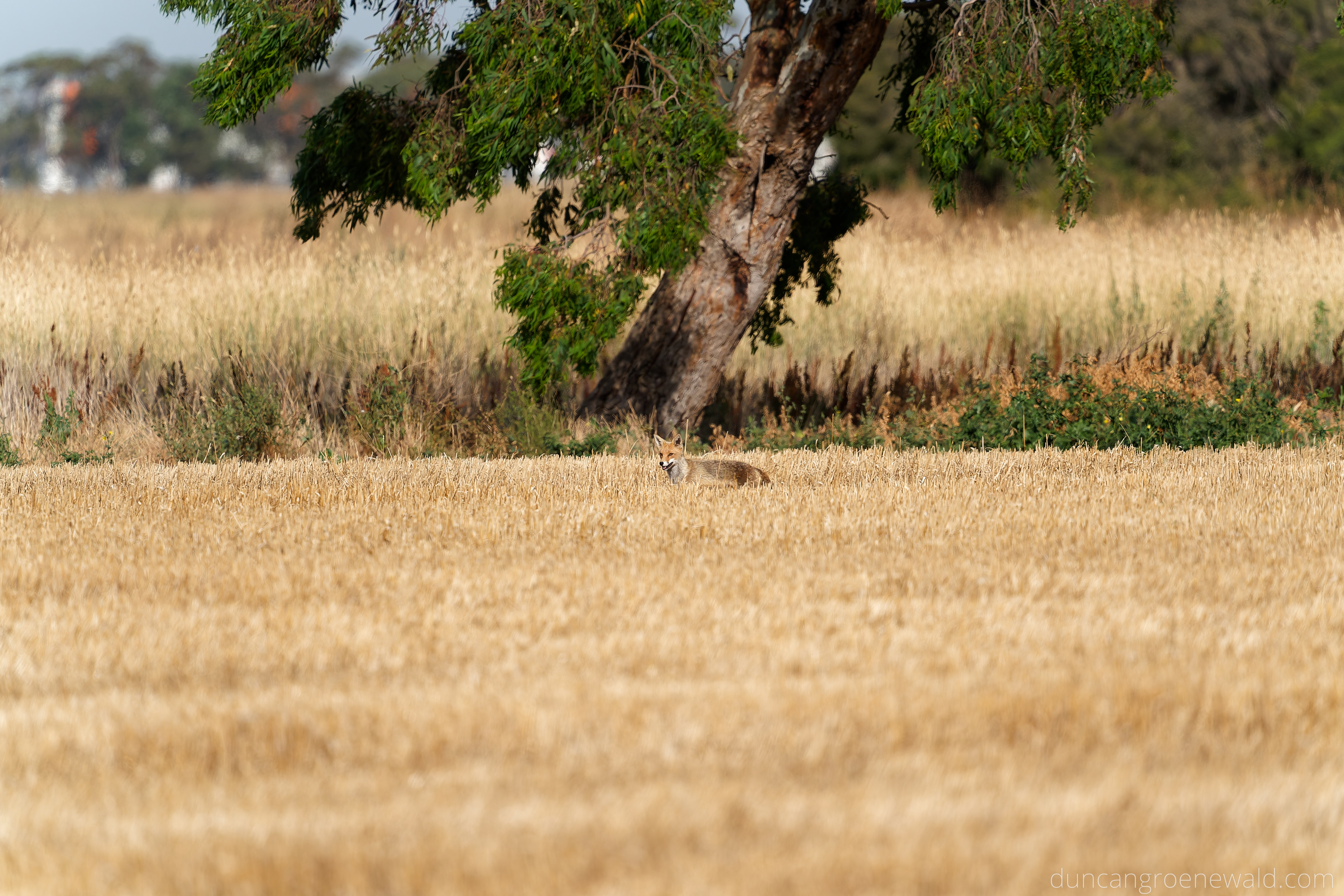

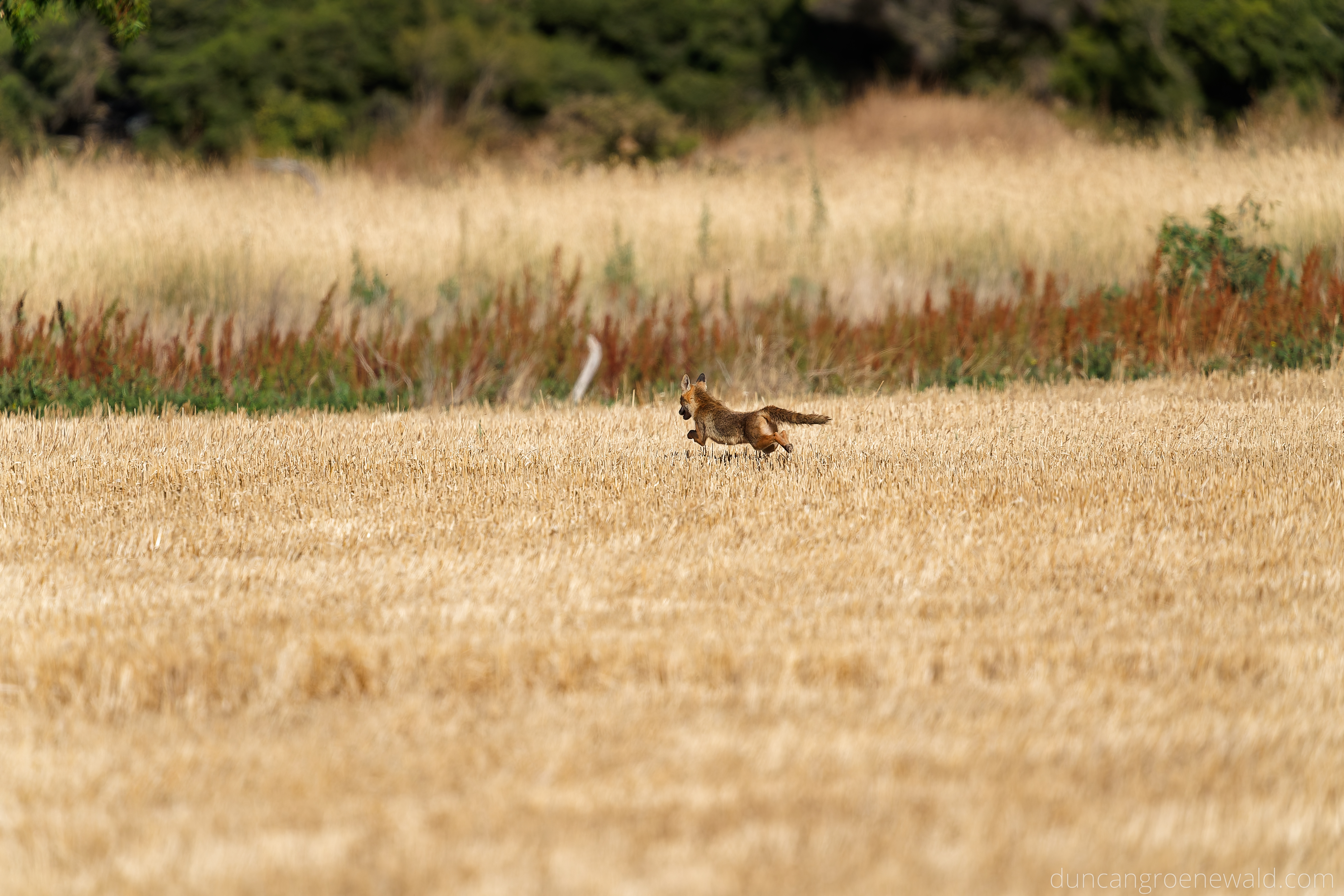

As for the subject detection/AF in tricky situations - in my experience the Sony's work great - and with the ability to program two back focus buttons use of a single focus point is always instantly available.
Since switching to Sony it's been rare to have to think about subject detection and autofocus since the camera's take care of that. It would be a long time since I have missed an opportunity because of a Sony camera's subject detection/AF failure.
This guy, a feral fox, appeared out of nowhere while I was photographing birds and the images were taken in Bird detect mode - I didn't think to switch to Animal or Auto. Strange to see one in the daytime as they're usually very timid.
Note that these are all taken with A9iii.
