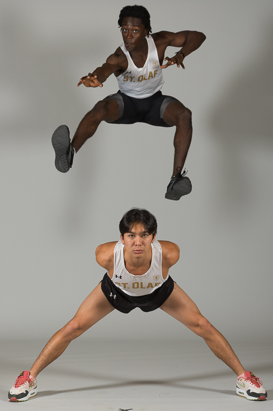

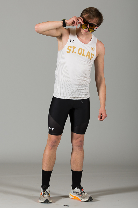

I have uploaded a couple of examples from my most recent shoot where I thought I could have benefited from larger softboxes.
Thanks in advance.
More than full body portrait.

Full Body.
  Canon EOS R3    EF70-200mm f/2.8L IS II USM lens    120mm    f/6.3    1/160s    100 ISO    0.0 EV

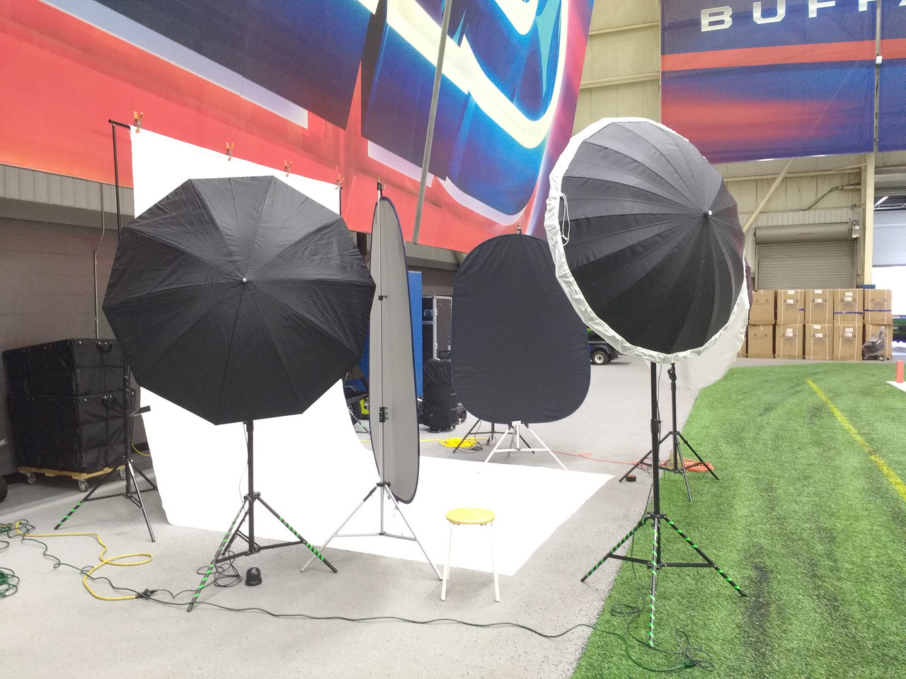

Here are a couple photos of an on location shoot I did some years ago. The front lights were Paul C Buff Einstein. One in a 64" soft silver PLM with diffuser and the other in an 86" soft silver PLM with diffuser. The background lights were each 60" white umbrellas with black backing fabric that were flagged to prevent spill on the subject. Those might have been Photek Softlighters, but also could have been something generic I got off Amazon. For this shoot the background didn't have to be perfectly lit as the subject was going to be cut out anyway.
Another tip, if you want a clean floor portion of the image, get a very large sheet of plexiglass, or something else glossy that is highly reflective. The background will reflect off it and be a lot cleaner looking than just paper or fabric under the subject's feet.

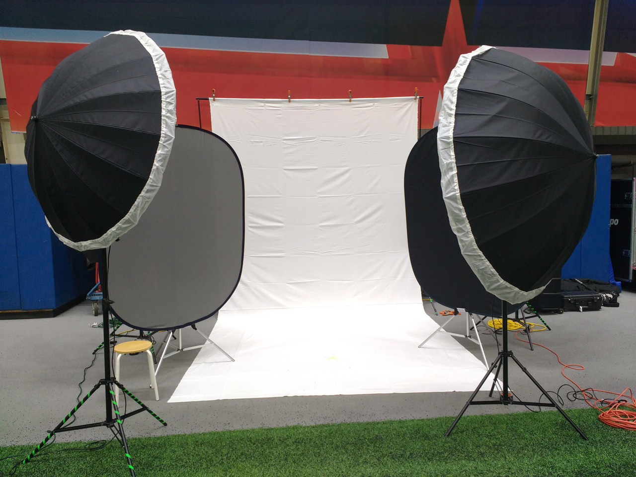

2 7' silver umbrellas with diffusion, in front, up high, 45 degree down.
by Zack Pollak, on Flickr

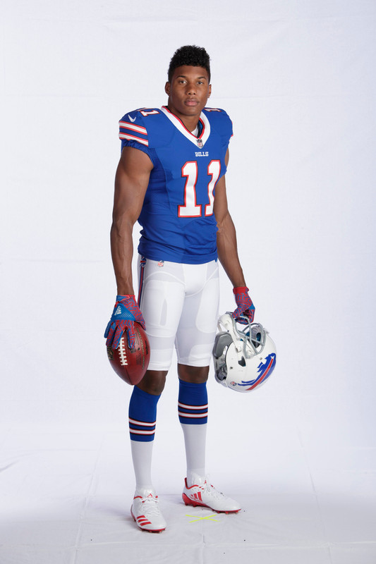

One 7' silver with diffusion camera left, 2 white 7' left and right of subject to edge and fill backdrop.
