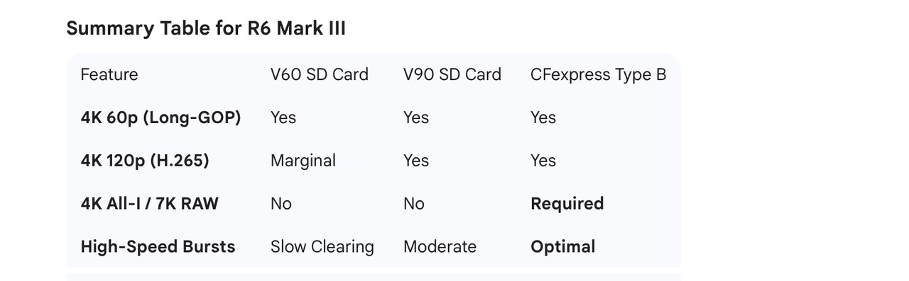

Here is what AI says about V90 vs v60 with R6III:
[it seems accurate to me. Buy the v90 if you are going to use it for other than a backup to cfexpress. Eg if you expect to use it.]
He bought an R6Mk2 though.
