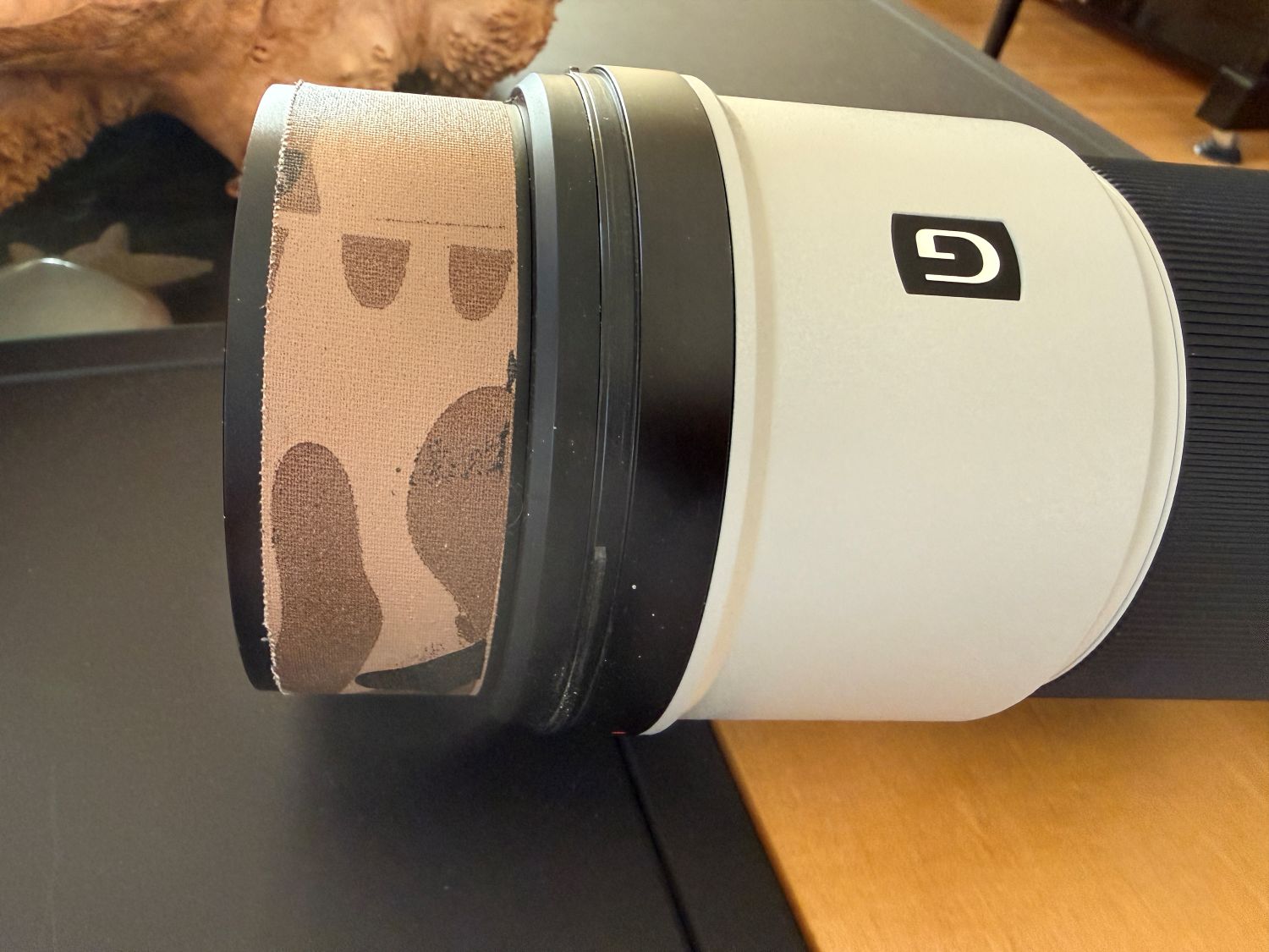

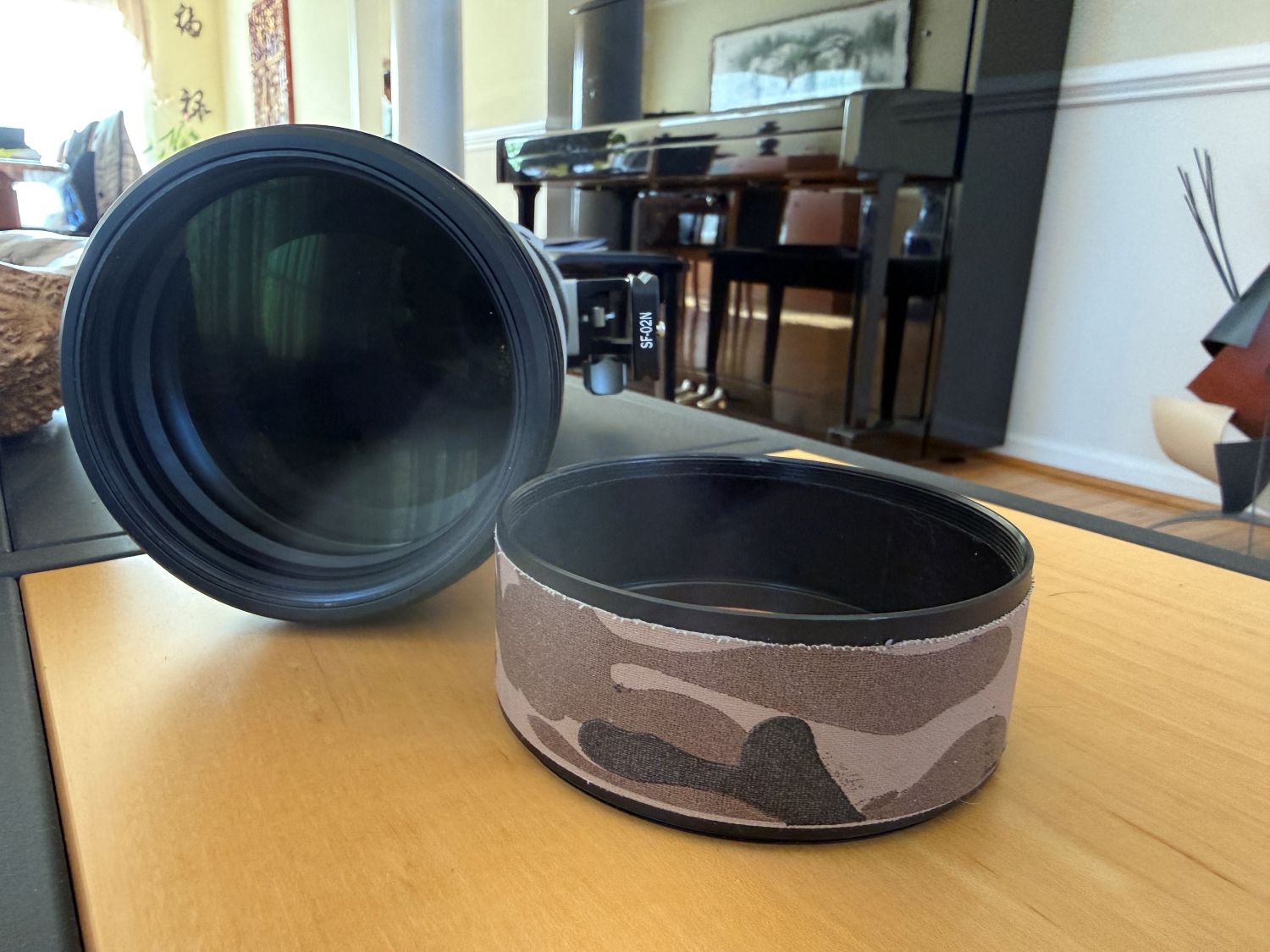

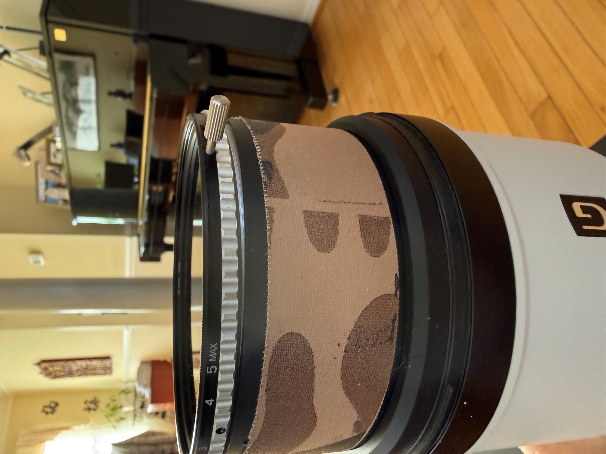

Yes, I leave the 1.5" short metal hood on the lens almost all the time. The metal hood has thread on both ends. It's screwed onto the lens. If I need to use the VND, I just screw the VND onto the hood. If I shoot on a beach, I would put a UV filter on the lens, then the metal hood on the filter. I guess I could just put the UV filter on the hood too.
I use those short metal hoods on my 70-200 F4 GII, 100-400 GM, 200-600, 400-800. It's so much easier than the Sony hoods. If I put a CPL on the lens, then screw the hood onto the CPL, I can just rotate the hood to get the desired CPL effect. So much easier then messing around with removing/attaching the Sony hood. Since I leave the hood on the lens, it does add 1.5" to the total length of lens as the metal hood can't be put in a reverse position.

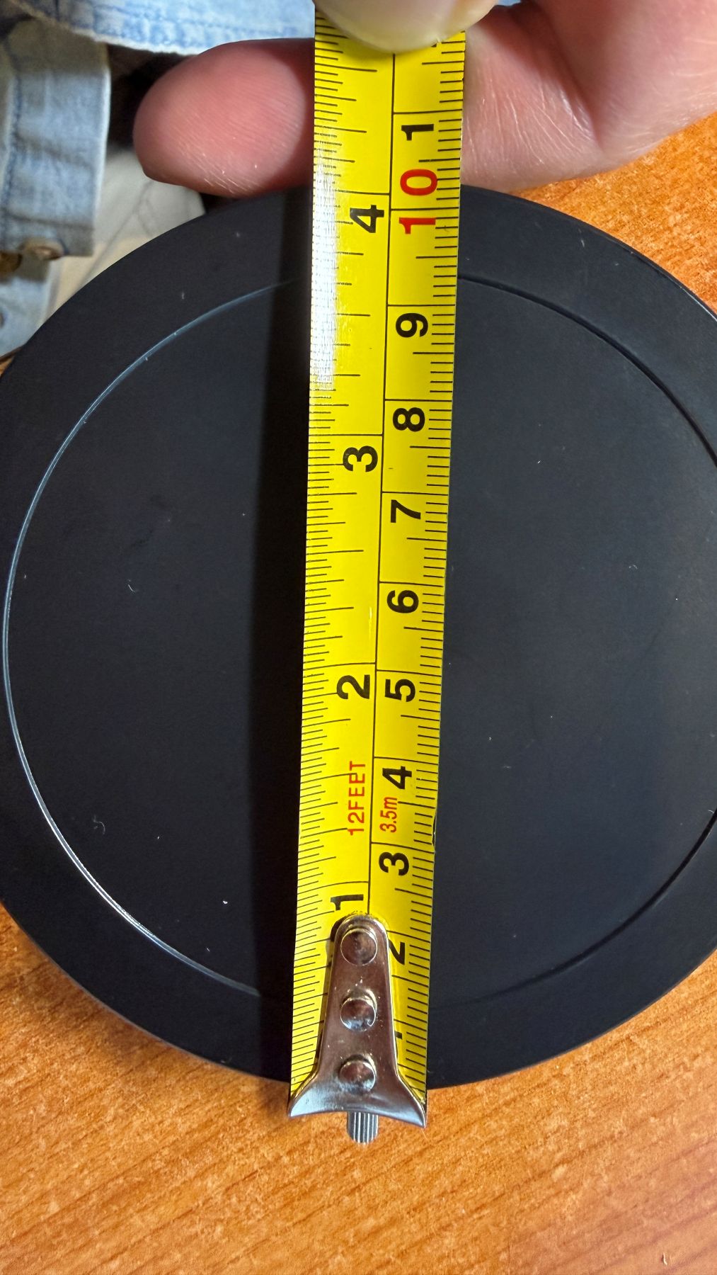

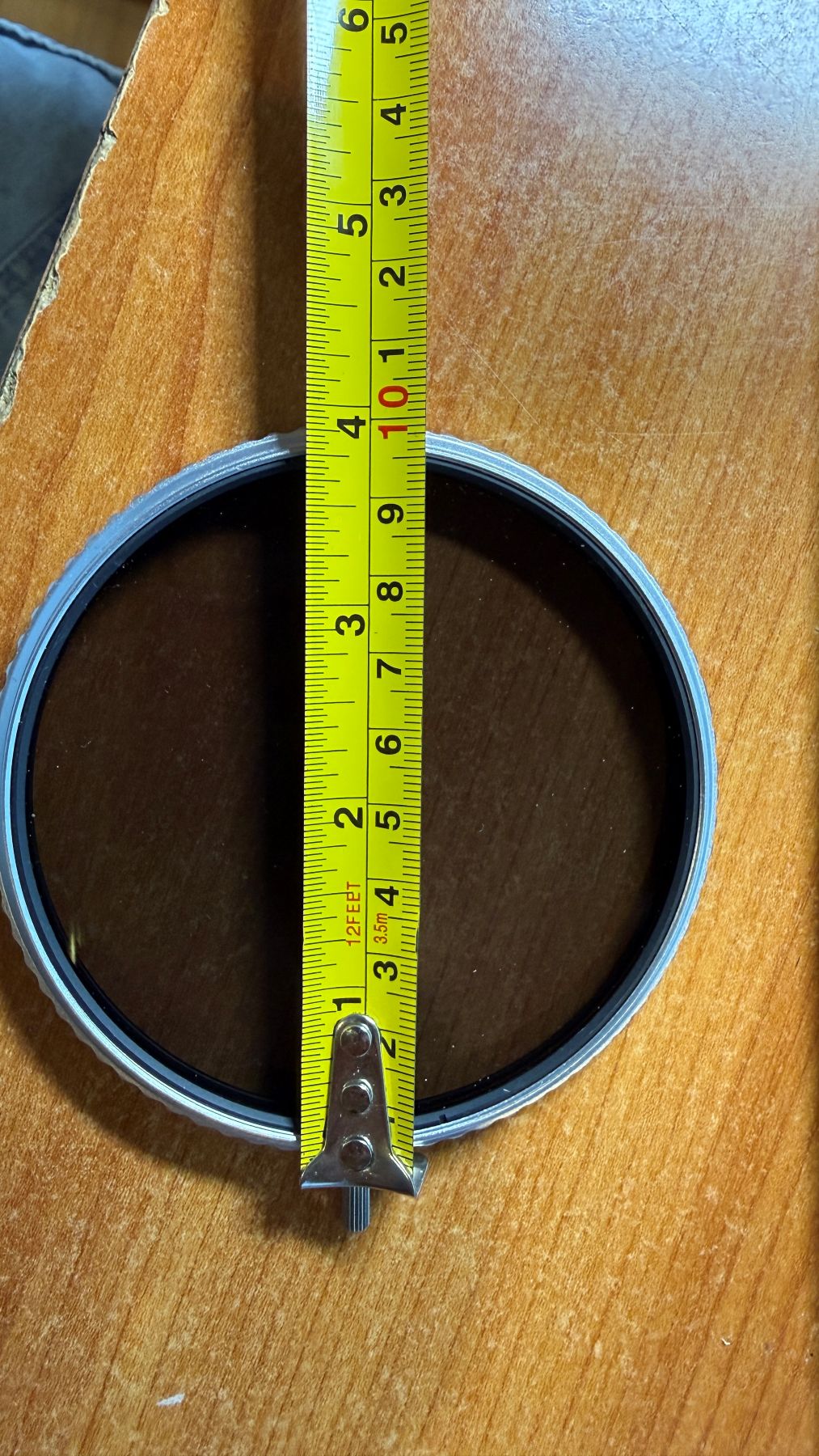

Thank you so very much for the photographs and the link to purchase the lens hood. Sounds like this might be a possibility for me. Might I ask one additional piece of information. Would you be so kind to measure the outside diameter (not the filter threads) of the NISI 95 mm 1-5 Stop VND.

Without the cap, the widest part of the filter is the silver colored ring, it's about 4", with the filter cap, it's probably 4"+2mm.
The other option is, screw the VND filter directly onto the lens, then screw the short metal hood onto the filter, you can rotate the filter without the hood getting in the way. I have done this with UV filter and CPL filter, but not the VND filter. I don't see why you can't, But that requires removing the hood first and putting it back on. I am not a fan of all these steps.

Thank you again for taking the time to get this measurement. I am beginning to agree with you about having the filter on top of the lens hood. I have never used a filter on the end of lens (or on a lens hood) without some kind of protection. Tell me, with the filter on the outside of the lens hood, do you feel that you lose contrast or get flares with this configuration?

You are welcome. Ref. your question, sometimes I wonder myself too. Because like you noticed, the filter is directly exposed to the light, without a hood providing shade, also placing the filter on the hood instead of on the lens, increases the space between the front element to the filter. I don't know if this increase of distance between the front element and the filter will cause some issues. I haven't used the VND much, so I didn't really notice the possible negative effect by placing the filter on the hood. I will do a test when I get around to do it. I have so many tests I wanted to do for months but I am just too lazy.
If placing the filter on the hood instead of placing it on the lens induces negative effect, I will put the filter on the lens and screw the hood on the filter, that way I can still rotate the filter freely and have the hood's protection too.
