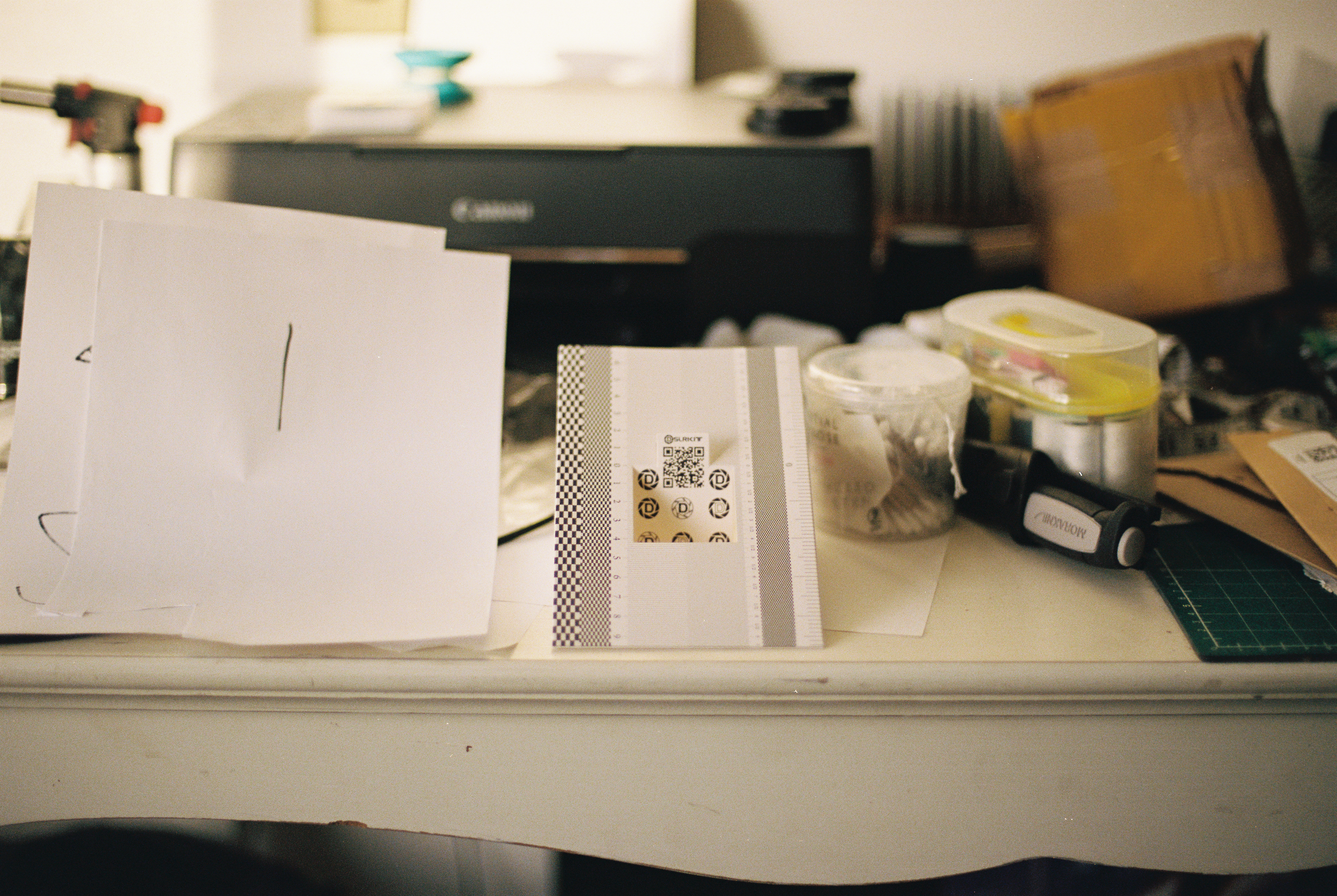

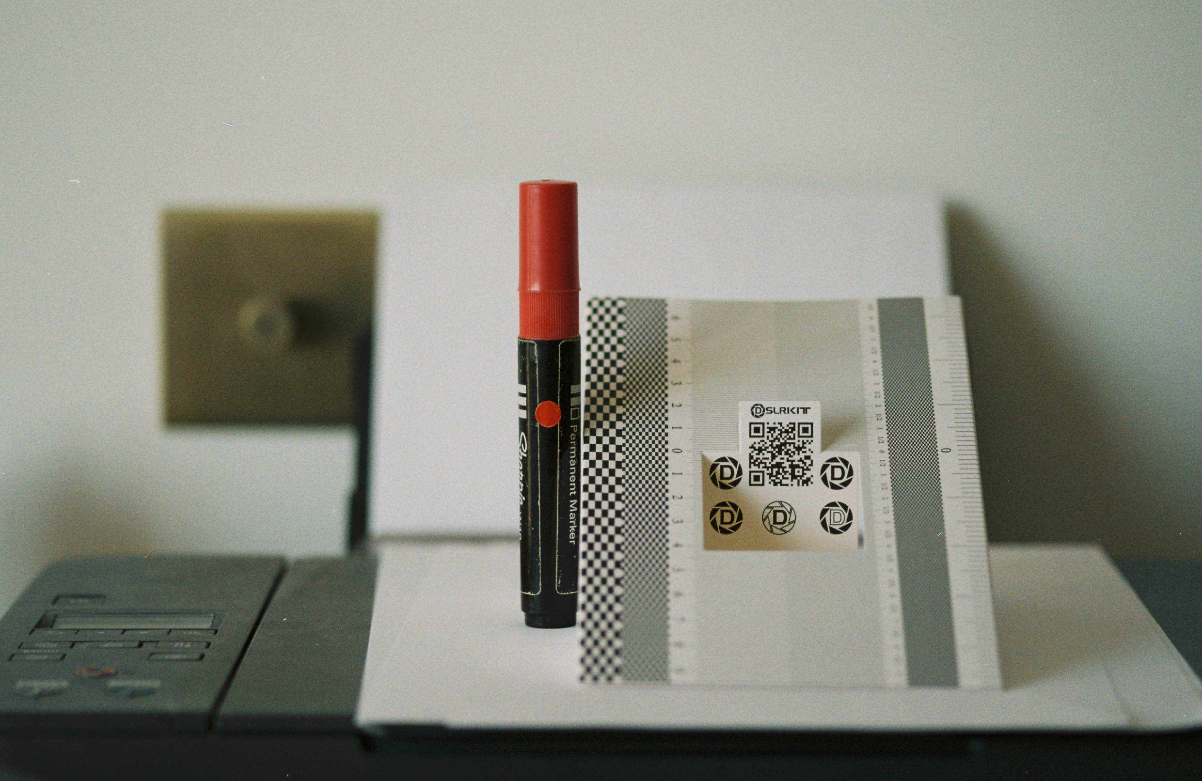

Hello everyone. I got my first film camera recently, an fm2n.
I shot my first roll and saw quite a few photos had significantly missed the focus.
I figured I need practice, I got a diopter lens correction, stopped it down to f2 for portraits instead of f1.4 on my 50mm and also did some test charts.
The next roll came back with a lot of them basically had the same thing, perhaps not quite as a bad but still pretty bad.
At infinity, it seems okay. And at longer distances it's less obvious (perhaps because I tend to stop down even further).
But at closer distances, this is often what I'm seeing:
The test charts are taken with a tripod. The center point with the QR code (ffs) isn't the easiest thing to align with the split-type focussing screen. But, when I try to focus on what seems to be in-focus in the images, and then look back at the qr code, it's clearly well off, I'd have to turn it substantially to get it back in focus, not some tiny miniscule degree off or anything like that.
Any thoughts or advice would be appreciated.

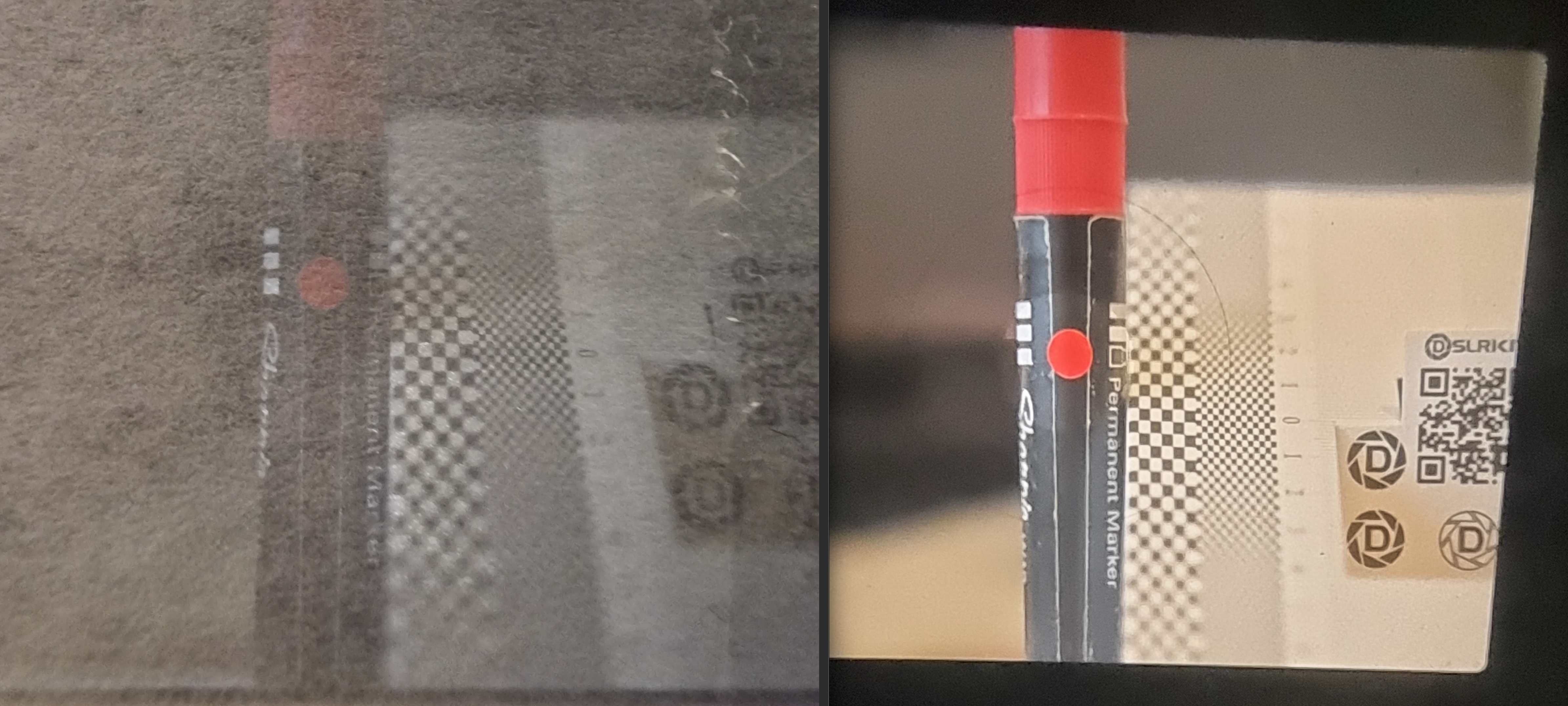

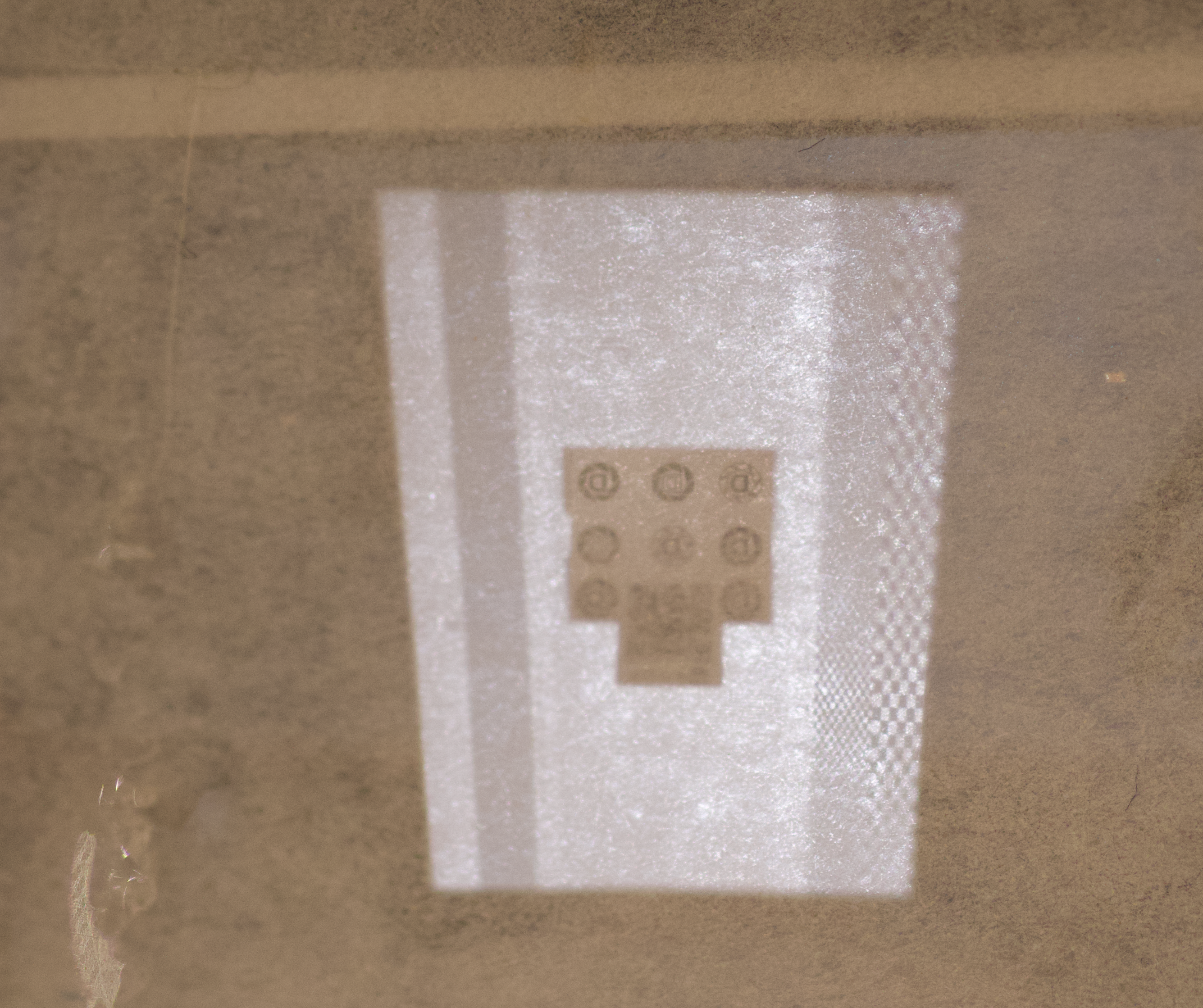

You can check focus without shooting a roll by using opaque Scotch tape as a poor man's ground glass, just stretch a few pieces of tape across the film gate and make the tape as taut as possible.
Once the tape is in place you can compare focus at the film plane with focus through the prism. You just need to lock the shutter open and open the back to look at the image on the tape. It helps to have a magnifier of some kind.

You know what thank you so much, I've been reading sporadic comments about ground glass and film gate and I just no idea what the hell they were talking about. It was like 15 years old posts.
Thank you very, very much, hopefully this is do-able for me. It was really putting me in a bad mood, I'm enjoying it so much otherwise.
I think I can hold down the shutter with bulb mode on with the fm2n, it might wobble a bit but hopefully that will work.
So ground glass is like the scotch tape but I wouldn't need to hold the shutter open and can re-use it to check with other cameras? It's something you can buy still?
--- okay I watched this video:
That's AWESOME. Thank you!
I don't think I can get glass thin enough to do this with, nor really any idea how I'd hold it in place exactly where the film is supposed to go but I'll give that tape a try!
----- it works!! Haha the image is upside down but that's awesome.

You're welcome! You can use a locking cable release to hold the shutter open.

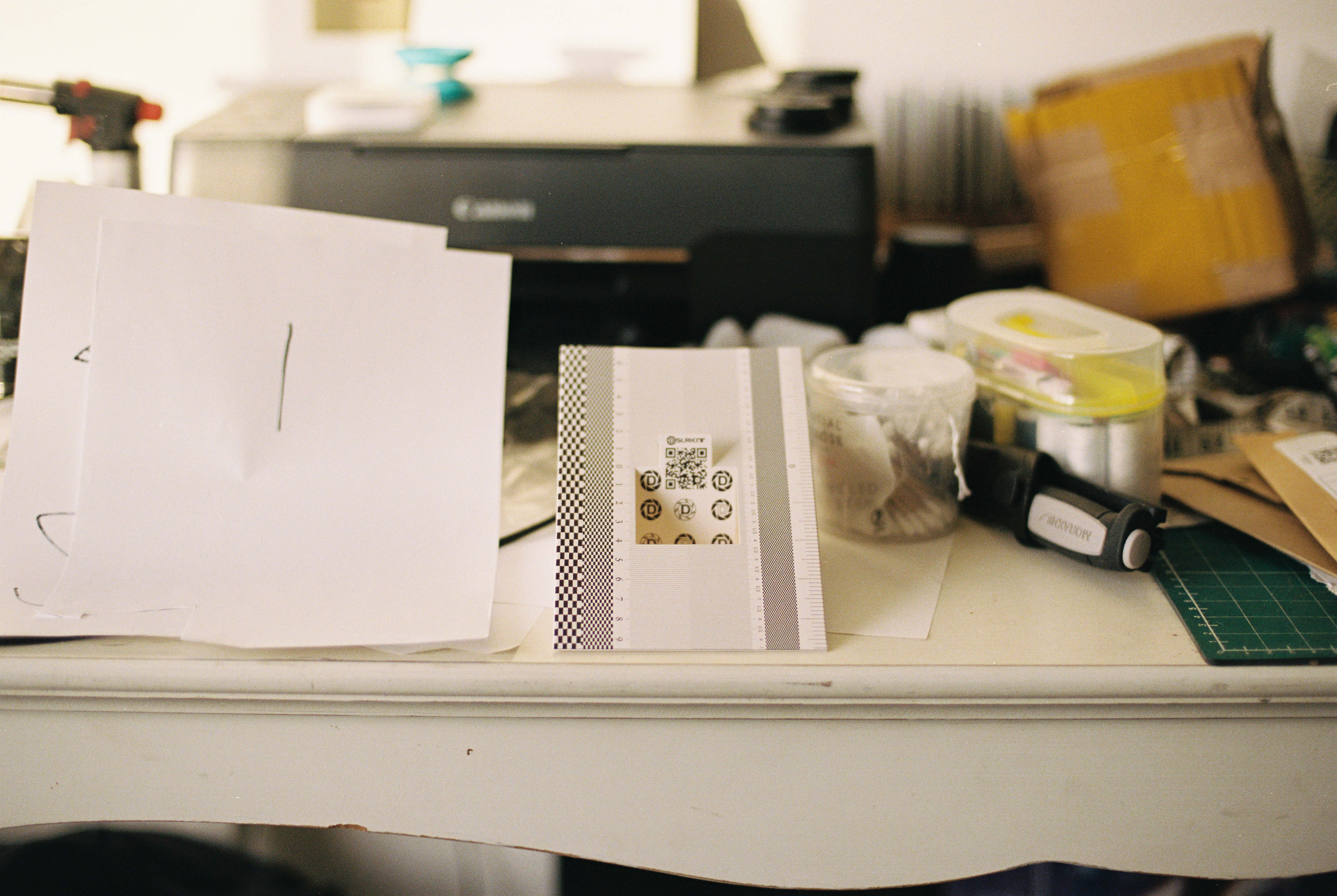

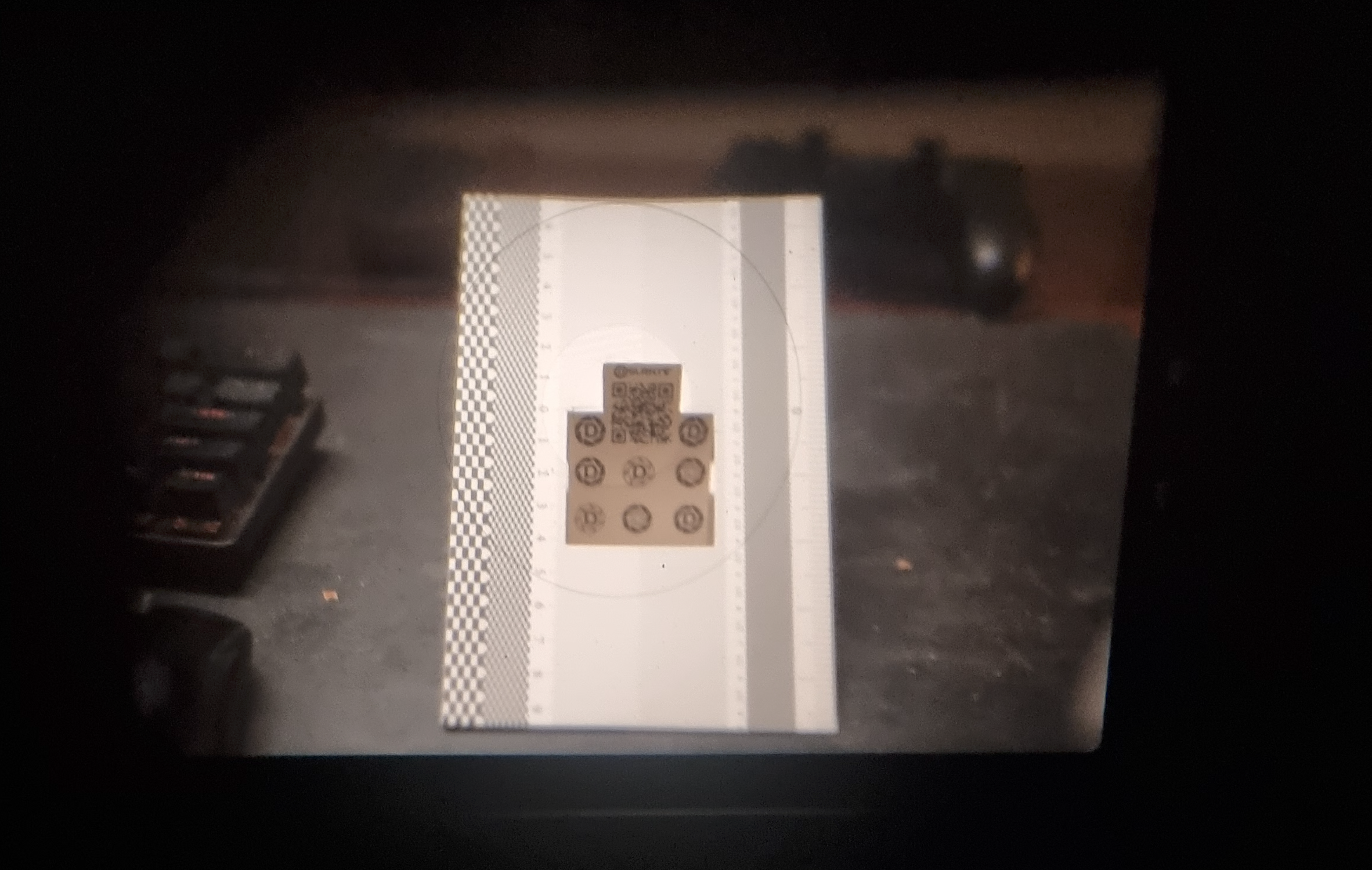

What I'm working with currently for anyone curious
A bit hard to tell but kind of looks okay... with what I focussed on.
Would be brilliant if just reseating the focus screen did the trick!
I'll make sure it's spot on as is with a better test tomorrow, the checkered pattern seems to show most clearly so maybe a coloured sticker there to focus on.
If it looks okay, and the next roll comes back with the same issue it makes sense that the film is either too far forward or too far back. I'm not sure if front focussing would be too far forward or back.
I heard people talking about the film pressure plate but there doesn't seem like anything is adjustable there as far as I can see... but they did talk about spring adjustment.
The mirror did look a little wonky to me to be honest. Like slightly tilted more on one side but I wasn't sure. Even the split screen line didn't see fully straight through the viewfinder.

^ thanks, I do try to keep logs! I had a suspicion it was focussing infront of where I aimed and saw in the viewfinder. I tried reseating the focussing screen and then tested here... I should have done the test before reseating the focussing screen to truly compare.
Seems to line up very well. I'm hoping the reseating of the focus screen helped a lot. If the next roll comes back with the same issue, perhaps something on the pressure plate to push it in a little as adjusting the mirror doesn't really seem easy enough for me to attempt it.
I understand the tolerances need to be incredibly tight so I'm not surprised to hear about how common it is. I wanted to use f2, f2.8 for people photos so I really wanted it usable at those apertures.
Thank you all. I used a Sigma 105mm f2.8 EX DG macro lens for F mount and some random scoth-like tape. Phone picture to take the snap using the voice "cheese" command with like a blanket to block the light and the camera in bulb mode.

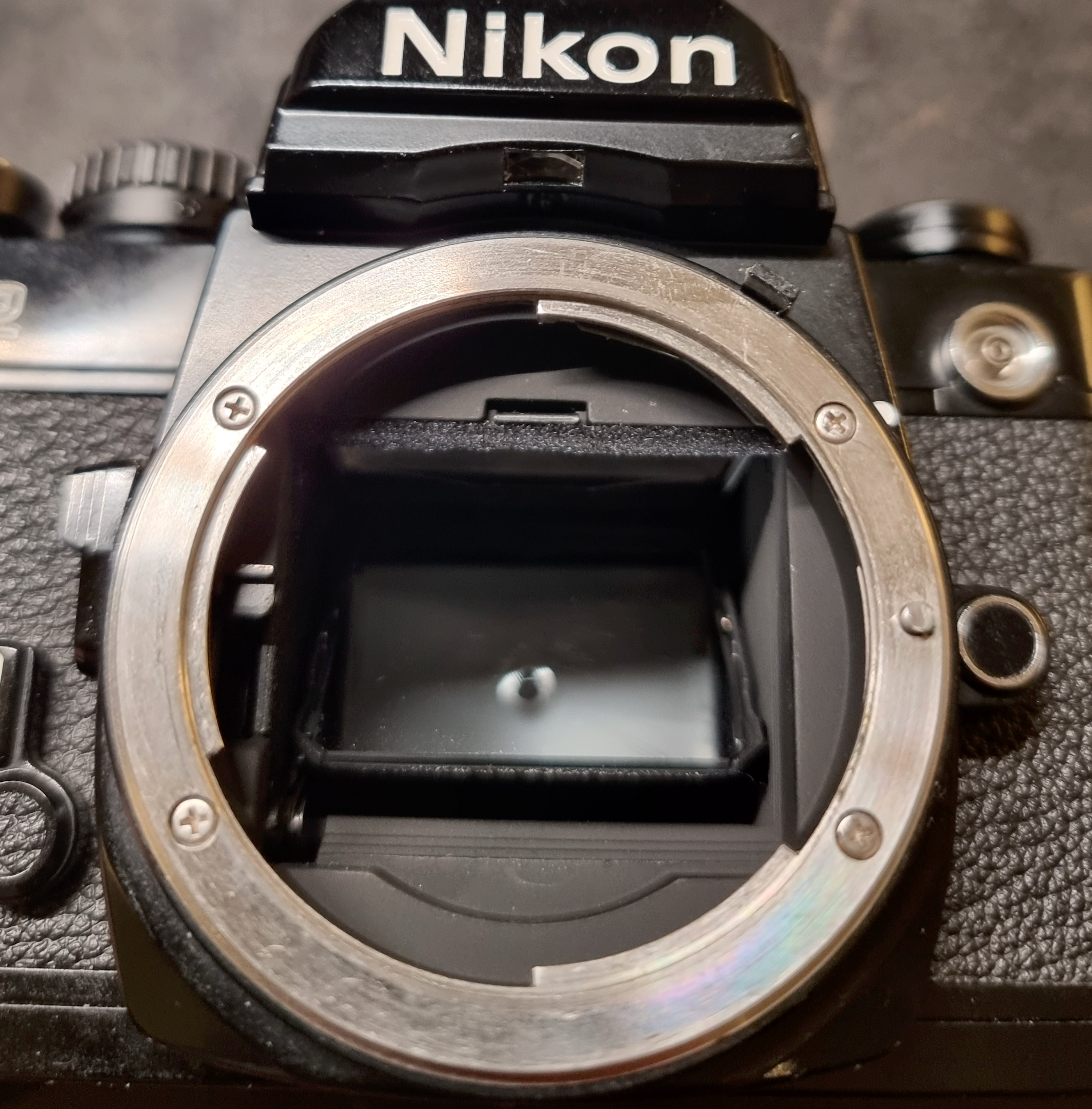

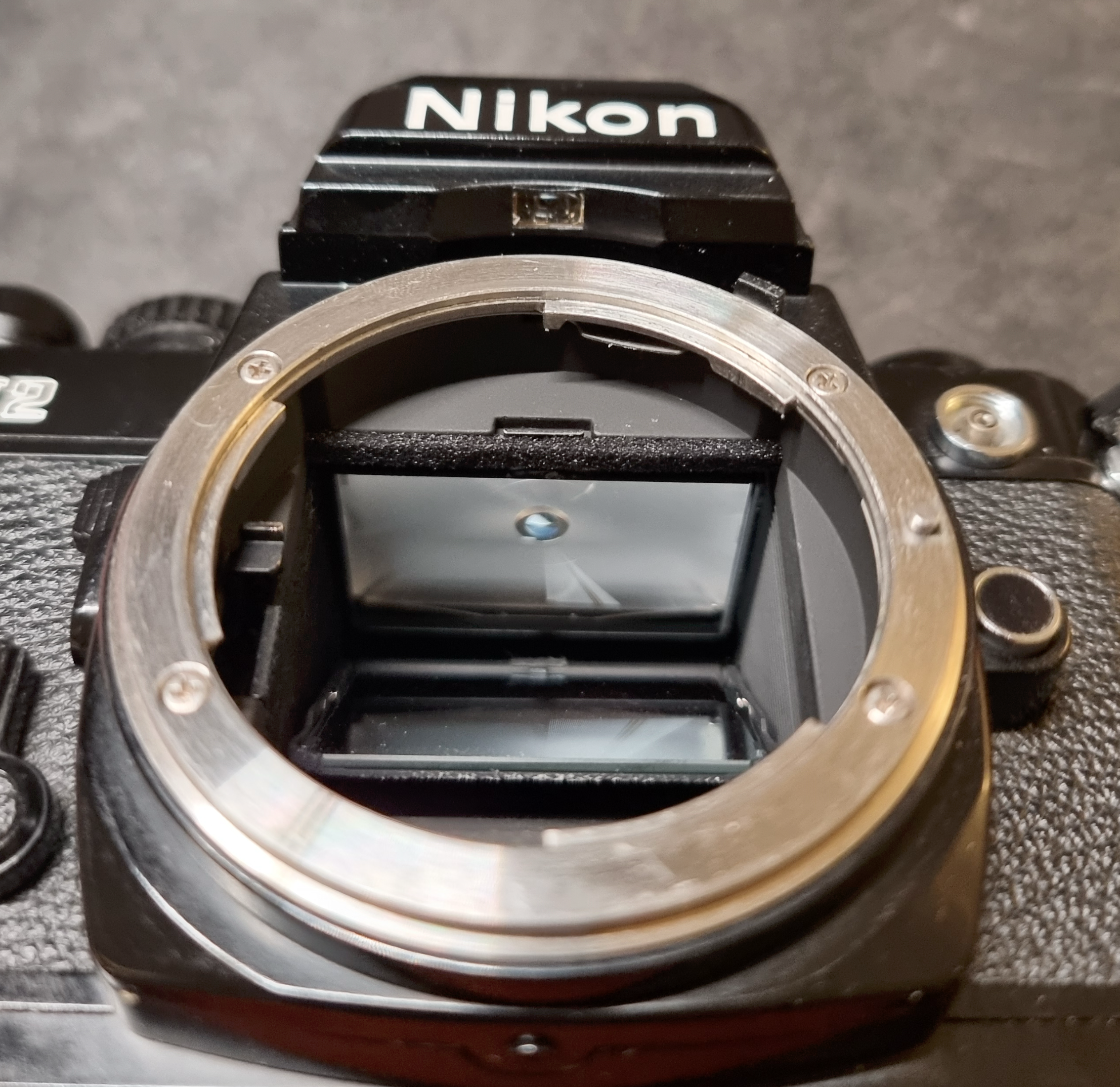

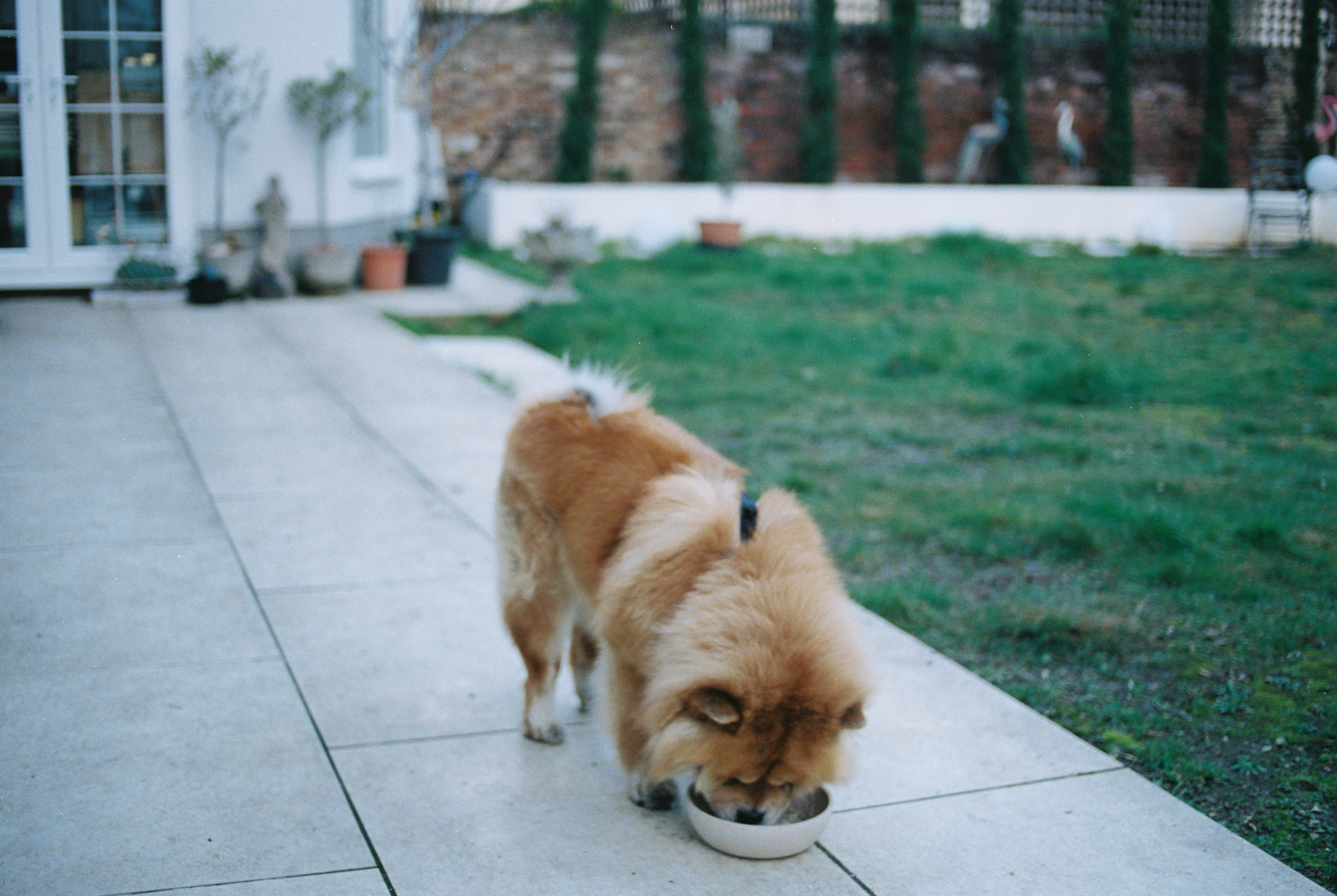

I bought a second FM2n to have a backup and be able to use different film since I go through rolls quite slowly.
And ... it's front focussing, massively.
It seemed just about passable for the first few shots, then about 2 weeks later when I got to finish the roll and get it developed every single close-mid range shot that was taken after the break was severely front focussed, most of the longer distance ones weren't perfect either.
On the plus side I know I want to shoot film. But I'm losing it with each SLR having focus issues.
If it's so fickle that it will just get loose (or whatever is happening) and I won't know until I get them developed...it's unacceptable.
Film is a hassle:
- focussing is a hassle
- film handling is a hassle
- scanning & colour correction if you don't trust the lab to get the most out of the shots or you want so save some bob is a massive hassle
- ... and it's costly.
I love the results but the camera needs to be dependable.
With this second fm2n, I tried reseating the focus screen but I see something odd: the prism that sits above the focus screen is a little tilted in the back-right corner. So when you raise the focus screen to close it back up it pops up a bit out of the frame as it's being pressed against by the prism towards the end of the pivot rotation.
It seems to close up normally as far as I can tell but you can't exactly see it once it's in-place.
My first fm2n focussing screen doesn't pop out with reseating, and the prism looks more straight.
You can't even adjust this stuff on the fm2n. It has a basically impossible to turn mirror pivot screw (good luck finding a driver for it) ... and that's it.
And no repair shop I can see here mentions focus calibration for an fm2n. I asked one about it and he was like "I've never seen an fm2n with focus issues". He specialises in the FM2n - but he also said you can't remove the viewfinder without replacing the meter circuitry too, which is wrong.
