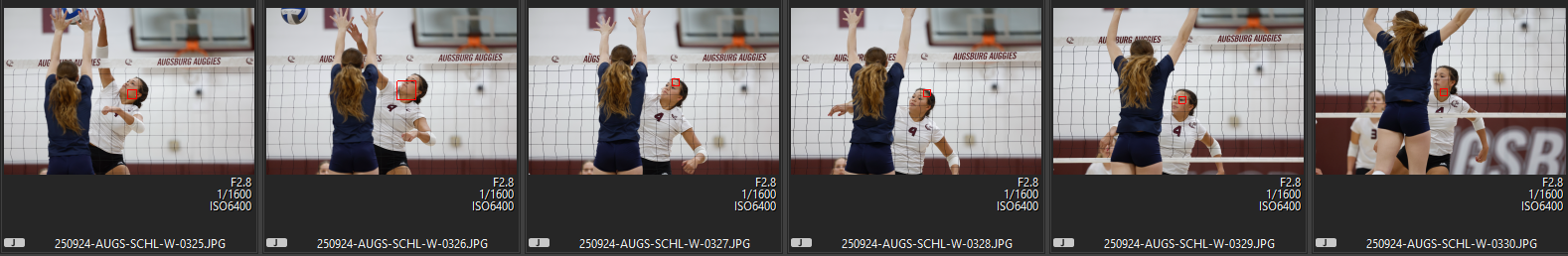

Camera on floorr example.

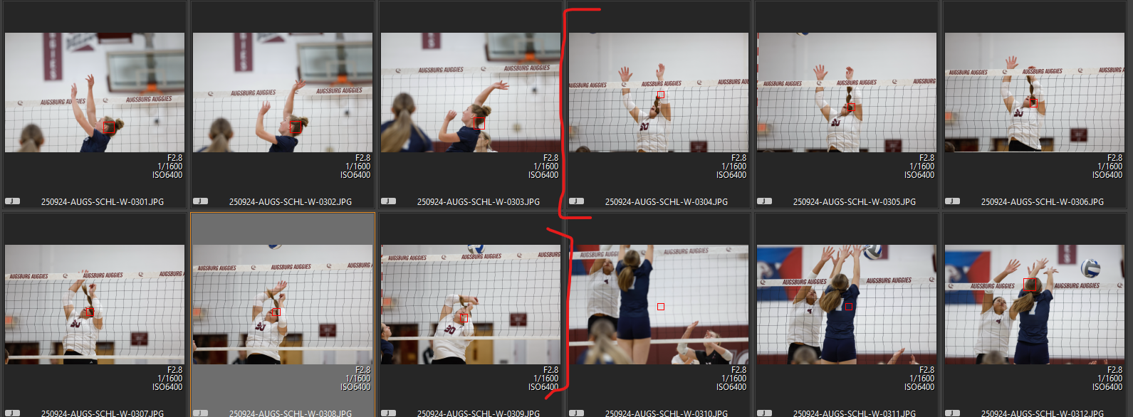

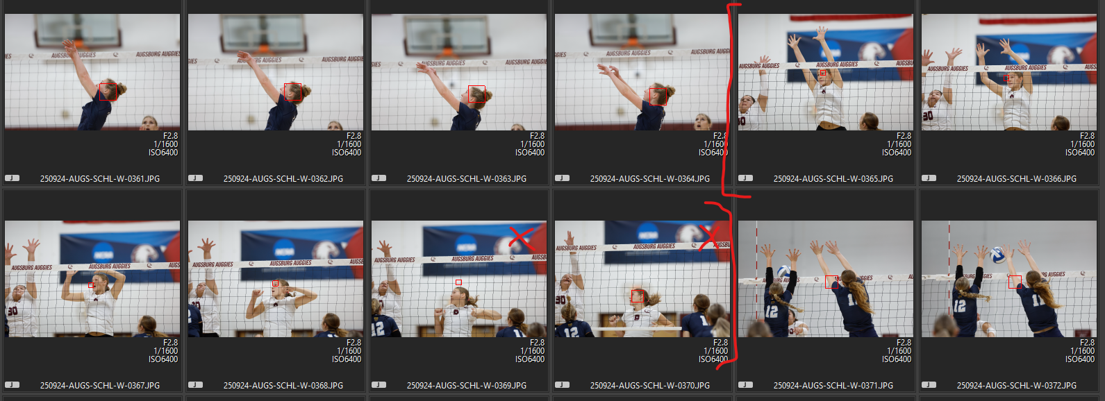

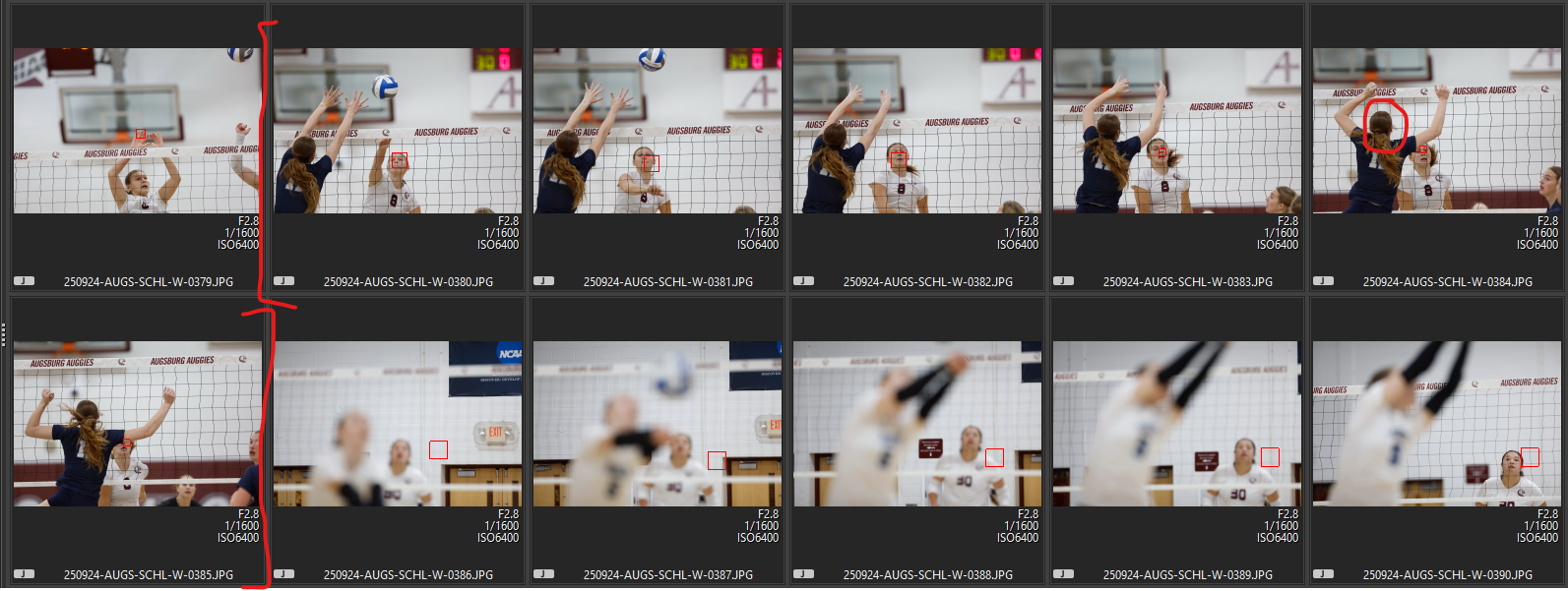

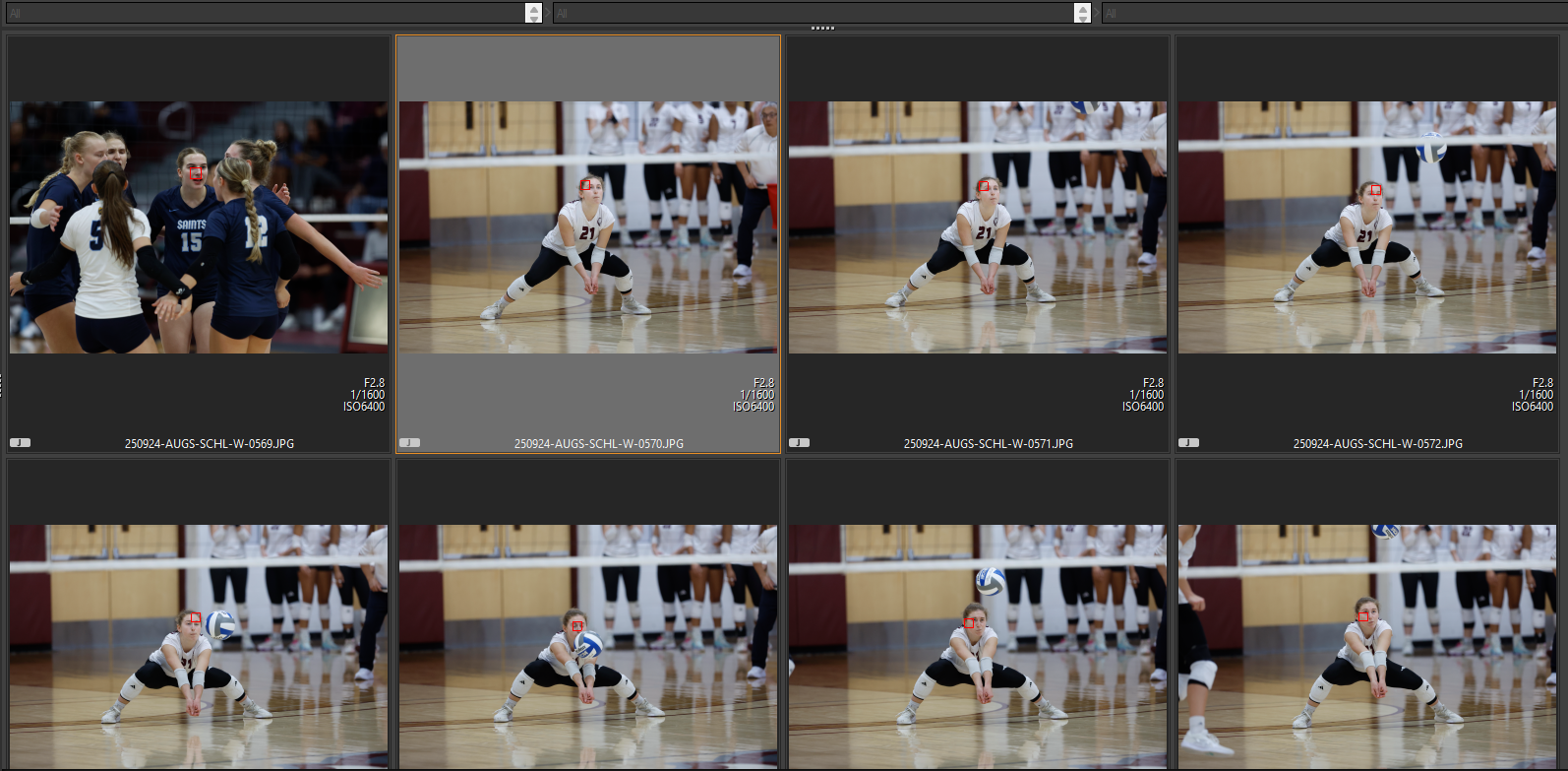

Yes, that was very badly worded. What I meant was that it the selection point will keep up to the person (either head or eye) without selecting the net as the selection point in Area AF. The examples I share below show the selection point following the player's head (for the most part), but the plane of focus on some of these series is in line with the net.
(Note that I have shared these images on FM previously.)
