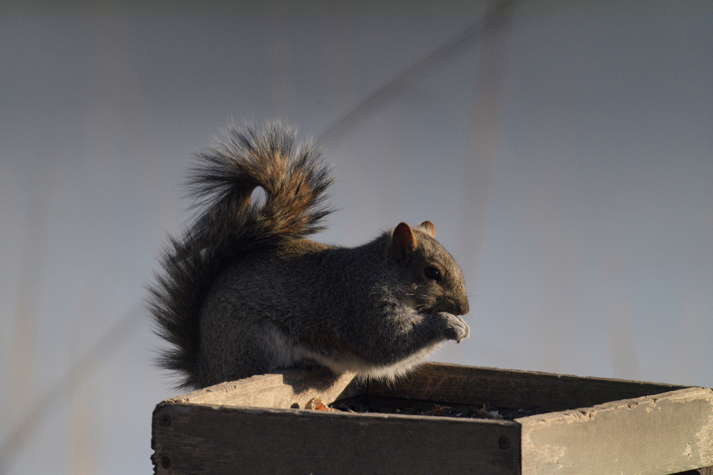

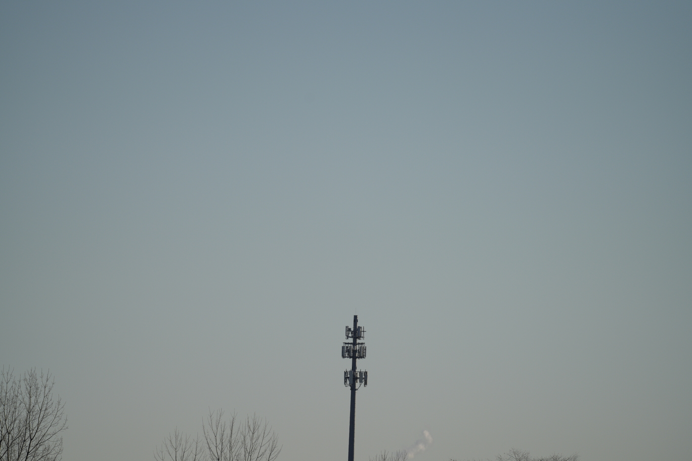

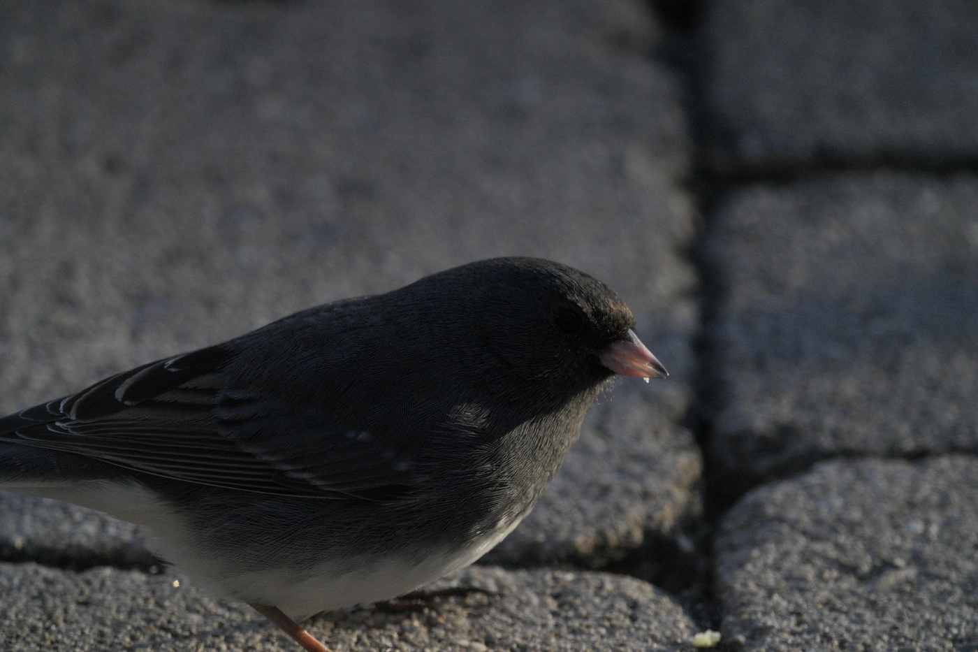

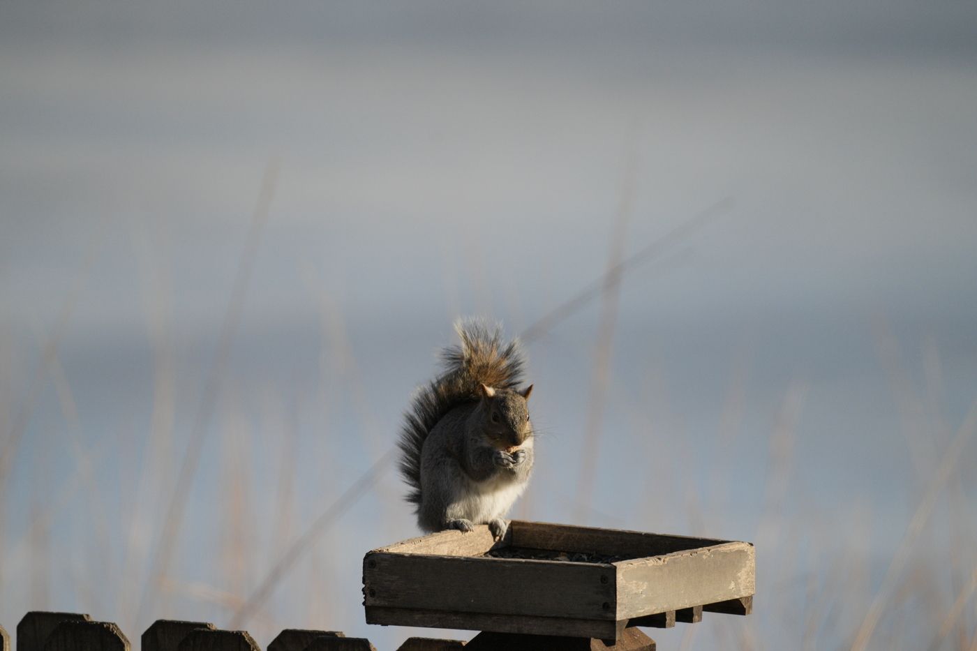

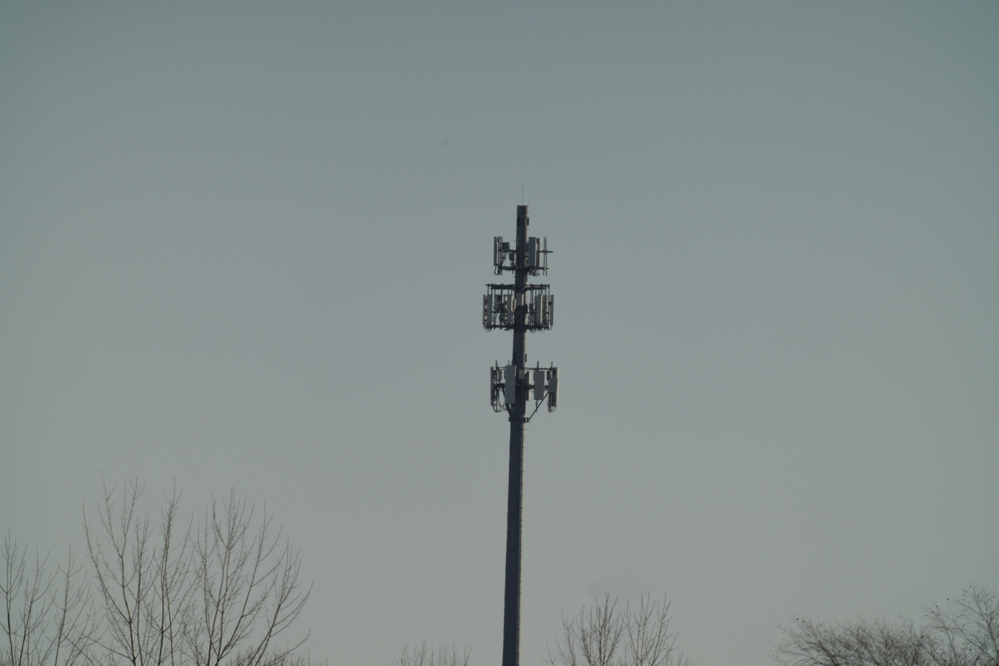

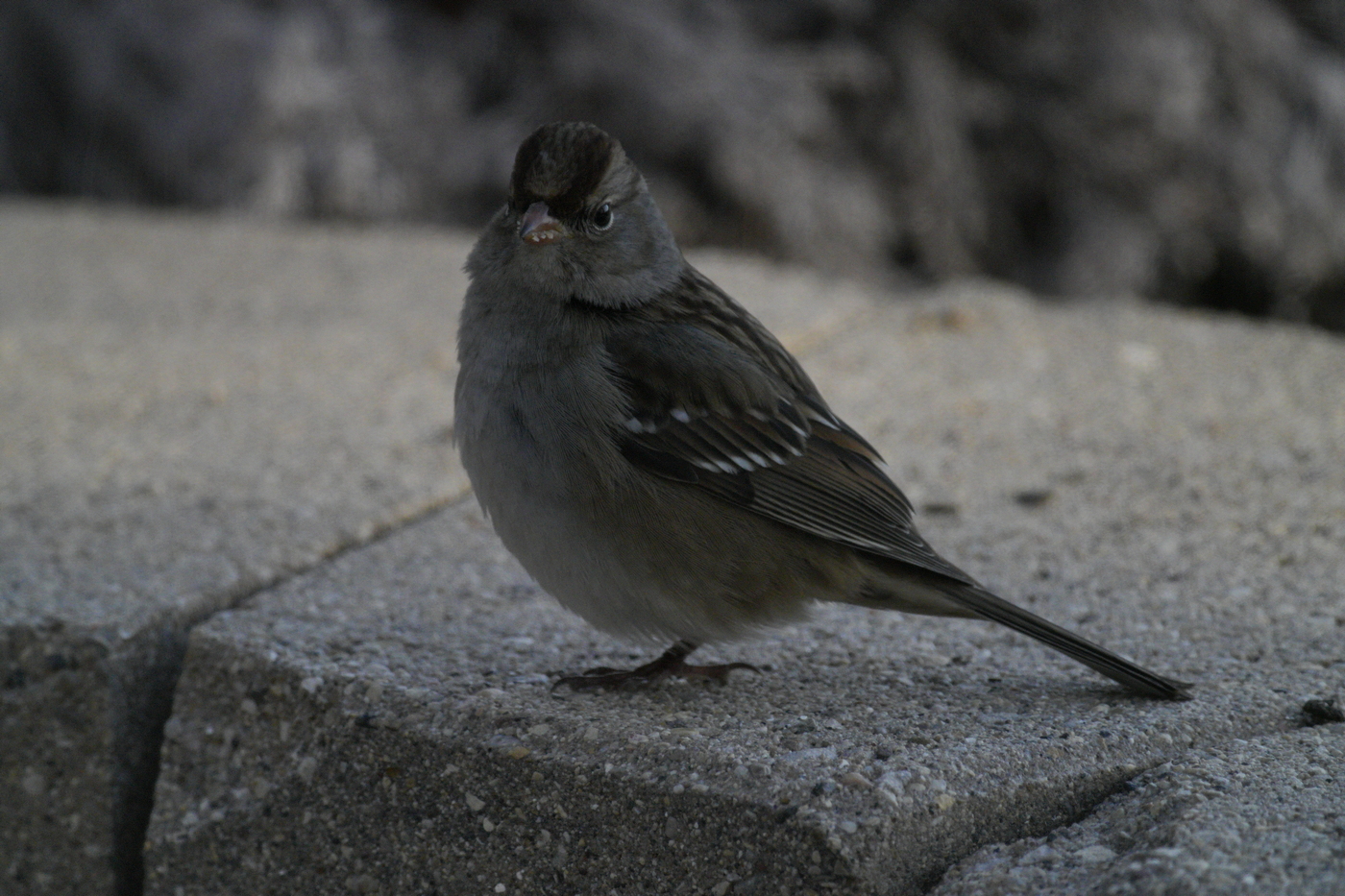

Handheld, chickadee at MFD, squirrel at 40ft, tower at 1/2 mile, clear day with light haze, SOOC jpgs and resized for upload, A7R5 with Sigma 500mm O24
with TC
  ILCE-7RM5    500mm F5.6 DG DN OS | Sports 024 lens    65535 lens    500mm    f/5.6    1/5000s    3200 ISO    0.0 EV
without TC
  ILCE-7RM5    500mm F5.6 DG DN OS | Sports 024 lens    65535 lens    500mm    f/6.3    1/5000s    1250 ISO    0.0 EV
with TC
  ILCE-7RM5    500mm F5.6 DG DN OS | Sports 024 lens    65535 lens    500mm    f/6.3    1/2000s    640 ISO    0.0 EV
without TC
  ILCE-7RM5    500mm F5.6 DG DN OS | Sports 024 lens    65535 lens    500mm    f/5.6    1/2000s    160 ISO    0.0 EV
with TC
  ILCE-7RM5    500mm F5.6 DG DN OS | Sports 024 lens    65535 lens    500mm    f/5.6    1/2000s    3200 ISO    +2.0 EV
with TC
Dec 21, 2025 at 11:06 AM

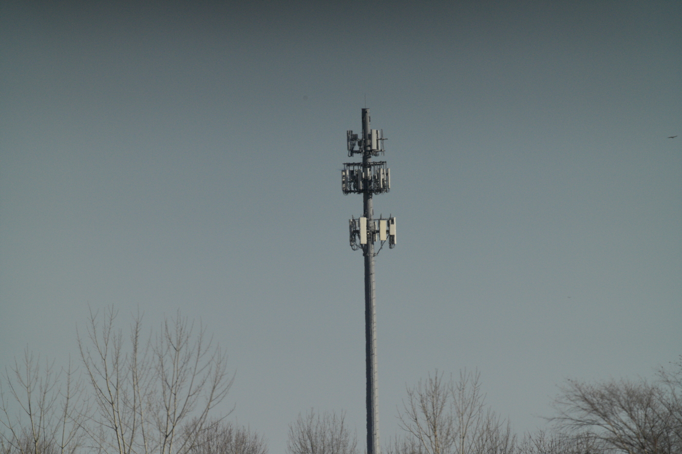

p.3 #6Upcoming Viltrox 2x E-mount Teleconverter

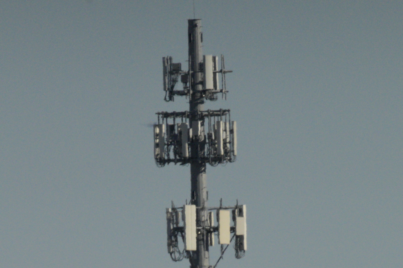

same tower with more direct light..no exposure compensation
with TC
  ILCE-7RM5    500mm F5.6 DG DN OS | Sports 024 lens    65535 lens    500mm    f/6.3    1/5000s    1600 ISO    0.0 EV
100% crop
Dec 21, 2025 at 12:34 PM
shac
Details
p.3 #7Upcoming Viltrox 2x E-mount Teleconverter
Thanks for showing the results. However, looks like atmospheric haze on the tower shots - yes?
Edited on Dec 21, 2025 at 01:41 PM · View previous versions
Dec 21, 2025 at 01:04 PM
brucehenderson
Details
p.3 #8Upcoming Viltrox 2x E-mount Teleconverter
Thanks for sharing the photos...can't wait to try this combination!
Dec 21, 2025 at 01:38 PM
Bradford
Details
p.3 #9Upcoming Viltrox 2x E-mount Teleconverter
Yes, definitely...by Chicago standards it is a clear sunny day but haze over the pond in front of the tower is present. Also possible mist on the UV filter from going outside in the cold and not waiting to acclimate....not to mention motion blur from shivering!
Dec 21, 2025 at 02:00 PM

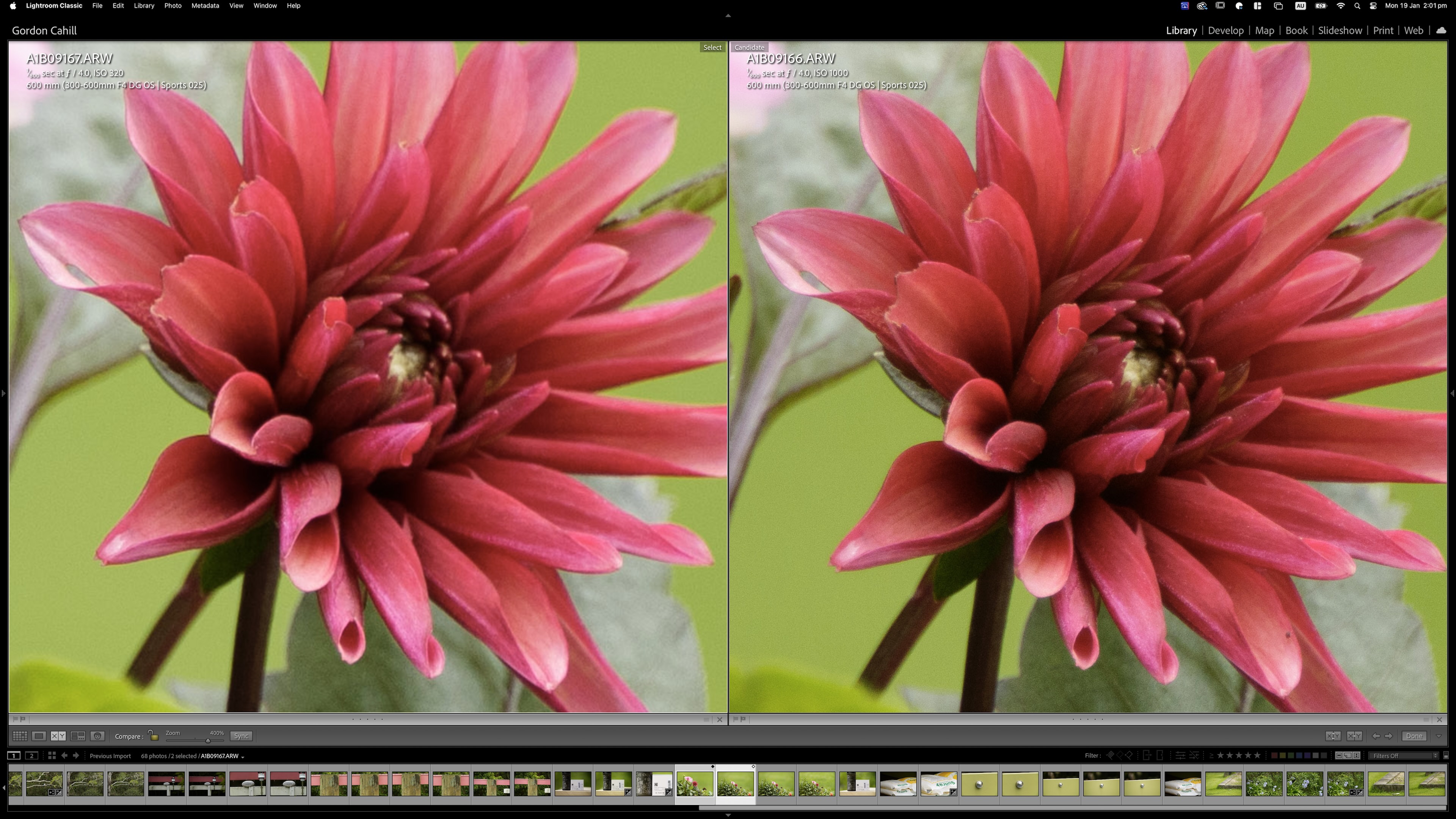

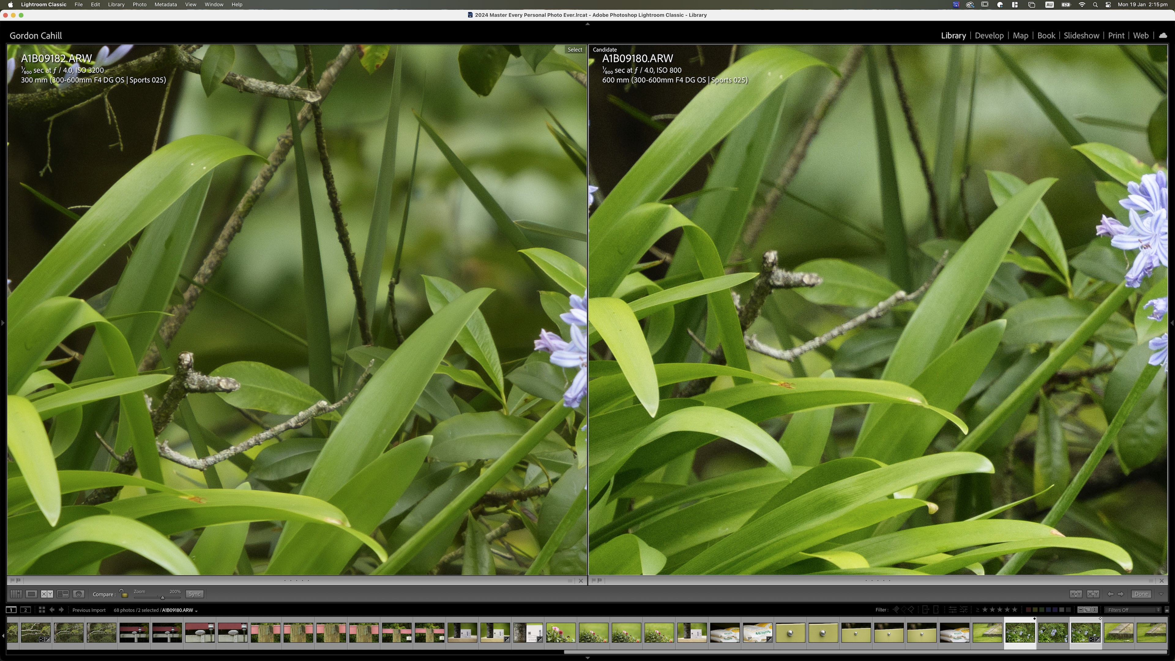

I am testing the Viltrox 2x on the Sigma 300-600 f4 mounted to an A1ii body.
So far so good. I have only received the tc today so it's early days. I'm using a gimbal for testing and playing with still subjects. I have been using manual with auto ISO and exposures are basically equivalent with no intervention. With manual ISO you need to add two stops.
Focusing is great. Super snappy and subject detect still works well. It's not quite at the same speed as the native lens but very close.
There is definitely more detail with the 2x than there is cropping from 600mm. See an example below with the lens at 600mm on the left at 400% and with the tc on the right at 200%. EXIF is not recorded correctly (which is why I guess it works) so look at the higher ISO for the TC shot. I am also testing what the difference is between 600mm and no TC and zoomed to 300mm with the TC. Here the native lens does pull ahead at the same magnification detail wise. In the below example focus point is slightly different so please take that into account. The shot with the TC also has a bit more DoF.
At distance and in lower light the additional environmental conditions seem to negate any advantages of the TC. So far it looks like at short/mid distances (say up to 20 meters) and smaller subjects. So useful but not game changing.
Images have been downsized due to website file size limitations. Unfortunately, that's hiding the differences I can see.
I'd kill for a 1.4.
Gordon
Native left at 400%. With TC right at 200%.
300mm w’ TC left. 600mm no TC right. Same magnification. Same lens
Edited on Jan 20, 2026 at 03:47 PM · View previous versions
Jan 18, 2026 at 09:31 PM
