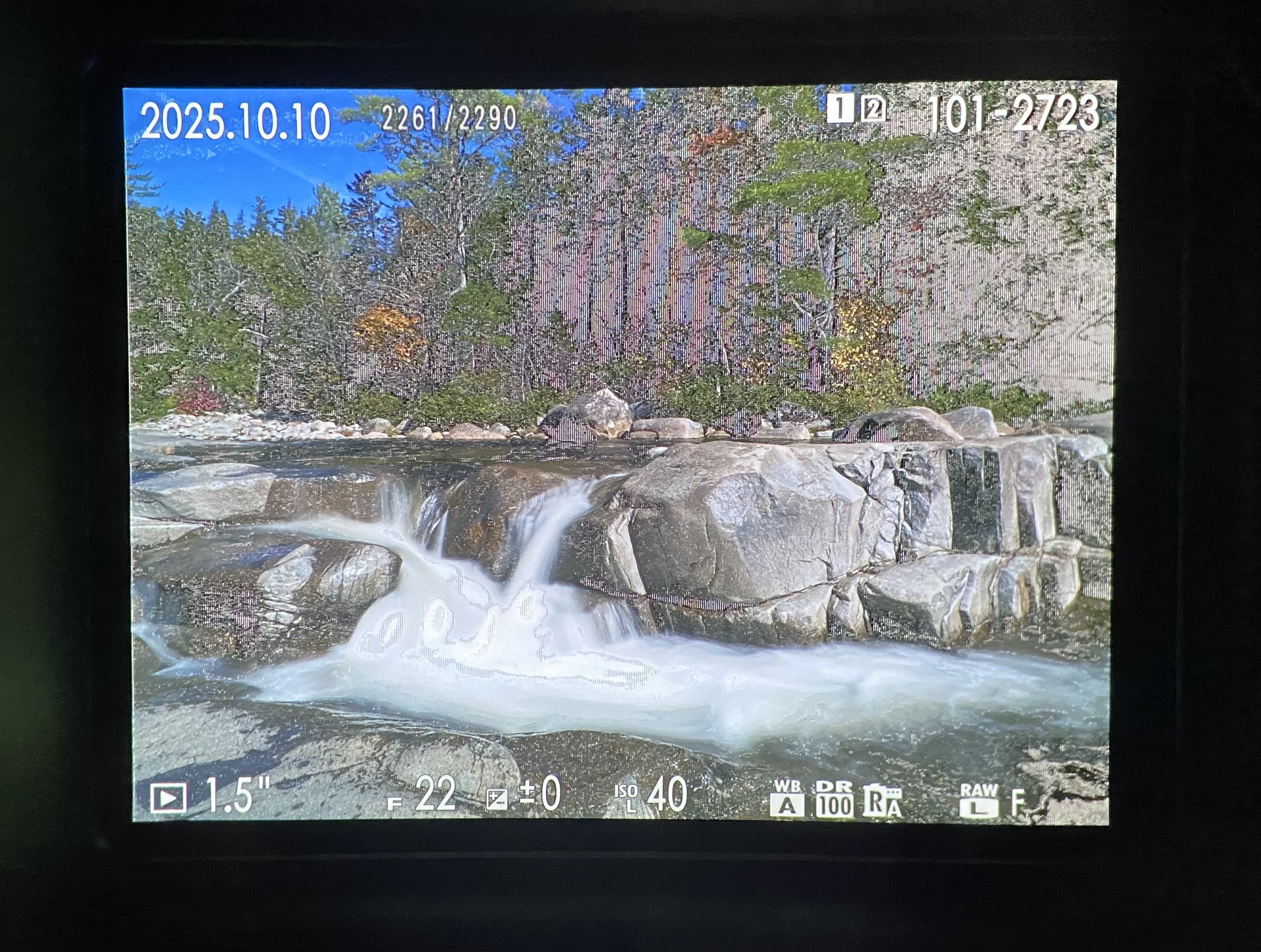

The EVF of my GFX 100 II suddenly began to show streaks in the shadow and highlight. It began to act yesterday then went away, but came back again today. Tried cleaning the contacts, resetting the camera, updating firmware, changing settings, but nothing seems to help. The LCD display is normal.
Any tips on what could have gone wrong? I am afraid that I will have to send it in.

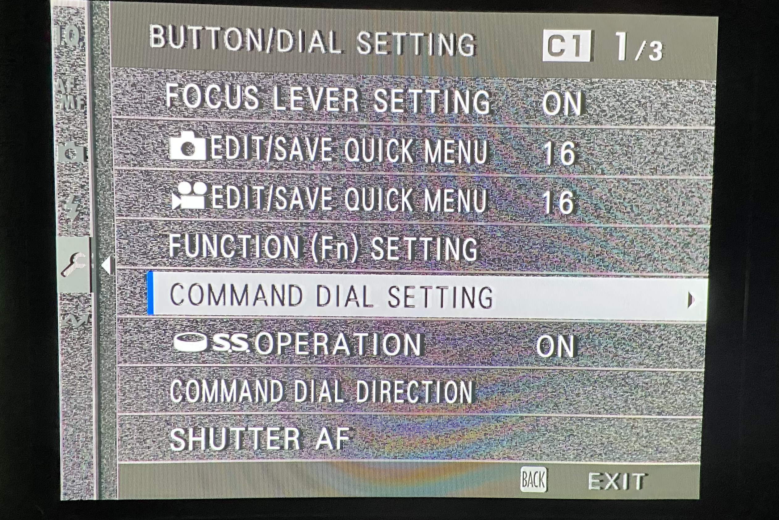

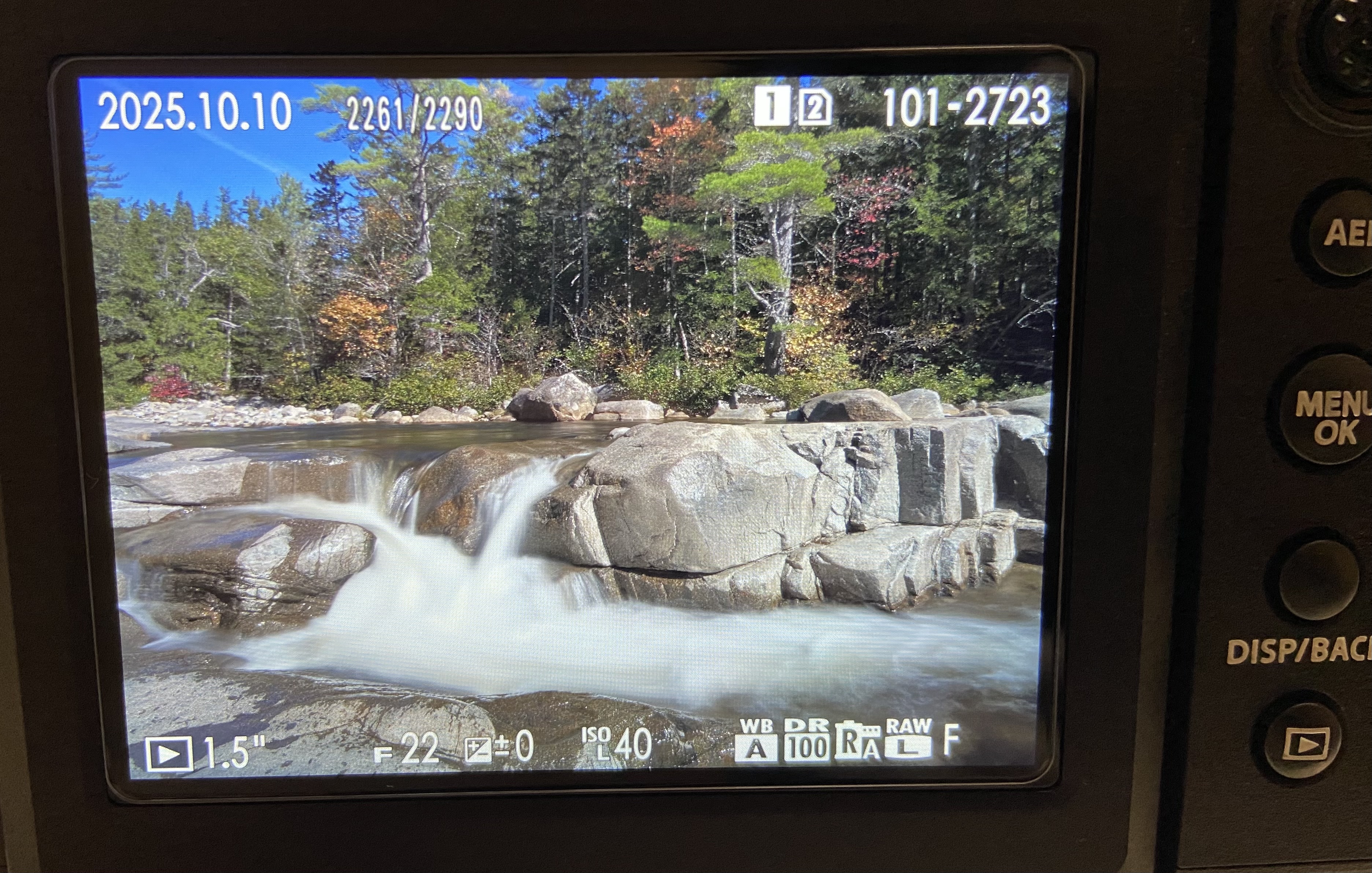

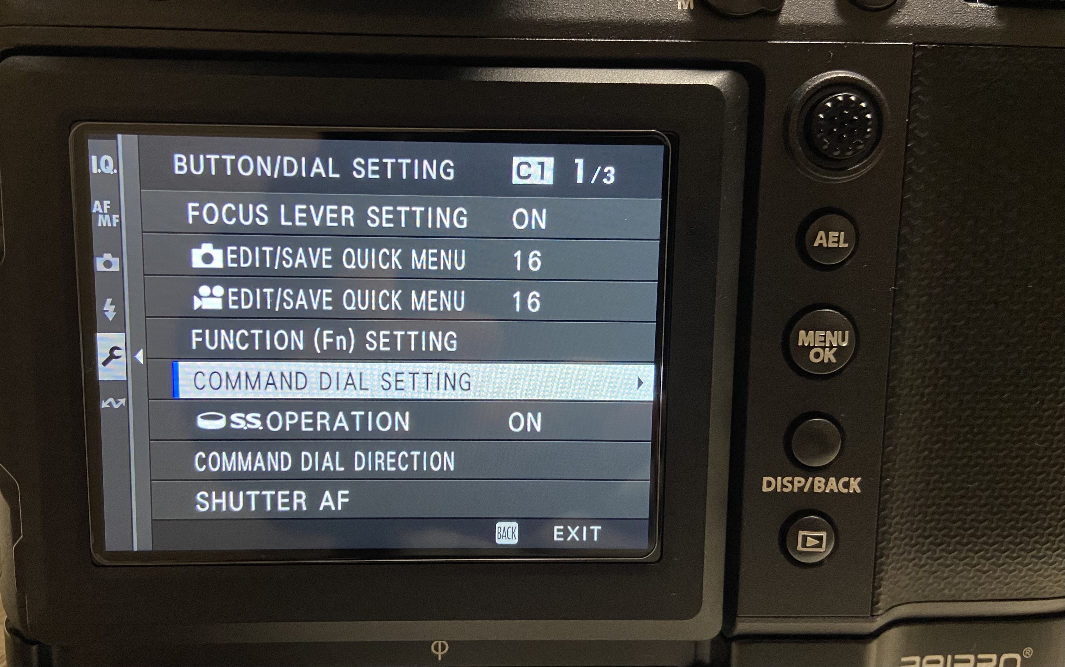

Here are some photos comparing the EVF view vs LCD.

EVF image review
LCD image review
EVF menu view
LCD menu view

I have pretty much tried changing everything that I could find on the menu, and it doesn't make any difference. It looks like any pixels that are below or above certain brightness are clipped, and stuff around the mid tone looks perfectly fine. The LCD however is totally normal.
