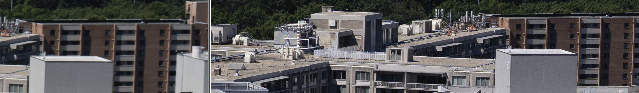

Just got a 20-70 and am taking some test shots at 35mm to compare with my 35 GM, and I'm noticing a fair amount of sharpness lacking with the zoom at 100%. See examples. Wondering how much is this expected vs. potentially a copy issue with the lens? In the center, both lenses are comparable sharpness but the GM of course has more microcontrast. But my concern is at other areas of the frame.

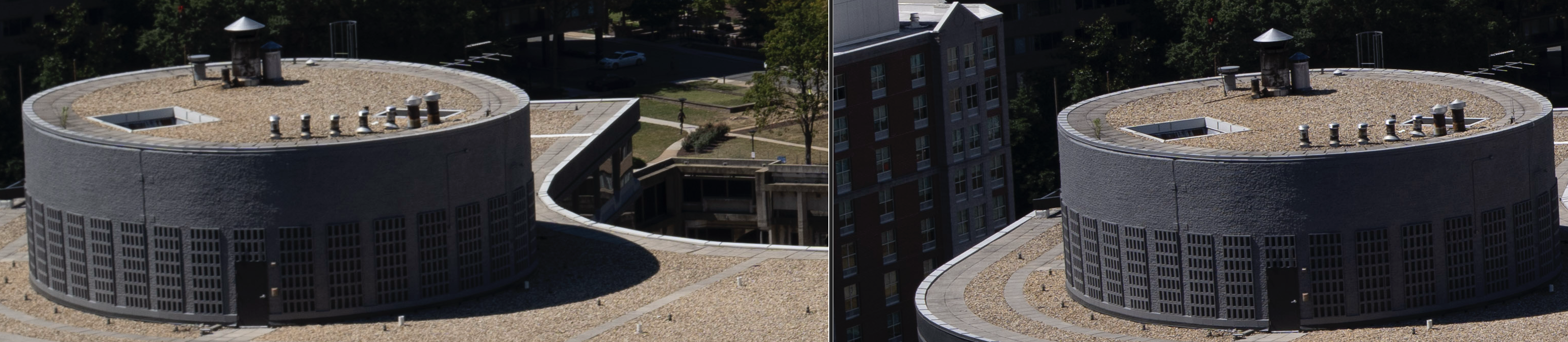

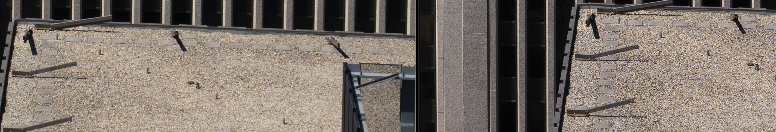

These are shot at f8 focused on the same point with both lenses. 20-70 G on left, 35 GM on right. These are 100% crops.
Mid-frame towards left edge
Center mid-frame towards bottom edge
Mid-frame towards right edge
