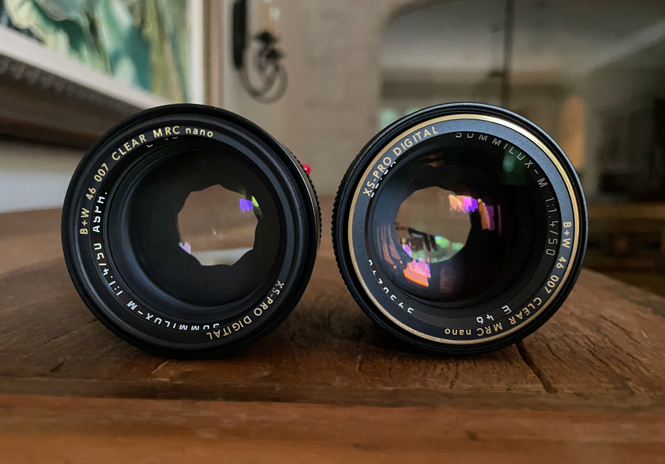

Here's a side-by-side of the Leica 50mm f/1.4 Lux ASPH. and the 50mm f/1.4 Lux pre-ASPH. showing their aperture blade shapes. You can clearly see the kind of highlight shape the ASPH produces. I'm not sure why Leica switched from the pre-ASPH. design, which gave more rounded highlights when stopped down.
ASPH. (LEFT), pre-ASPH. (RIGHT)
  iPhone 12 mini    iPhone 12 mini back dual wide camera 4.2mm f/1.6 lens    4mm    f/1.6    1/25s    800 ISO    0.0 EV
Aug 17, 2025 at 09:34 AM
my understanding is that the ninja star apertures actually reduces the amount of focus shift that occurs stopping down.
Aug 17, 2025 at 02:56 PM
Admin
p.1 #17 · Leica 50mm Summilux close focus vs previous version.
A ninja star aperture doesn't reduce focus shift. Focus shift comes from SA, where marginal and central rays focus differently as you stop down. The aperture shape only changes bokeh and highlight shapes. What matters for focus shift is the lens design and how well aberrations are corrected.
Aug 17, 2025 at 03:01 PM
