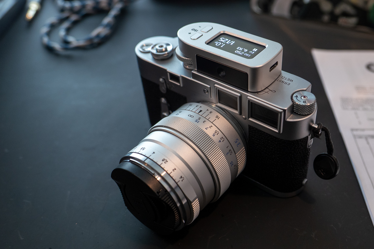

Pre-ordered some time ago, the KEKS M-Meter for meterless Leica M bodies arrived today. Looks just like the old M-Meters but this is rechargeable and gives digital readout. Adjusting shutter speed feels smooth. Display is wonderful (brightness can be adjusted)! We will see how accurate the meter is but I've had other KEKS light meters and they work great.

Does this meter align with the groove made for the original Leica M3 meter on the exposure dial? Meaning when you rotate the dial, does the exposure change directly on the new Keks meter? Or does the new meter just sit on top of the dial but is not connected to it?

That's exactly how it works! Just like the Leica R/MR meter. The rotating knob fits right in the groove. Movement is very good on my copy. The shutter speed on the display is calibrated to the shutter speed on the M3 dial. If not, there is a way to calibrate the shutter speed to match the dial.

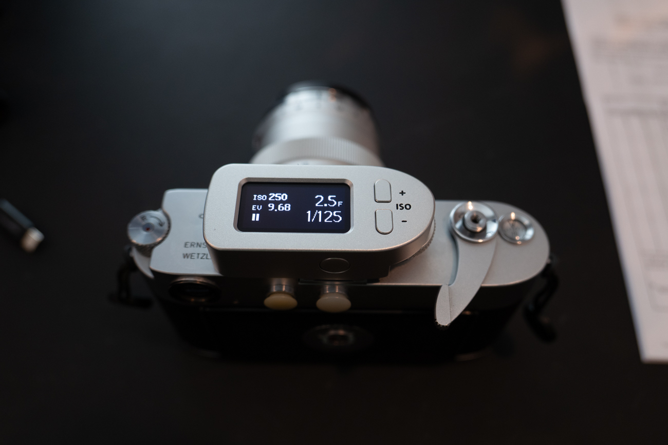

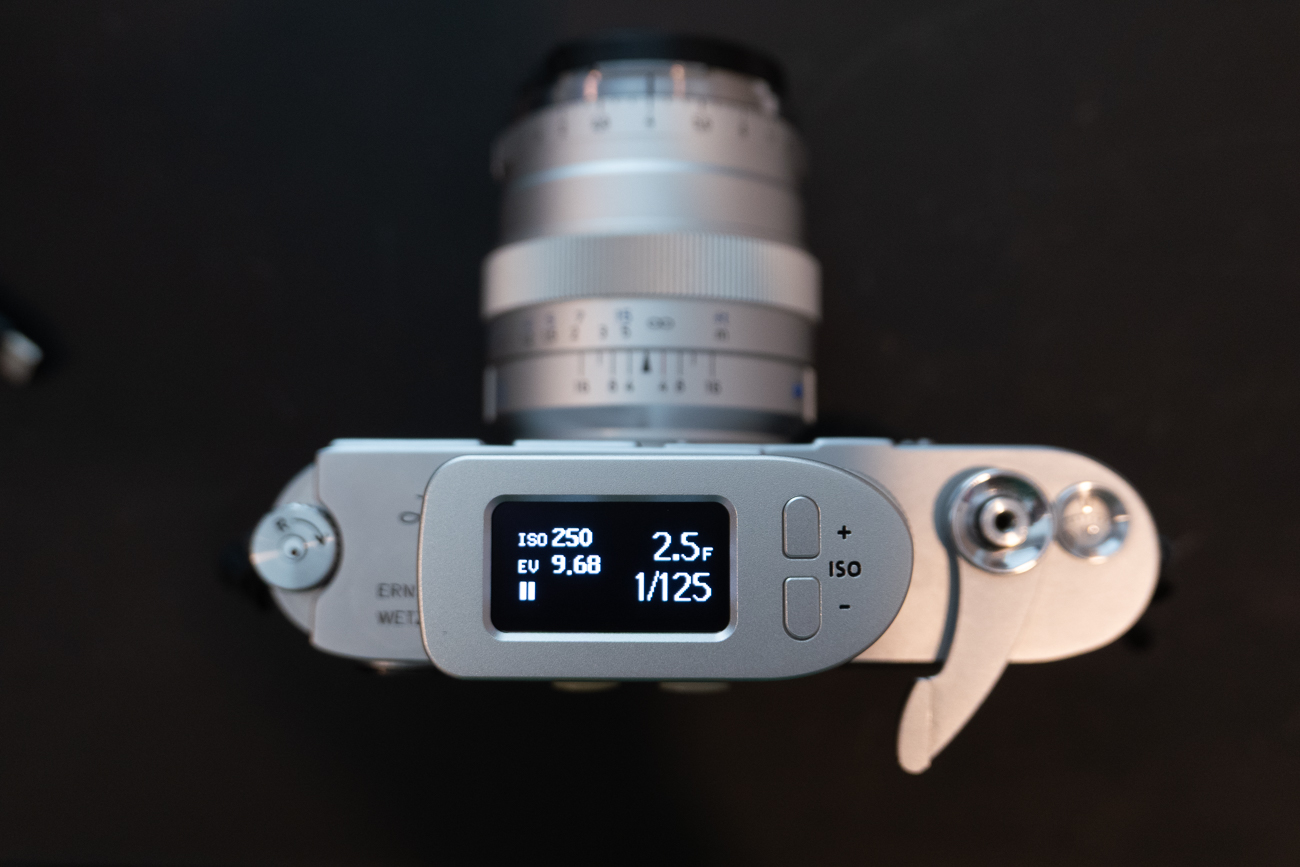

I just received my Keks meter for Leica M - decided to give it a try. I ordered the chrome version because I will predominantly use it on my M3, too. So far I really like it - the OLED display is very clear. Nice that it comes with USB-C charging option - it arrives uncharged, full charging takes about an hour. A bit tricky to attach the meter to the correct position - both meter and camera reel need to be set to B positions as shown in the manual. It took me three attempts to make the meter's center pin and the small ridge fitting into the corresponding slots on the camera reel. But after it was aligned, it works all perfectly.
I also had to calibrate for the correct exposure stops aligning the camera's reel with the meter dial. Two steps on the meter were not needed with my M3 DS based reel - for 1/15 (set to jump directly to 1/30 from 1/8) and for 1/60 (set to jump directly to 1/125 from 1/50). Will test it with film, too but I don't think there is an issue getting great photos using this meter.
Leica M3 DS exposure stops: B - 1 - 1/2 - 1/5 - 1/10 - 1/25 - 1/50 - 1/100 -1/250 - 1/500 - 1/1000
Keks Meter exposure stops after calibration: B - 1 - 1/2 - 1/4 - 1/8 - 1/30 - 1/50 - 1/125 - 1/250 - 1/500 - 1/1000
One little thing to mention: After calibration, when the meter is turned to the exposure which was adjusted/calibrated, it will still quickly show on the display the interval which is now ignored before displaying the correct calibrated value. In my example when I move to 1/30 sec, it will briefly display 1/15 sec even it is excluded by calibration.
