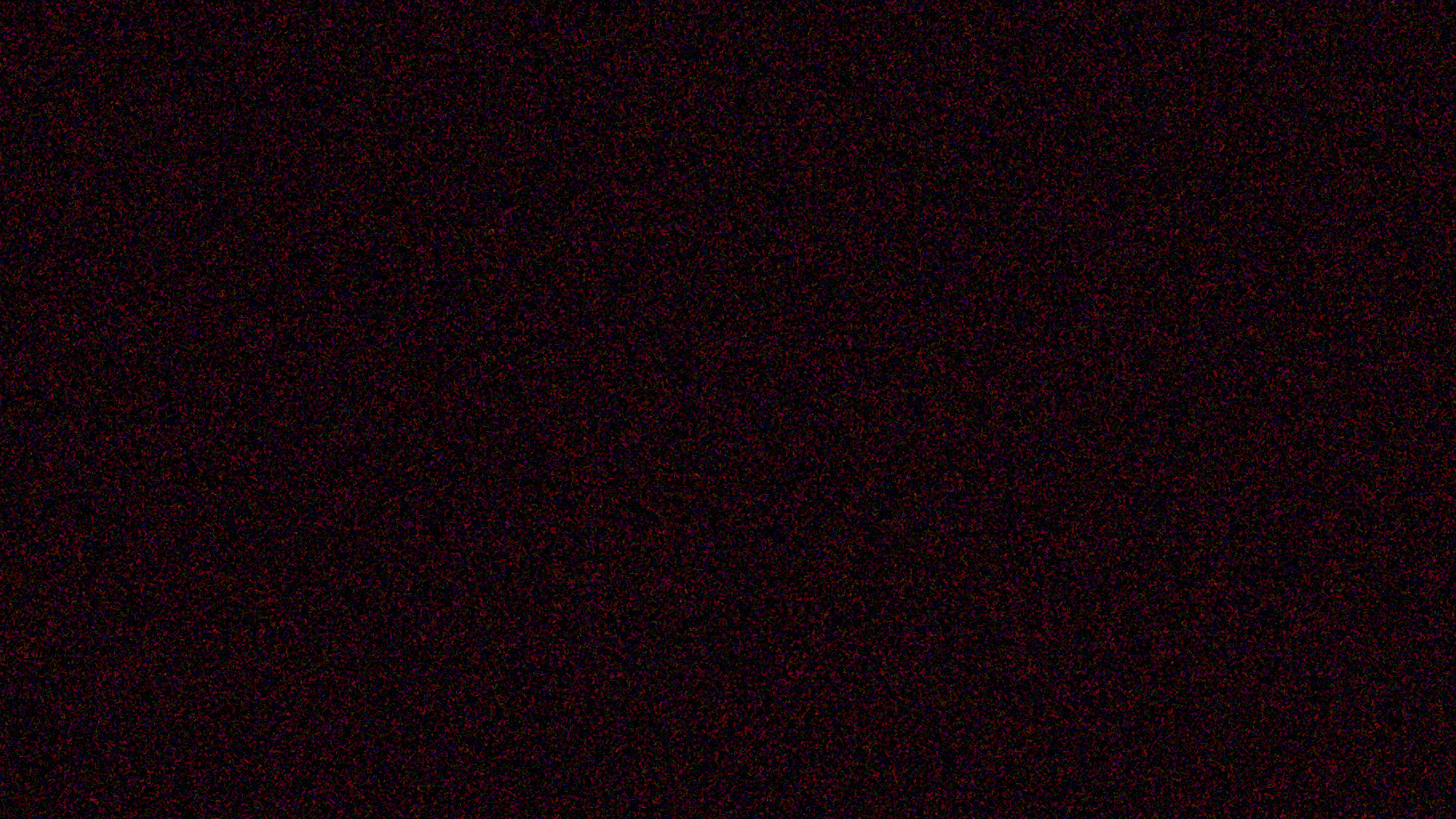

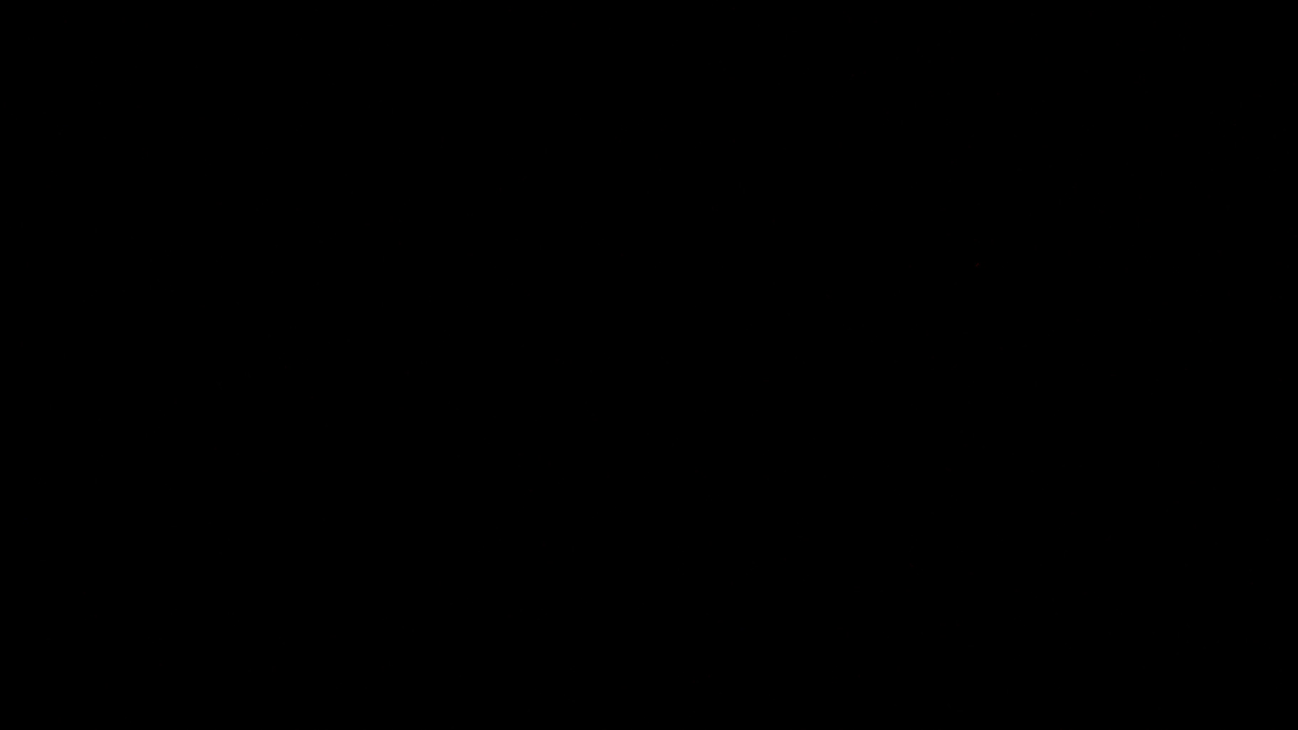

Here is an example of what happens on G9II when the SS becomes 1s.
I took two black frames without a lens, at ISO 100. One with SS 1/2s and the other with SS 1s.
The raw files were opened in DxO PL8 without any corrections except the exposure was lifted by 4 stops.
The following are central 1823 x 1026 crops from the images.
I think it is pretty obvious that one may want to keep the Min. Shutter speed setting at 1/2s.
  DC-G9M2    24mm    f/0.0    1s    100 ISO    0.0 EV
  DC-G9M2    24mm    f/0.0    1/2s    100 ISO    0.0 EV

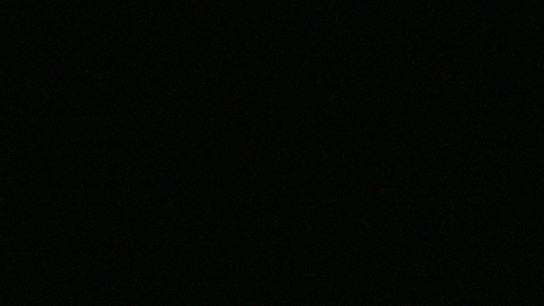

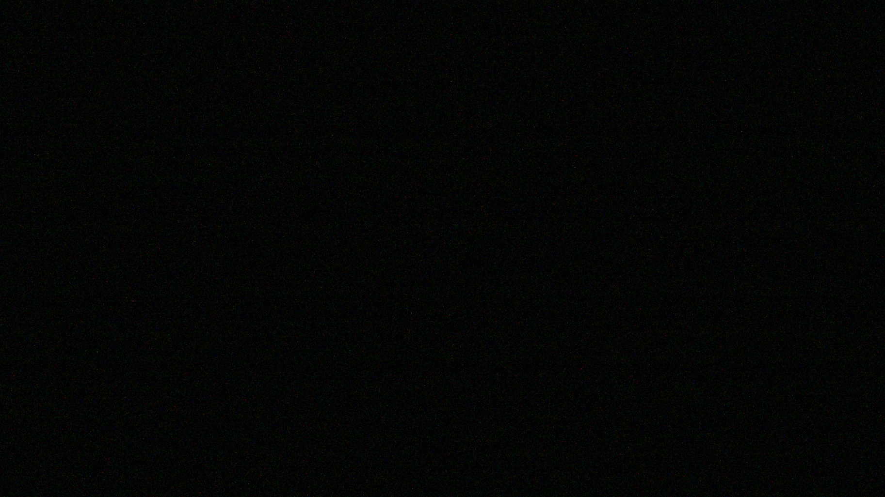

For comparison, these are crops of the same size as above and processed as above, taken with OM-1 II with SS 1s and 1/2s at ISO200 (base ISO).
I see more noise from OM-1 II vs G9 II when the SS is 1/2s. The dynamic range of G9 II is better at ISO 100 when the dual output gain is working. When it does not, when SS is 1s, then OM-1 II has a better dynamic range, even if the ISO is higher.
The practical point is that one can comfortably use OM-1 II with SS as long as 2-3s hand-held (the camera has an excellent IBIS) in low light. I wouldn't use G9II with SS longer than 1/2s.
  OM-1MarkII     0mm    f/0.0    1s    200 ISO    0.0 EV
  OM-1MarkII     0mm    f/0.0    1/2s    200 ISO    0.0 EV
