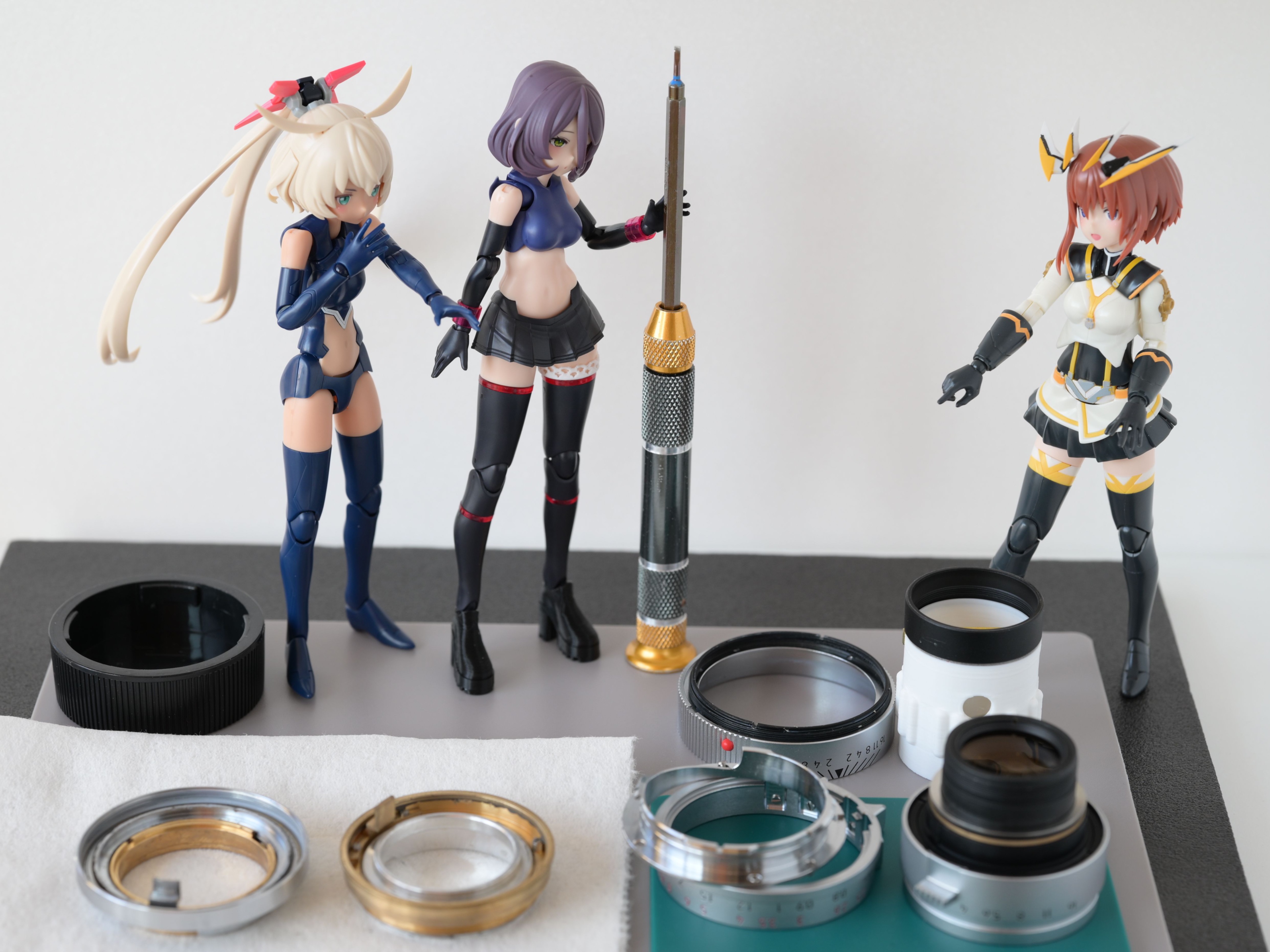

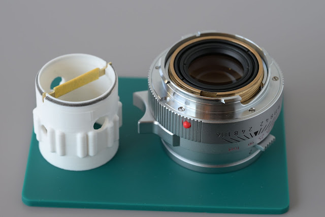

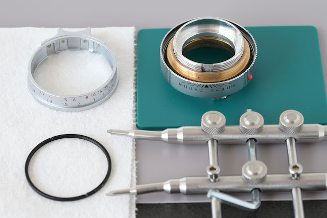

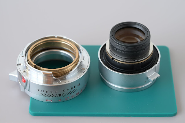

The Light Lens Lab 50mm f/2 Elcan stands out for its compact size, solid build, and classic rendering. Originally introduced as a modern recreation of a rare military Leica lens, it delivers excellent image quality that is comparable in sharpness and character to the Leica 50mm f/2 Rigid. One noticeable difference is its lower optical vignetting, which results in more rounded specular highlights near the edges and less of the swirling effect often seen in the Rigid. Overall, the two lenses share a very similar performance profile.
What makes the Elcan even more interesting is the challenge it presents during servicing. Despite being built with high-quality materials and careful construction, it is extremely difficult to take apart. Our friend Yuri recently opened one up to address focus play and described it as one of the most difficult disassemblies he has ever faced. The widespread use of glue during assembly significantly complicates the process.
Yuri's article offers a rare look inside this lens and is a must-read for anyone curious about its internal design or considering service work.
Read the full article:� �https://www.yukosteel.com/2025/06/disassembly-cla-light-lens-lab-50mm-f2.html

The thing is, the lens is built with mostly brass components and tight tolerances, so it's clearly made to a high standard. The main issue isn't the build quality, but rather the use of adhesive in places where it doesn't seem necessary. Hopefully, Light Lens Lab reconsiders this approach to make future lenses easier to service.

I'm not convinced that the glue is used to cut costs or reduce servicing needs. I could be wrong, and maybe @yukosteel, can clarify this, but after he dissolved all the adhesive, he was able to fully service the lens (clean the dust, regrease it, and fix the focus lag) without needing to apply any glue again. Everything was reassembled using the original screws and retention rings. After shooting with it yesterday, I noticed there is zero play, the focus is butter smooth, and to me it feels perfect. So I really don't see why Light Lens Lab needs to use glue at all, since the lens works beautifully without it.

Correct, the glue on these retention rings is simply to keep them from accidental unscrewing during normal use. Typically Leica/Voigthalner/Zeiss lenses also have a bit of glue on retention rings, though I'd say 95% less comparing to amount found in LLL and its a different type of glue, closer to Red Loctite.
I suppose its just part of manufacturing standard of LLL, to keep rings extra secured. What would perhaps reduce manufacturing cost a bit - is adding less glue.
The other LLL Elcan copy I purchased from FM recently has SN 245/998, and has similar glue amount. The minor focus lag is there as well, though not as prominent to urgently disassemble it,. When lens is mounted on M camera the lag is almost disappearing (due to pressure from RF roller), I can only feel it bothering on Nikon ZF camera, so will just keep using as is for now, love the compact size and comfortable focusing with longer throw.
