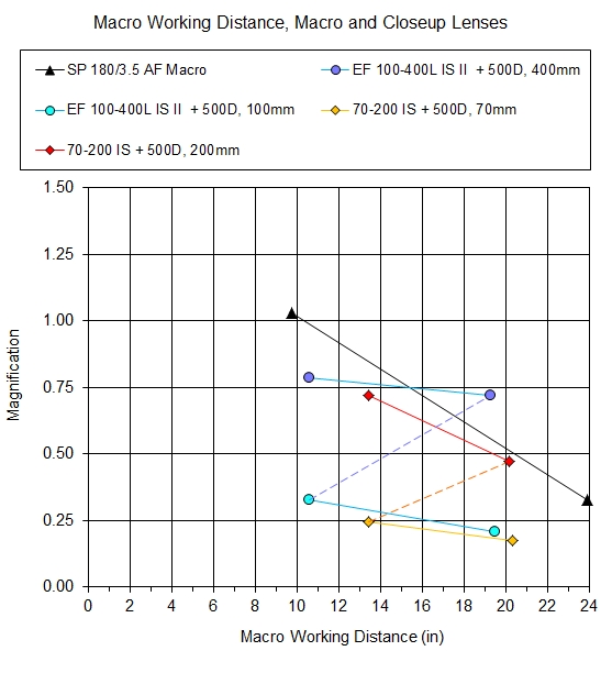

Have you considered usinig an auxiliary close-up lens? I use Canon 500D close-up lenses with my 70-200/2.8L IS II and 100-400L IS II; one is always in the bag. I also have extension tubes, but the loss of light, and fiddly-setup for tubes (compared to screwing on a filter), means that I always prefer using a close-up lens, if it gets high enough magnification. It easily gets magnifications to and past x0.5 [1:2] for my lenses, and it almost-certainly will for yours, too.
The Canon 500D and 250D (for shorter lenses), have two-element optics, that provide well-corrected and clean images. There are also many one-element close-up aux lenses (including a "Canon 500"), but they typically have lots of CA towards the edges (even the expensive ones).
© jcolwell 2004-2025
Figure 1: Comparison of Macro Working Distances, Tamron SP 180/3.5 Macro, and Canon zooms with 500D aux lens
