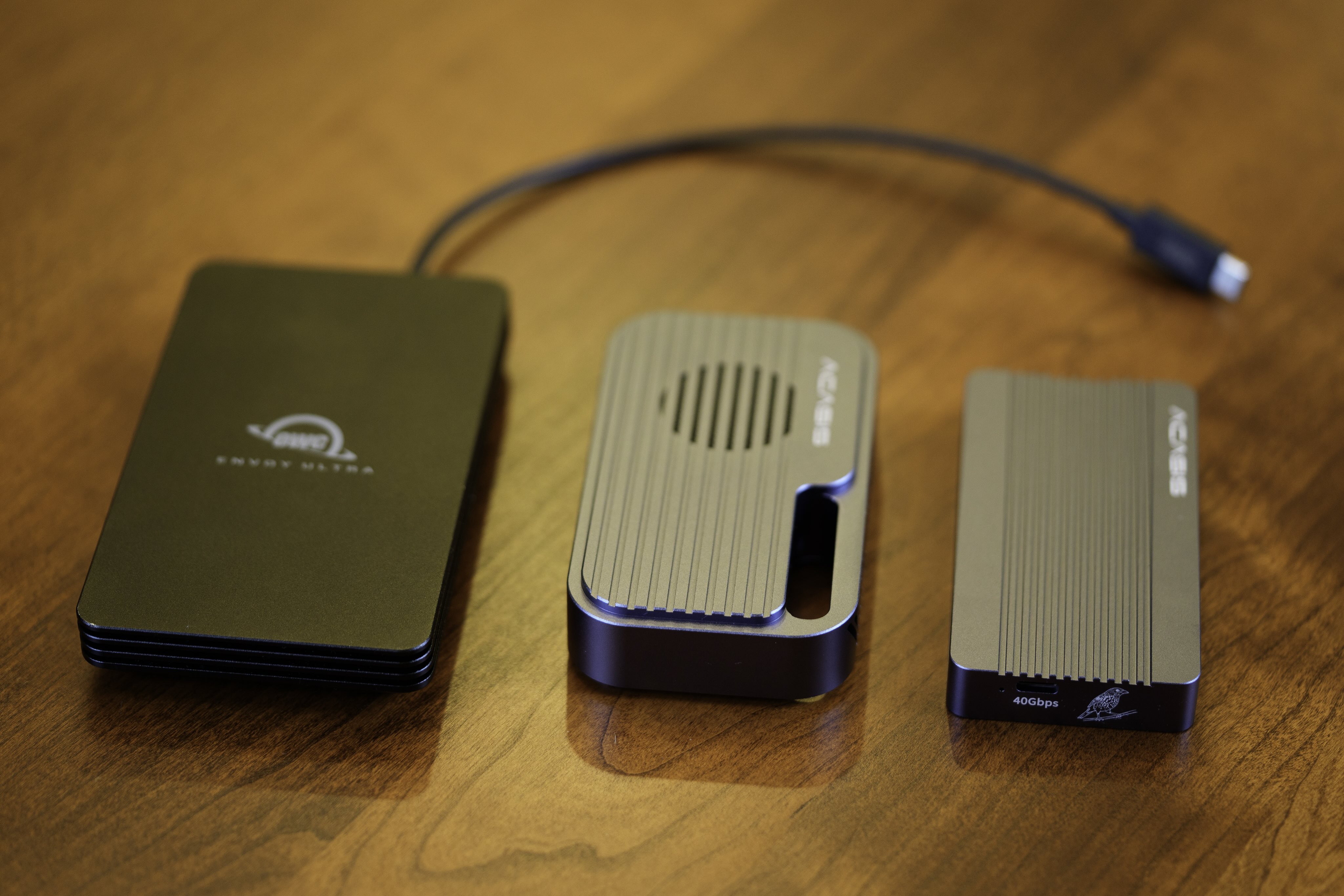

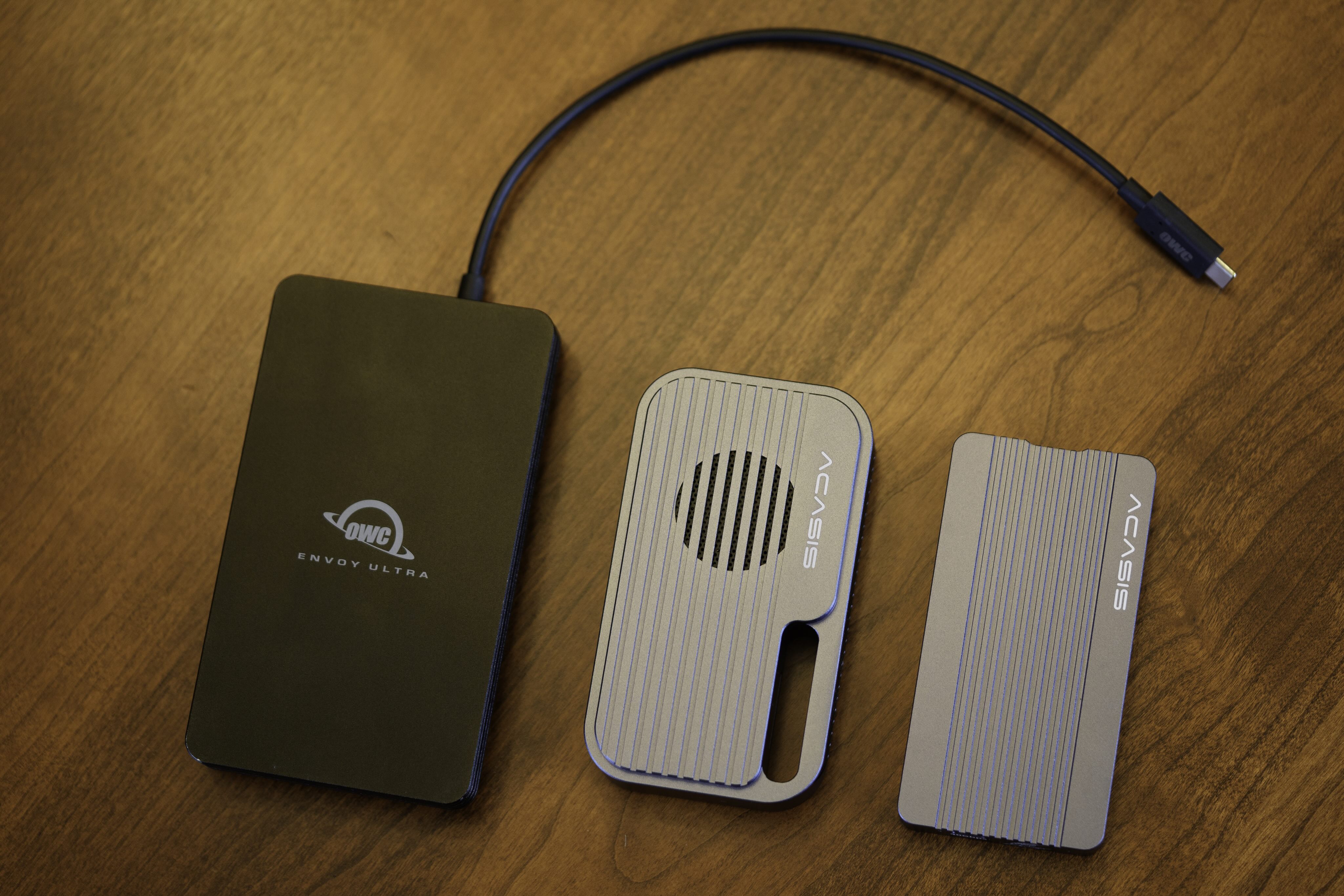

Overall: Both are great enclosures but because heat is a real issue the faster the drives run, they are both bigger than previous TB4/USB4 drives. Be prepared for the larger size and in the case of the Acasis enclosure, noise from a fan. You will get extreme speed from both and the overall performance difference between them is negligible. The OWC is weather-proof with a great seal, but also has a captive cord, which personally I find annoying. It seems to be they could have made it just a weatherproof without the captive cord, so I'm not entirely sure of their justification for this design choice. The price is basically a wash as the Acasis is quite expensive IMO; it has a slight edge in that you can use a pretty cheap NVMe drive if you want, but ultimately for the best performance you shouldn't be using one of the cheap drives anyway. The Acasis comes without a drive, and you there are no warranty issues (obviously) installing your own. I of course just opened up the OWC case and put my own drive in there. According to OWC they didn't make it with an 8TB drive due to thermals and voltage, but I've been using it with an 8TB Sabrent TLC NVMe drive for about a month with zero issues.
Size: Based on volume I'd guess both are similar in size; the Acasis is thicker to fit the fan in there, but shorter and narrower than the OWC. I can't really say I prefer either style. Honestly I think a passively-cooled version similar in design to the OWC Express 1M2 would be fine for a TB5 enclosure with enough thermal mass from the aluminum body and fins to dissipate the heat, but obviously that would need to be tested by the manufacturer. The attached cord mentioned above is a negative for the OWC drive for travel.

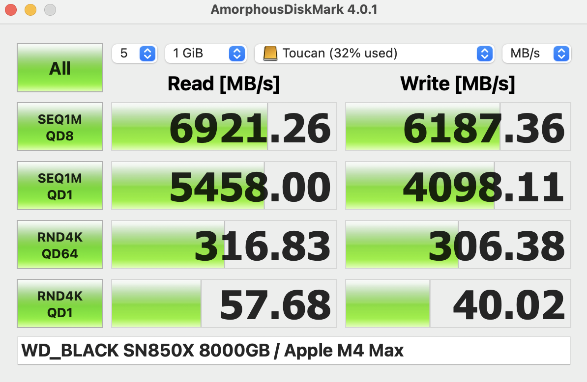

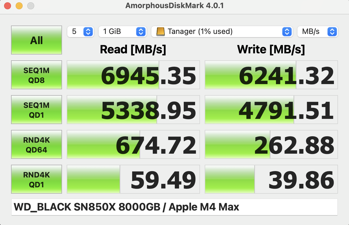

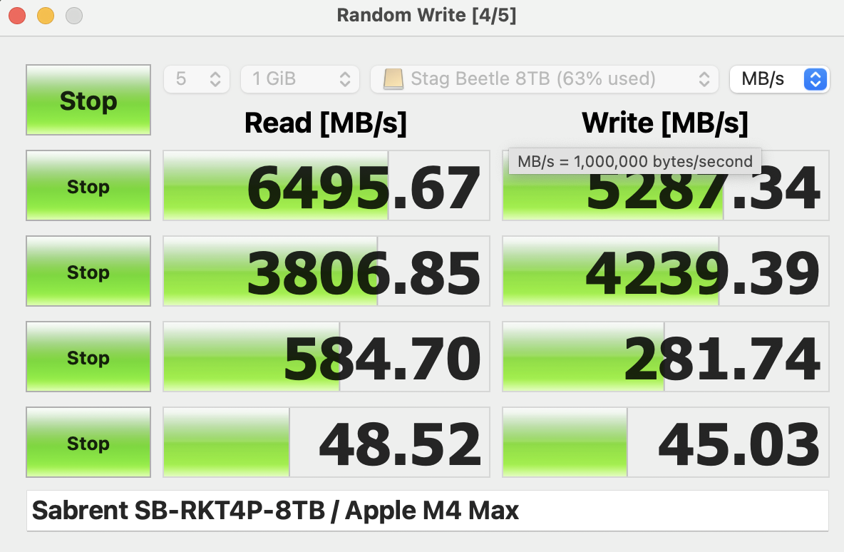

For performance tests I used the exact same WD 8TB Black SN850X TLC NAND NVMe drive; I also compared it to a Sabrent 8TB Rocket 4 Plus TLC NAND drive; both are PCIe 4.0 drives with theoretical maximum transfer rates near the limit of what TB5 can handle. The WD is slightly faster overall and does better a longer sustained transfers. It's also less expensive so overall it's the better choice.

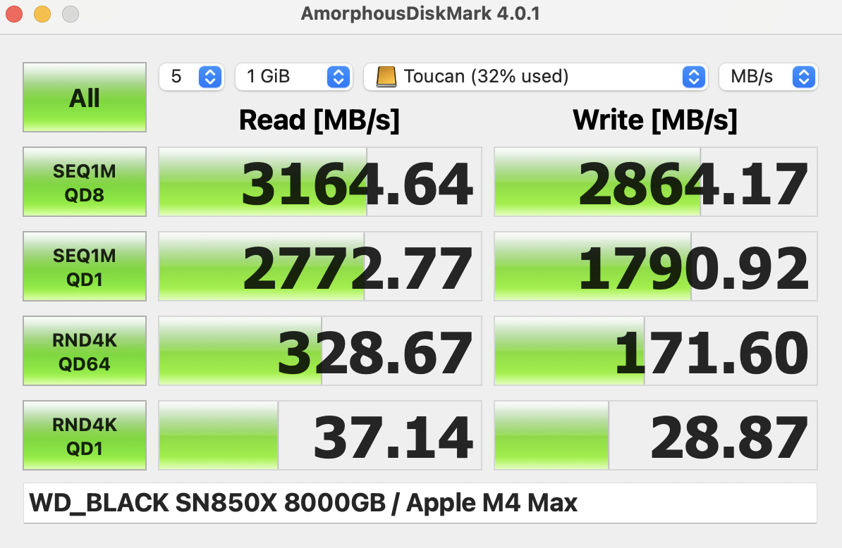

The bottom line: I personally have a pile of the older ACASIS 40Gbs enclosures that are much smaller. They get hotter due to the smaller thermal mass, and of course the top speed is limited. However, for most of what I am doing that speed is way more than enough. The same drives in those enclosures will hit around 3150/2900Mbs R/W on average. I run all of my Lightroom libraries directly from these drives. I don't see myself buying a lot of other 5TB enclosures right now because the trade-offs in size, price and or noise from a fan are really just not worth it for an increase in speed that has no functional benefit for me 99.99% of the time. But for those who really want that speed or need it (shooting lots of raw video for example) these would be a great choice. Sabrent announced one back in August but it's still not available. The original announcement showed a smaller fan-free design so if they release it in that form, that would probably be my default choice.
Acasis Enclosure with WD 850X
Acasis Enclosure with Sabrent Rocket 4
OWC Envoy Ultra with WD 850X
Older Acasis 40Gb/s Enclosure with WD 850X

I'm curious about the 4.6TB transfer; how long did it go at peak transfer speed before the cache filled? And once that happened, what was the sustained speed? Was it the WD drive?
I think the cache is very dependent on available space and have noticed my SN850Xs in the Acasis TB4 enclosure can drop out of the highest transfer rate relatively quickly. But my drives tend to be quite full most of the time.

Actually I hit send on that before I edited it. It was estimated at 15 minutes and was going along well and then stalled out. I was transferring between the Sabrent and the WD and the Sabrent has stalled out faster in the past. I'm going to do some more testing between two WD drives as well and report back. The cache is actually DRAM on the chip, and it's a great place for the drive manufacturer to save some money and power draw since a large DRAM cache isn't needed most of the time.
It took more like 25 minutes....which is still not bad for 4.6TB but not nearly as fast as it theoretically could be.
